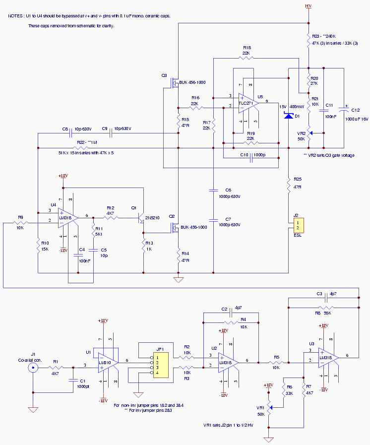

Have you seen this amp:
http://www.shackman.reromanus.net/V-Typ-WR.pdf
Direct coupling from 400HZ.
I'm building that.

Well , in theory , DirectDrive can be more dangerous that transformer.However , i think that having 1000V swing (and limited current) from a mid-power A class direct-drive amp is not so dangerous tran 10kV swing of output transformer , plus the fact that AB power amps can deliver lots of current to it... I have had a ~2kV shock across my arms from transformer once ... Not a good feeling 🙂
Output transformer's quality is limited to core material and winding quality , so direct drive can sound better , if realised well...

Tubes swing high , but these are high - voltage tubes , which are usually expensive and hard to get ... FETs rated at 1200V or similar and JBTs at 800-900Vceo are cheap and easy to get.

FETS also have a large and very non-linear input capacitance that needs to be driven by a very low impedance.

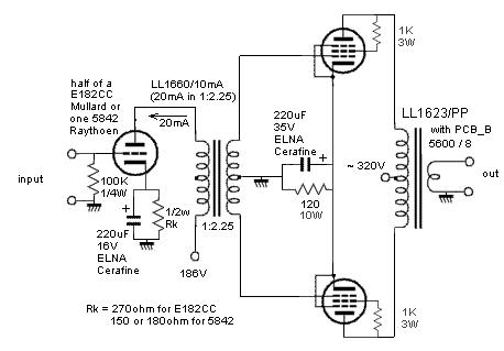

Anybody want to talk freely about using a higher resistance output transformer or choke (like in attached picture). Except for power regarding matching of primary resistance to output tubes and (thanks Brian) resonant tank circuit, I KNOW NOTHING.
In Glassware push-pull calculator the voltage swing gets better and better the higher resistance I give the choke or primary of the output transformer..... but the real world is considerably more full of trouble waiting to happen...
A choke has rising impedance with frequency, while ESL has just opposite. Wouldn't it limit full power bandwidth seriously? Please correct if i am wrong.

Well , i am probably incorrect with my previous statement , as there are HV tube amps with choke load.Watch

Well, when output tubes are seeing a choke and a capacitor, the higher the frequency the more power will be dispatiated in the reactance (inductive resistance) of the choke, I would guess....
In normal output stages, resistance of PS must be as low as possible so that the tubes couple to the load through the output transformer. In a choke loaded output stage driving a capacitor I guess power as P = I(2) x R for AC mostly is disspatiated in the choke?!?! But somehow it works, and I don't know why....

Think current, not voltage. As the frequency rises, the inductive reactance rises, so less power flows through it at a given voltage swing. But as the frequency rises, the capacitive reactance of the load decreases, so more power flows through it at that given voltage swing.
I understand the following : as the frequency rises , current will not change much because reactive capacitance and inductance will compensate.But , the voltage drop across inductor will increase , while decreasing across capacitor ... Wee need this voltage across ESLs.
Do i misunderstand something ?

Thanks Sy, good point. The higher the frequency the less current and power is disspatiated in choke as power is current squared... and the more is pushed/eaten by the low capacitive resistance/reactance of the capacitor.
