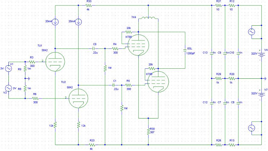

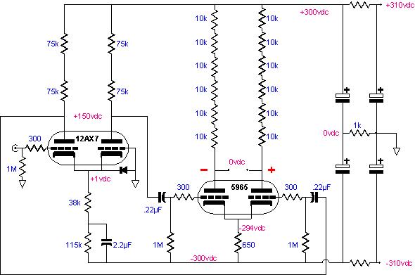

It is now time to get a tiny little output from them. I've read a lot of designs and Morgan Jones x3 so many times that it's falling apart.... so I'm ready to come out of the closet! Regarding safety I'm scared stiff, I've been electrocuted by 220V in the shower, 10 years ago...
I was planning on doing a Tubecad/John Broskie design as attached. A 6C45PE or 5842 driver and a EL34 for output for a cheap and easy start with a +/- 300V bipolar PS.
So I have a couple of questions I can't seem to find the answer from.
-An ordinary output transformer with secondary unconnected, can act as an anode load for the output stage. How do I choose this, do I just care about the primary resistance fitting with the output tubes? Frequency response and all this will have no impact...and so on... Anything else? (I bought second version of MJ's book to find an answer but no luck!)
-How hot can we put the operating point for EL34's?
With a choke load the peak possible voltage swing is almost twice the HT, how should this affect my choice for operating point? I have 600V over the tube, so do I put operating point at 400V, 450 or 500V or something?
- Will this bipolar PS mess up the possibility for twice the HT voltage swing? There is still 600V over the tubes, but 300 of these are negative!!! It's mentally distressing!!!
Comments will be much appreciated...

Schematic
Yes schematic was used for headphones, but I'm going to use more powerful tubes... I don't aim for very high Sound Pressure Levels's so to say. A electrostatic headphone is still just a smaller capacitor...

You need a lot of voltage swing to drive ESLs. Really a lot. A good starting point would be to use a conventional EL34 power amplifier (with output transformer) and take the output directly from the anodes. Don't worry about not loading the secondary of the output transformer. Unless you're in the habit of grossly overdriving the amplifier (like a guitarist), you won't damage the output transformer.
Resistive loading of the output stage is feasible for headphone amplifiers but not for loudspeakers. To get the same voltage swing using resistive loading as choke/transformer loading, you need twice the HT. Assume 400V across each valve, and 70mA through it, that would be 28W dissipated in each anode load resistor and require an 800V HT. You will find that the cost of an amplifier rises very quickly with rising HT voltage.
Once you've gained a bit of confidence with EL34 at 400V, you might want to try KT88 at 500V or PL519 at even more. After that, you're looking at the smaller transmitter valves.

Voltage swing is needed and the more the better, but the smaller the capacitance the less voltage swing is needed. Martin Logans need f.ex. a lot less than Quad's ESL. People have reported with Martin Logans that produce 300-400V p-p swing produce an almost decent listening level.
The reasons for my questions is simply to unravel how to produce the highest possible voltage swing. ER-Audio's ESL are very low capacitance so less current is demanded for the high's. So I'll try EL34 at 400V.
EC8010: I was planning on using choke loaded output stage, except for the primary resistance I don't know which parameteres to look for in a choke (books say nothing). Also with a choke one can swing to almost twice the HT voltage as in Morgan Jones "The Beast" esl amp. So choke is going in....

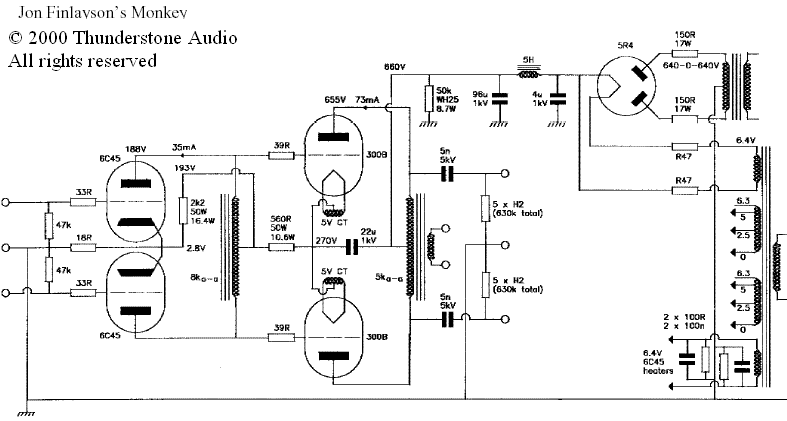

Attached is Thorsetn's setup (as posted her) for an ESL amp....

Correction...
Correction, drawn by Thorsten, design by Morgan Jones and build by Jon Finlayson... Nice to be correct...
Actually, design by Thorsten, drawing by Morgan, build by Jon.
The choke: Ideally, one would like a low-capacitance choke, but as you're going to hang 1nF or so in parallel, even that isn't crucial. The other aspect that's important is the inductance; you need it to be sufficiently high that it doesn't shunt the load at the lowest frequency of interest.

Regarding EL34 operating points, a lot of tubes are designed to run close to Va Max. Max anode voltage for EL34 is 800V, but loadlines don't look like there is any point in running them close to this... In application data on Duncanamps for the EL34 there is a spec. for running them push/pull AB1 at 775V!!! What do you say to that!!! Triode connected curves are easier to analyze, but where are they!!!
Regarding voltage swing, example... lets say I have 420V HT, choke loaded output stage and 400V on the anode, I can then swing to almost twice the HT (because of choke), so I just make sure the driver stage can deliver grid voltage so that anode can swing to (lets say) 700V, right? I think so, just want to be completely, without any doubt sure, I think... 😀
