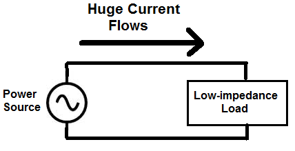

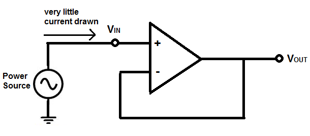

A TL072 or better unity gain buffer per channel, to handle + and - signals.
Up to 1M input impedance if you wish (not actually needed but to show capabilities), ruler flat, vanishing distortion (certainly nothing you can hear), ruler flat from DC up to 1MHz, very low noise and even better with choice Op Amps (which still cost a couple bucks each), up to 9V RMS if fed with standard +/-15V, very low output impedance, although it´s customary to add a 100 ohm resistor in series with each for stability purposes,will EASILY drive IcePower 1k8 balanced inputs, what´s not to like?
Being very simple, if no boards available (there "should" be some), it can be built on Veroboard or stripboard (same thing).
http://www.learningaboutelectronics.com/Articles/Unity-gain-buffer
Turns THIS:
into THIS:

I wouldn't, if bel canto decided a line buffer was the best solution when they used icepower boards, then that's probably the best solution for me too. And it's not like these come with a schematic.I would modify the 100as2 board
I'd assume this is effectively the same as using a fet powered opamp in the little line buffer I've ordered the bits for? A Nelson b1 would be prohibitively expensive and large.One low power FET (MOSFET) repeater per channel (Nelson Pass).
