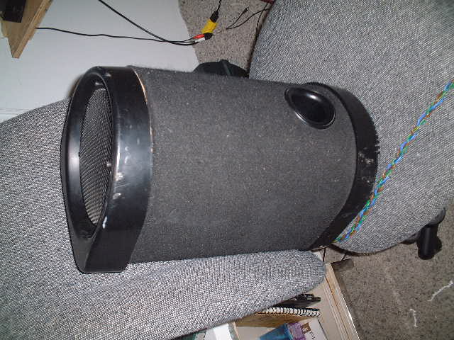

Isn't the Fs a little high for a good TL? I don't know, ask Dave. Seems to me that the .55 cubic foot box tuned to 52 (reafirming previously posted results with my numbers) would be better suited for an inexperienced builder (I'm assuming, and I apologise if I am wrong). I'd use either a 4 inch diameter port 19.4 inches long or a 3" diameter port 10.5 inches long. If you're interested in this stuff you should get a book...it helps a lot. (Loudspeaker design cookbook is a good one)
