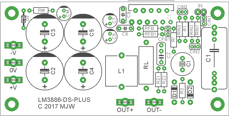

Hi Mark,

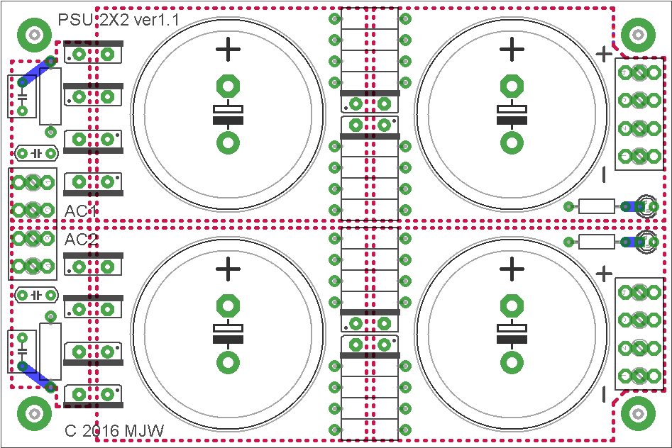

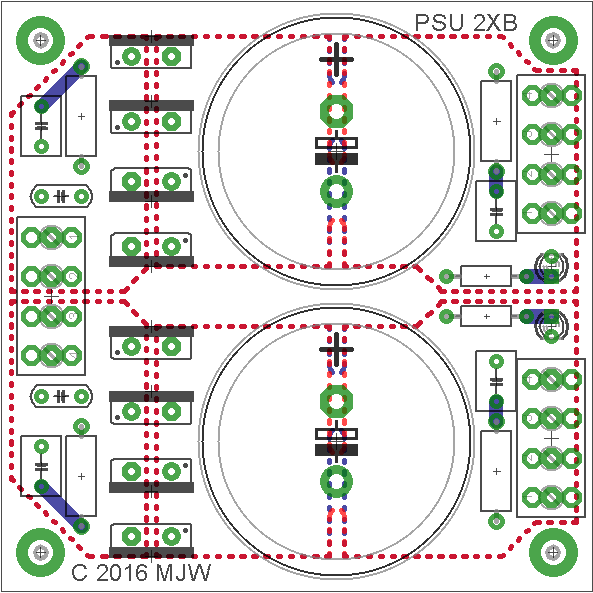

Great looking PCBs. What's your PS design? One bridge per rail? Does the board have space for snubbers on the diodes? What type/format diodes will be used?
I'm not set on any particular transformer. Less is more... except I do want each compact stereo amp to be capable of say 2x30W into 6 ohms. Easier to re-purpose afterwards...

Hi Scott! I want low distortion but Class A is out of the question for me. This time around I want something compact. Cheers - Pops.
The snubbers used on the PSU boards are inspired by the RingNot PSU. The attachment in the first post explains more. I have MUR680 diodes already. The FFPF30UP20 looks good too with 30A max current.
I use 4 diodes per rail because I am convinced that it produces lower noise on the PSU/amp ground than 4 per two rails.
