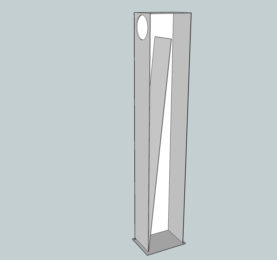

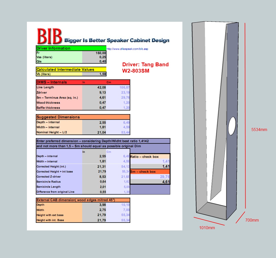

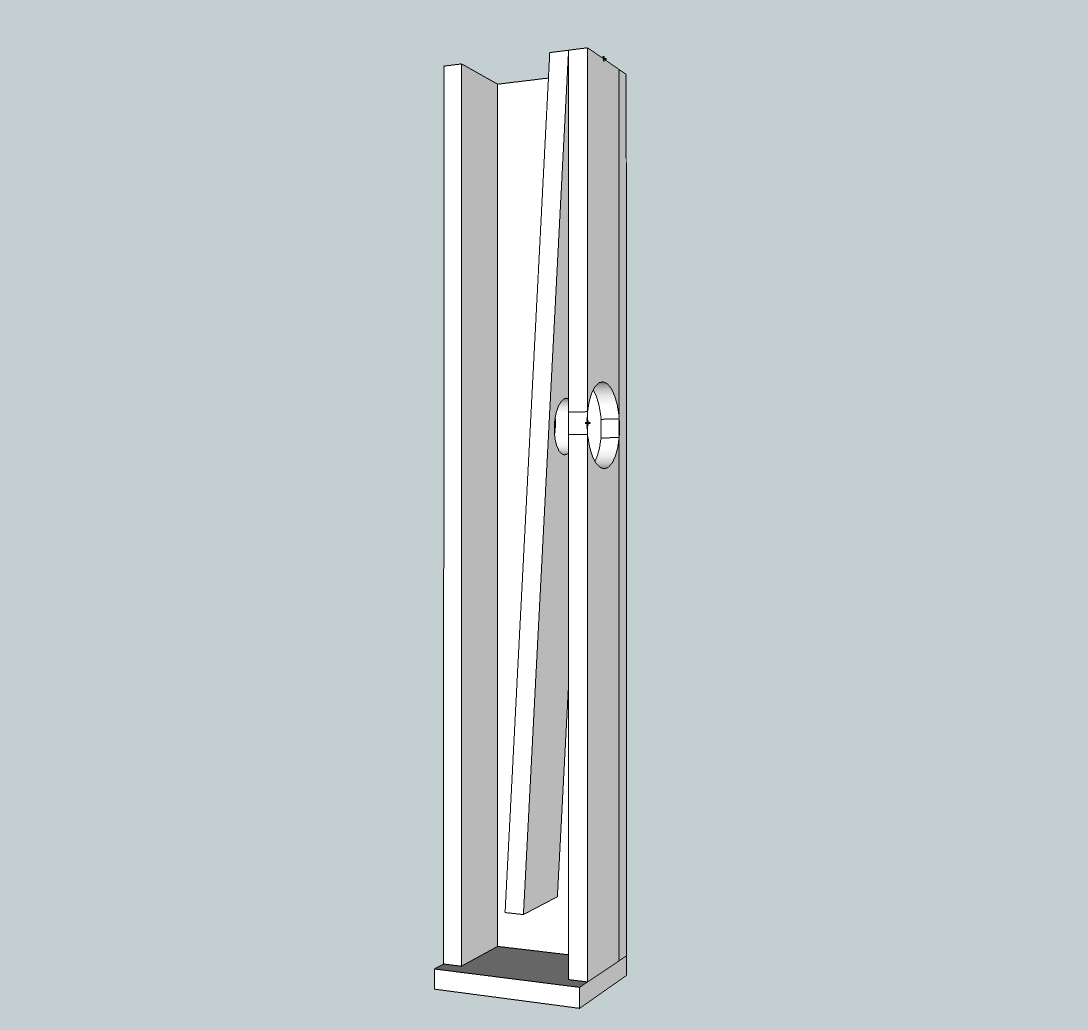

Gugi,
don´t you think this enclosure is much to large if you need a sub?
Large? It's only half a meter tall.
Hello a BIB is a bass enclosure, this works useful 3 oktaven, with this driver
you can use only one, and you need a sub, so you can use this driver with such a reso
also in a small a few liter enclosure because you have to use a sub.
