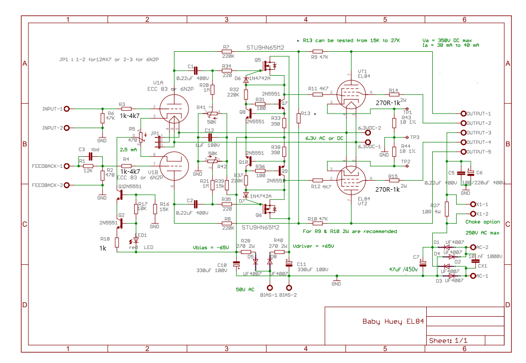

About R33 and R38:
to fully drive the EL84 I need around 25 Vpp (a bit more if I want to reach AB2) up to ten times (to be conservative) the bandwidth, so 200 kHz, so slewrate will be:
2 x pi x f x V = 2 x 3,14 x 200 kHz x 25 = 31,4 V/us
One EL84 has an input capacitance of 11 pF (let's say 15 considering wiring?).
C = i x dt / V
dV/dt = 31,4 V/us
then
15 pF = i / slewrate
so
i = 15 pF x 31,4 V/us = 470 uA
The current of the CCS is 0,7 / R33 (or R38), so we'll need that resistor to be less than 1.5 kOhm. I will keep the original 390 Ohm.
Powerdrive AC voltage supply
Being the negative side of the PI's CCS connected with the negative rail of the Powerdrive circuit, the voltage is set by this one at 3 times the bias voltage ( EL34 Baby Huey Amplifier ).
So for a EL84 amp with approximately -12 Vdc it will be around -35 so, multiplying by squared root of 2, a 50 Vac winding is needed to supply it (it's called BIAS on the pcb).
About R16 and R17:
On the BOM and the PCB they are shown as 1.6 kOhm and 1 kOhm respectively, but this is due to a very early version of the Baby Huey, not the current one.
The guideline is to keep the current of the led of the PI's CCS between 2 and 5 mA, preferibly towards the lower value. In both versions, EL84 and derived EL34, R16 is around 1.5 times R17. I still don't know why, but I'll keep this proportion.
So considering the small losses in D5&R28 plus the drop due to the led, we have around -33 Vdc to be dropped by R16 and R17 with around 2 mA.
Then R16 + R17 becomes 33 Vdc / 2 mA = 16.5 kOhm. Then I decided to have R16 = 10 kOhm and R17 = 5.6 kOhm. This leads to around 2.1 mA.
About R3 and R4:
On the BOM and the PCB they are shown as 1 kOhm, but this is quite low as a value.
The old guidelines for triodes were to use 8/gm to set the grid stopper value, so with a 12AX7 which gm is 1.6 mA/V the value would be around 5 kOhm. In my guitar amps I always use at least 10 kOhm because gm of the tubes goes down with age, and I want to be sure there are no issues even when tubes are almost gone.
With an avarage value of 12AX7's input capacitance (Miller included) in the order of 150 pF, 10 kOhm gives a low pass filter with -3db point at 106.1 kHz. I would say it's plenty acceptable.
IMPORTANT NOTE: carbon comp here is the best choice, because they are the resistors with lowest capacitance and inductance, and that is what is needed in this position. I used carbon film, the second place in the choice.
About R7 and R8:

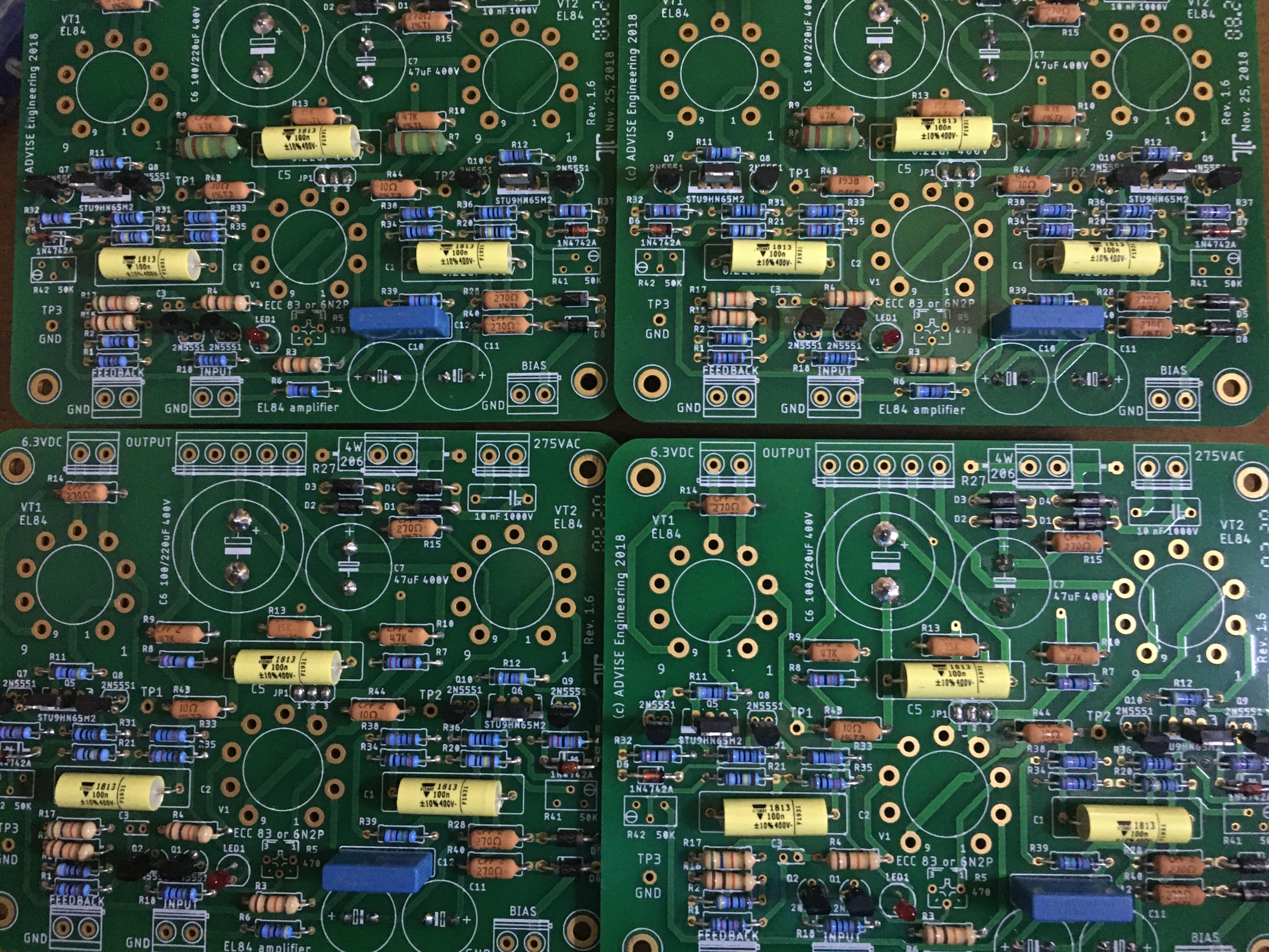

In the BOM they are 600 mW resistors, but they need to be 1 or 2 Watts, because of the voltage they see across them (remember that they are connected to the shunt feedback system that is directly connected to the primary of the output transformer.
Of course I noticed it only after I soldered all resistors, so by now I decided to install 2W metal oxide resistors on a pair of pcbs and keep the BOM ones on the other two pairs, in order to be able to check the differences.
On my experience with guitar amps, higher wattage on plates of preamps gives more dynamics and more definition to the sound (over there there's need to get higher THDs with specific harmonics), I'm curious to see if it applies to this scenario too.

In attachment you can see the boards with the standard R7 and R8 resistors, and with the 2W metal oxide ones.

I uploaded the schematic in order to make it easier to understand all values and my comments:

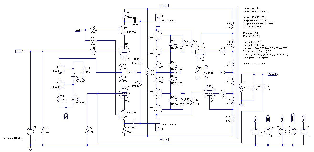

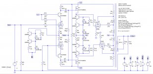

I attach here a modification to have a cascoded version of the PI.
These are the results at 15 Wrms:

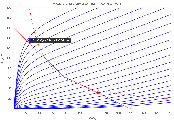

EL84 BH with 6k6 43% OPT

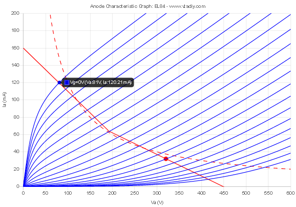

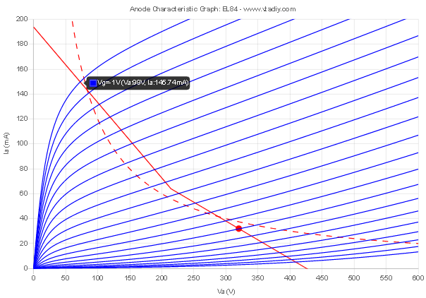

Hi, as the OPT for BH is discussed here, please share your thoughts about EL84 BH variant with 6k6 43% UL transformer. According to EL84 Mullard data (https://frank.pocnet.net/sheets/129/e/EL84.pdf page D2) the output power with 6k Raa OPT should be around 10W (distortions 0.72%) for 300V supply. I'm wondering whether this option will work correctly with BH circuit. Any modifications should be applied (e.g. shunt feedback resistor value)? Highly appreciate your comments.
Hi stelark,
when you look at datasheets, you only find a specific way of using the tubes.
In this case you are looking for UL feedback only.
In a project like this one, the synergic effect of UL and local feedback have to work together and must be analysed together.
This is the reason I went for what is called the "maximum power" UL configuration together with a-g1 local feedback (often used alone to "triodize" the curves of the output tubes): simulating the combined feedback from a to g1 (24%) and g2 (23%) it gave me good results at almost twice the power you'll get with a-g2 feedback only.
43% UL has almost the same power at 6k6 and 8k Raa (the former has more current, the latter more voltage swing), but I prefer 8k (more linear, better damping, more "A" class, tube runs colder). Even 10k could work with 43% UL with not so much power loss.
330V B+ together with 8k Raa and 23%UL gives a good transition into overdrive and brings the plate at around 50V with g1=0 (that means almost 20W), then 24% a-g1 feedback linearizes more and improves DF without stressing the phase inverter too much.
This is the best configuration I've found. Of course you can prefer different solutions based on your speakers, music preferences, mood et similia.
You can play with curves and loadlines using this tool:
Loadline calculator for power stages with reactive load - Vacuum Tube Amplifiers - DIY
