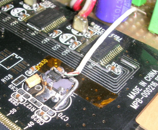

I tweaked with my cmi8788 based soundcard by replacing traditional crystal oscillator with Rakon brand oscillator chip at same 24.576mhz.
I thought that if i could supply oscillator chip via clean power source then it would be an improvement.
I removed two little capacitors and crystal and applied oscillator chip like schematic below.
It worked but playback is too slow. Rebecca Pidgeon sings like Hulk Hogan.
I tried 10 nf cap, 100r resistor at output and 3.3v supply but same result.
I used oscillator chip from an old soundcard. Maybe it's a faulty or non accurate chip.. have you any idea?

kevinkr said:
Have you measured the oscillator to make sure it is actually producing a 24.576MHz output? You might also try a new oscillator module from one of several sources like Tent Labs, etc.

Eric_R said:
Why don't you remove the 1M resistor also, it leaks signal from XO to XI.
First, i tried without it, when this problem occurs, then i resolder it after checking for similar modifications. Then, i will try without it again...
weissi said:
I would also put an series resistor of ~100Ohm between Oscillator Output and CMI8788 Input. Otherwise you might get some ugly overshoot.
But I'have modded my CMI8788 in a similar way, so it should work.
My soundcard is Club3D Theatron DTS (Bluegears B-enspirer). I tried with 100ohm resistor as i mentioned in first message. Which parts did you remove? Did you remove 1M resistor? Can you give a little explanation please?
I also have the Theatron. Basically I have removed the 1Meg Resistor plus the to ceramic caps and connected the output of the oscillator via a 100Ohm resistor to XI of CMI8788. But I used an 3.3V oscillator. Normally this shouldn't effect the CMI8788 but I don't know if its Ports are 5V tolerant....

terranigma said:
Maybe this is the trick. That seems it wouldn't be clear unless getting a new 3.3 oscillator.
Thank you all.
The spec says that absolute maximum rating is 3.6V on all I/O ports. I would not run it for a second like that, as the voltage swing from your 5V oscillator moslt likely exceeds the absolute maximum rating. You might fry it.

weissi said:
Ah, th regulator part was done under a microscope I had in my last job.... made me fell in love with smd parts 😉
if you take a closer look you will see that it's pretty easy to acces every DAC's analog supply stage. Just lift those small ferrite beads: FB19-FB22
/Mike
This is the last thing i want to hear in this topic :hot: I resoldered smd parts and checked it again... no more problems at the moment :angel:
