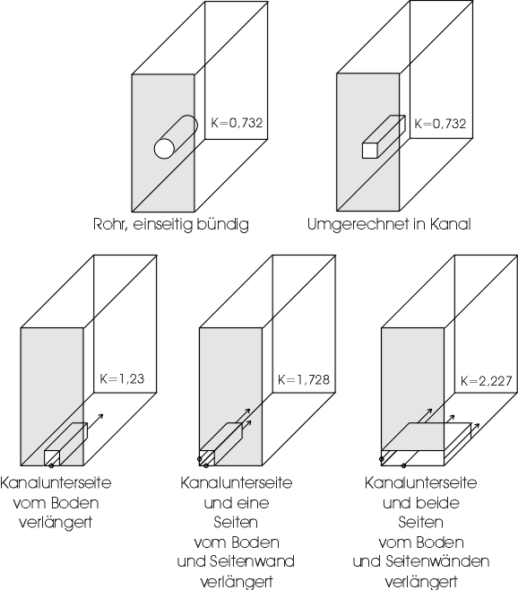

In my opinion, it's better to keep the port away from the bottom/top ends of the box in order to avoid coupling the port to the pressure nodes of the standing waves in the box. This means that ports should go near the center of the box, which I find easier to do with a round tube.
Would be nice if this was backed up with measurements and some kind of theory that related the pressure variations at enclosure walls with the movement of the air in the port. Personally I worry more about the resonances in the port itself, these can be quite persistent and troublesome in two way systems. Anyone with a sound measuring rig can comply to that.
If you have software to model a ported box that is based on the dimensions of the box and not only its volume, like TL-modeling software has, you will be able to find the best location for a port relative to the box's dimensions and the woofer's location. It's simply not true that locating a port near the top of bottom will be necessarily be problematic and locating the port in the middle can be very problematic.

Meanwhile, I think having symmetric flare at both ends, and no obstructions, is more important than square versus round, based on Button/Salvati/Devantier's AES papers from Harman/JBL research. This suggests an interesting port would be a slot port vertically along the back wall, with...jeez it's hard to describe. You'd have a wall coming down from the top, and one coming up from the bottom. They would be spaced apart, forming a port. You could make this symmetric.

The larger the cross-section of the port, the longer the port needs to be for a given tuning. This forces other design considerations such as enclosure dimensions, internal reflections, driver/port placement and the like. Everything is a trade-off.

If you don't care about the physical size of the enclosure, building larger rectangular or slotted ports can be a lot less complicated than having to source or custom build very large flares and pipes.
Keep in mind however that very long ports also cause pipe resonances up in the midrange frequencies, so if you're building a ported enclosure for a midwoofer instead of a subwoofer, you might want to keep your ports smaller and shorter to prevent noticeable resonances in the midrange frequencies.
