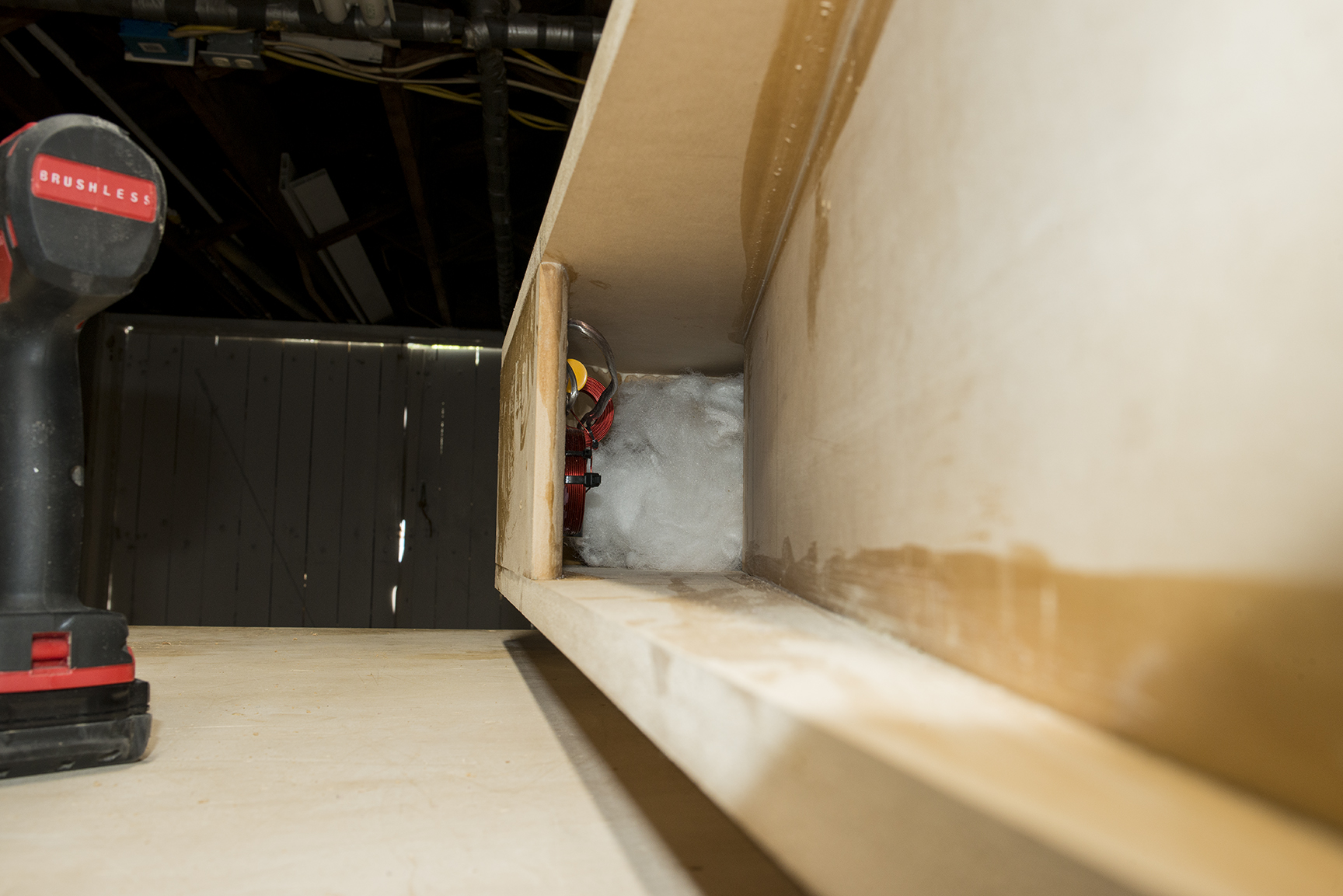

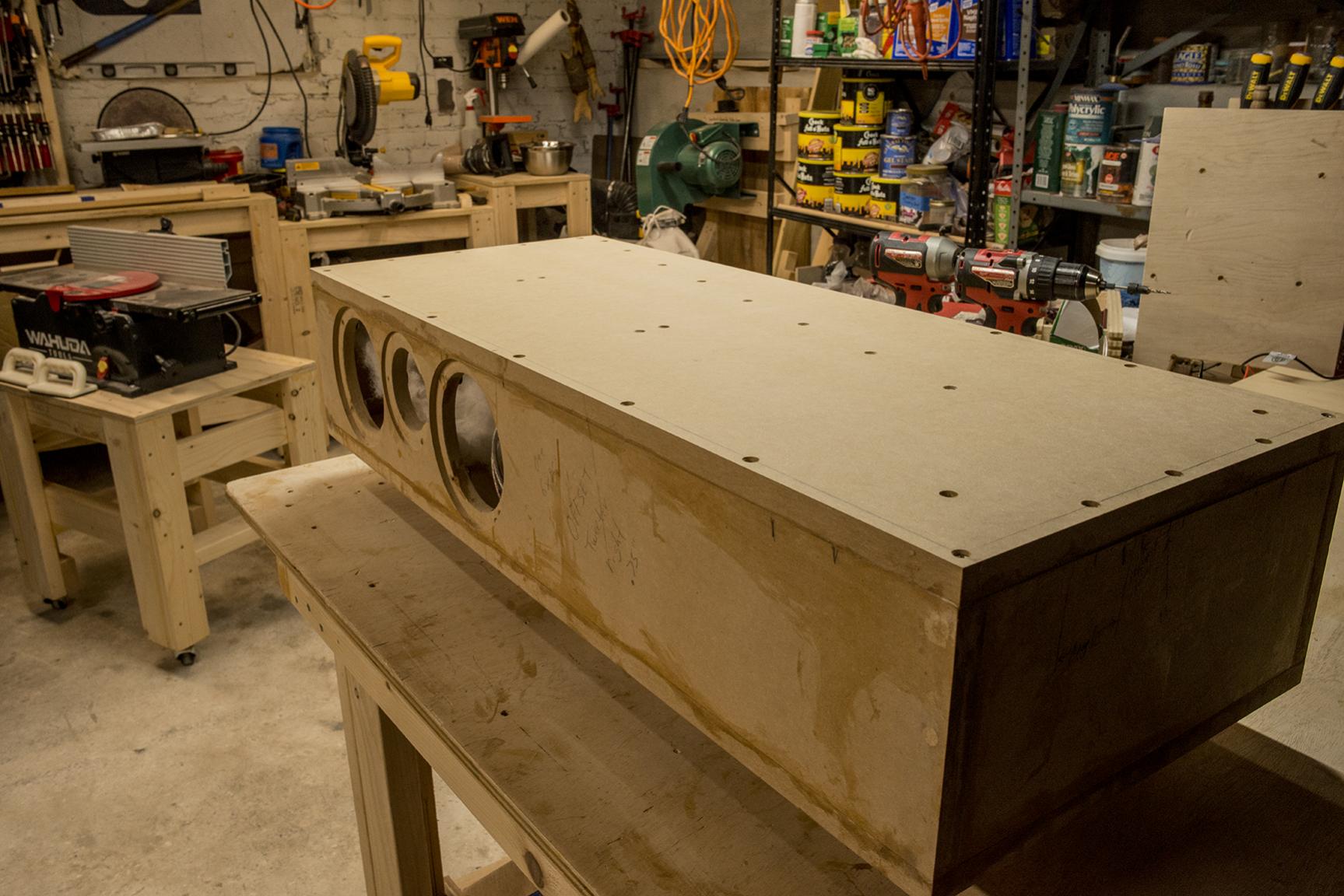

As part of a woodworking forum I asked an opinion of what a slot/dado would do to help a cabinet vs just glue. Of thos who replied, a glued joint is as strong or stronger than MDF itself. The tritrix has slots cut appx 1/4" into the sides for the TL divider to fit into. The corner waveguides do as well. So My question is of how important is this joint if the divider is well glued and clamped just to the surface. Also, the slot/dado does not run the full length of the TL. Both ends have appx 4 to 5 inches that come up out of the slot/dado and glue to the surface.

We know that usually a butt joint is minimally sufficient, and the glue will hold until the wood gives. With certain types of wood, a dado gives a greater area to glue as well as a range of grain aspects, and a mechanical advantage.
So which is the weakest, how will this help MDF? It seems that if you stress a butt joint it is most likely to come undone by delaminating the MDF on the glued surface. By creating a more involved joint you're ensuring a larger portion of the thickness is taking the stress.. on both pieces, if the right joint is selected.
For what reason do you feel this is less suitable? Audio calls for many things in a box but one is that it doesn't flex needlessly. A mitre joint is also interesting but many avoid it because it requires precision cuts.

You are over thinking that cabinet. The dado lets you get the parts in the right place every time. I made those speakers and the cabinets were very solid. Good glue joints (spread the glue evenly and clamp) will be much stronger than needed. I have woofer boxes that I made in the early 90's with MDF and butt joints that are still rock solid.
I do use dados in my recent builds because it helps me ensure the box is square and all the panels end up where I wanted them. My most recent build was a set of microtowers with mostly butt joints and while they are plenty strong I cursed loudly at not having the dados for alignment on the longer joints.

Allen, thanks for helping. Precision cuts are common for woodworkers. Such as the required 78° TL, easy peasy to a woodworker. We sometimes get anal about thousandths of blade alignment tolerance. Glue and wood/MDF is very strong, the point of the glue/mdf contact is not going to move. It appeared the slot was for ease of kit assembly but I wasn't sure. Add to all of this are the screws which I personally add a small amount of glue to the screw holes to help strengthen the fibers long term (not to much or it will cause a bulge). I question what happens when the TL comes up out of the dado to lay on top of the MDF. Appx 4 inches on each end is not in the slot, is this transition perfect? So I questioned whether the dado was actually acoustically important, thus my thread. I wasn't questioning strength just acoustics.

I have the bins shellac waiting for it. My joints are very tight and screwed as well and when you put a knuckle to it the sound is very tight. I have learned a lot from the people here and building the cabinet myself, I appreciate all the help.
I am now comfortable without dados as long as the cuts are straight, square, well glued and screwed ( I clamped and cauled at times as well). When I set up to cut the baffles, waveguides, braces and panels at 6", I cut them all at the same time and they were the same exact height.
