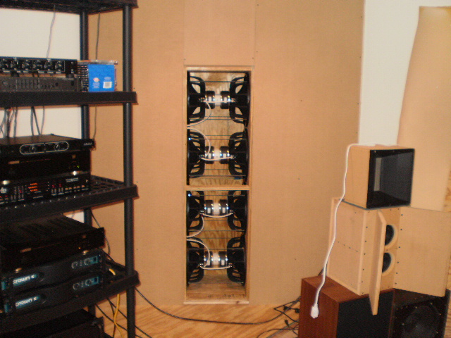

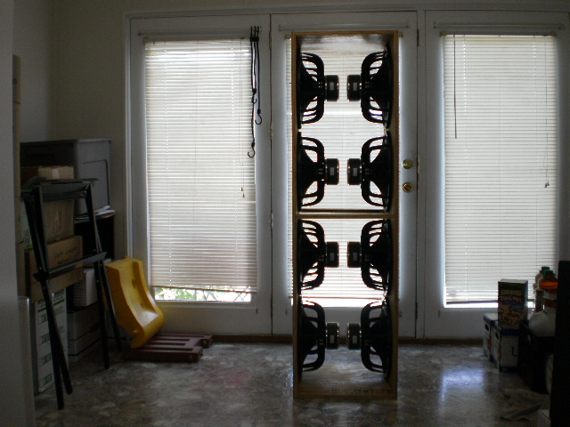

Infinite Baffle Sub-woofer stystem
In my opinion, a true infinite baffle sub-woofer system just smokes anything else. In my set-up I use 8 Acoustic Elegance IB15's in a reaction-cancelling configuration. The slot opening up to the sound room is a tad bit greater in area than the total cone area of all eight woofers added together. The rear wave exists into a closet of about 600 cubic feet.
One picture is of the construction, the other when installed.

Your columns sound rather resonant. I, too, have columns, and decided to put small cabinets in them as simple sealed design. 4 10" inexpensive subs turned out to be plenty for my large living room. In cabinet, response down 2db at 30....
You're thinking of the transmission-line-like containment of the back wave before dumping into the "infinite volume" space?
That's one of the conundrums of which I haven't been able to intuit the impact.
I'm figuring something in the 14 to 16" diameter air column, 4 to 5' long, which obviously puts some moving air mass behind the driver, but I can't figure out how to model it on paper.
