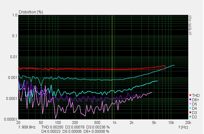

Now to the measured performance (and where my problems begin.)
First a measurement of the system that will be used for measurements. Taken at 96khz.
This varies with the time of day. It's usually better late at night when people have gone to bed - less electrical noise floating around? Perhaps.
Next is a measurement taken at 8 volts p-p into my 9.4ohm test load.
First of all you can see that the second harmonic is actually lower here then in the actual measurement of the 'soundcard'. This is a dual mono implementation of the PCM1794 DAC + PCM4202 ADC. And it shows how the performance varies with time as the first measurement was taken on a different day.
The overall distortion here is reasonably low and should be pretty much entirely off the audible radar.
Now the fun begins.
I'm going to link a series of measurements. These are all taken whilst driving my 9.4 ohm dummy load. There will be two sets of graphs, taken in pairs at 1khz and 10khz. These are at drive levels of 13 volts and 70 volts p-p (just before clipping).
1khz 13v
10khz 13v
1khz 70v
10khz 70v
Performance like that is quite respectable you might say, but I find it a little perplexing. What isn't shown is a third set of data I took at around 26 volts p-p. Distortion remains roughly the same up until that point, then starts to degrade as drive level is increased.
The most confusing part is this next graph...
This is once again taken at 70volts p-p, but this time with no load attached. And this is where I scratch my head.
The distortion at 1khz = the same whether or not the 9.4ohm load is attached to it or not.
Now it is my understanding that the 1khz distortion should remain pretty much ~0.0005% up until around clipping, with no load. Then it should measure considerably worse with the load attached.
This also leads me to believe that I am not being troubled by distortion 5 or 6 in Self's book ( Bad rail decoupling and Induction distortion) because these are entirely dependant on their being half wave sine pulses on the power lines. With no load attached there's zero pulses as the amp isn't having to deliver any current. I've measured this and indeed very low ripple and zero sine pulses.
Biasing the amplifier into Class A also doesn't solve these problems (as you'd expect), it can give slightly lower figures in certain places at certain drive levels, but this is to be expected also. This also leads me to believe that the point I've taken the feedback off isn't to blame either - although I'm open to suggestions on that part.
I have most certainly used NPO/COG caps in the feedback circuit and also in the 2pole comp circuit. I'd be surprised if they were suspect, but again that's open to consideration.
Now, the wire that carries the output from the board to the terminal on the case.
I can degrade the distortion performance by moving this around, but only at high frequencies and if there's a load present. This isn't really surprising and moving the wire around at 1khz doesn't really affect much.
This is the time where you turn around say, welcome to the real world. Yes I am aware that the overall THD I'm getting is better or equal to the vast majority of consumer amps I have seen measured. However reading Self's book leads you to believe that maintaining ~0.000x distortion figures for 1khz, before clipping, should be achievable.
Am I crazy in thinking that? I'm certainly not disappointed with the results, but I have a feeling I might be able to do better.

This isn't what Self says. He says that Rail decoupler capacitors - which are the only things that actually have power ground in this amplifier, as far as I know - must have a separate ground return to the reservoir ground. This must not share any part of the audio ground system, and must not be returned to the star-point.
Are you implying that I ignore this and connect the power ground directly to the star point?
I'm going to try re-grounding the zobel and see what happens.
no, Self is right..... Rail decoupler capacitors .............. must have a separate ground return to the reservoir ground. This must not share any part of the audio ground system, and must not be returned to the star-point.
Look at his diagrams. His star point and your "ground" are not the same.
His diagram explains.

Altering the layout of the grounding didn't really solve much. In fact it didn't change anything, that includes altering the return for the power ground.
This doesn't seem to be ground/PSU/induction related, or I'd expect the distortion to change dramatically depending on the load the amp is driving. Am I wrong in assuming this?
Is this a problem at all? Currently I stop getting 0.000x distortion, turning into 0.00x at about 37 volts p-p into either the 9.4 or 4.7 ohm dummy loads at 1khz.
I'm also getting 115 watts into 4.7 ohms @ 1% THD @ 1khz and 85 watts into the 9.4 ohm load under the same conditions.
The 4.7 ohm test seems prematurely limited by the +ve protection. If they were symmetrical I'd be getting just under 135 watts into 4.7 ohms, although this is really academic. The only part of the system that's 4 ohms is the tweeter and the system is entirely active, I never use more then 1-2 watts for the tweeter.

Yes actually this does and its almost entirely third order.
When I've made STEPS measurements at high power levels, all the harmonics are acceptably low, except third which remains constant in level and unreaslitically high.
So say third harmonic would be 0.002% from 20hz to 2khz, the rest being 0.000x. Then as frequency rises distortion also rises as you'd expect.
This would also explain why its independent of load too as the voltage impressed across the cap doesn't change, if anything it gets lower under PSU droop.
This 3rd harmonic really looks suspicious in "favour" of C6.
If possible (still stable) i would take it out and see what happens to the 3rd harmonic plot.
