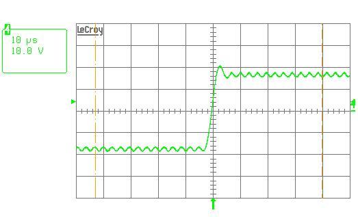

I build a ClassD-Amp in my diploma, too, a modified UcD (with bandwidth up to 100kHz and a switching frequency around 330kHz). And it worked, with high loop gain. 30dB is enough, especially when provided over the whole frequency. The little phase shift near the cutoff frequency of the output filter can be ignored.
That's interesting. How come you got bandwith up to 100khz with oscilation only 330khz? A little description?
Hi lumanauw,
nothing special about it, just a first-order UcD at the limit.
The low switching frequency is no problem. An interesting paper about this is from Song/Sarwate: The Frequency Spectrum of Pulse Width Modulated Signals
I attached some impressive picture taken at the output of my amp. Looks nice, eh?
Bye
Baseballbat
