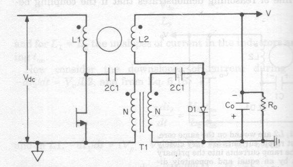

Isolated Cuk, do you mean something like this?

That's the one -- for bidirectional power (needed for class D) you need a switch (MOSFET or IGBT) and diode on both sides, then for linearity you need to duplicate the whole thing with clock inverted.

I did some quick behavioural calculations for the isolated bridged Cuk amplifier, targeted at high-power amps (2500W/4ohms) similar to the QSC380:
-- two bidirectional amps with bridged output
-- one switch per amp on audio side, load bridged across two amps
-- one switch per amp on mains side, push/pull amps in series
(2 series 200V capacitors for DC bus, either from PFC or rectifier)
This way the switches are identical on both sides, and with 50% PWM duty cycle each has a peak voltage equal to the input DC bus voltage -- 325V nominal for rectified 230V mains, maybe 380V for output of a PFC.
For 2500W/4ohms the duty cycle varies from about 0.4 to 0.6 so gate drives can use transformers; the problem is the stress on the switches. The amplifier output is 100V/25A rms (140V/35A peak), the peak voltage across the switches is 400-450V (depending on DC bus voltage) which is fine for 600V devices (maybe even for 500V) -- but the peak switch current is 85-90A, which is about 2.5x the output current (even average current over a sinewave is about 30A).
The switches either have to be CoolMOS MOSFETs with series Schottky and antiparallel ultrafast diodes (like Ixys IXKF40N60SDC1) or ultrafast IGBTs with copack FRD (like Ixys IXGR48N60C3D1).
The IGBT can just about cope with the current (forward drop about 2.5V, which still means 300W loss), but the switching losses are too high -- more than 2mJ/cycle for 4 switches, which at 250kHz means >500W switching dissipation at 2500W output :-(
The MOSFET has lower switching losses (difficult to tell just how much lower) but will have large conduction losses, with Ron=60milliohms the forward voltage drop at peak current will be more than 6V.
In either case the combined losses due to on-voltage drop and switching means efficiency will be about 75%, which is pretty terrible for a class-D amplifier (though maybe not so bad if you consider that this also includes the SMPS function).
The reason for this is simple, the Cuk converter needs switches with *much* higher voltage and current ratings than the amplifier output signal-- in this case peak output is 140V/35A (5kW), but the amp needs 4 switches each with peak rating of 400-450V/85-90A (36-38kW), which is >7x higher than a normal full-bridge class-D amplifier...

In Cuk converter (SMPS), after the capacitor there is only 1 diode. Why in Cuk classD, after the capacitor there is PNP transistor? What is this for, how does it work?
