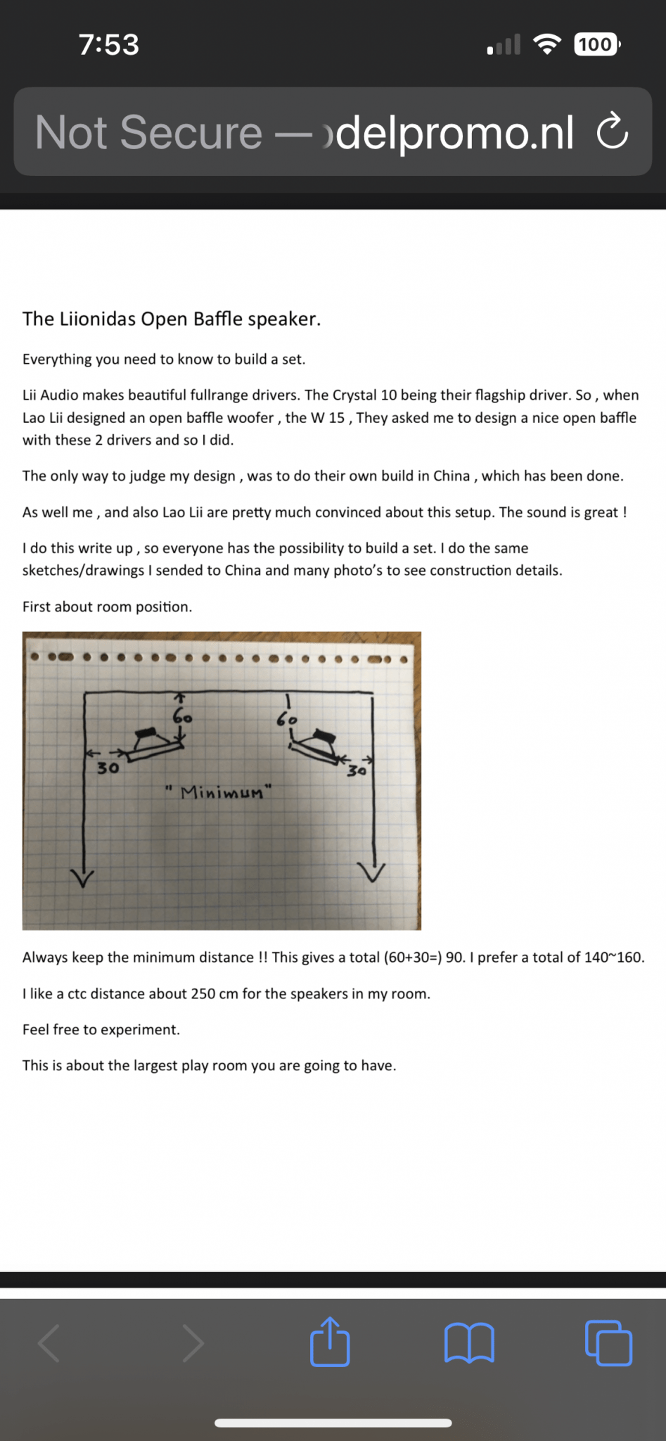

Hi Lewinski
I don’t want to wander from the OP topic too much.
I guess SLOB and OB room placement concerns are similar enough.
While my long term OB project evolved over the last few years I came across the Liionidas article.
Since my project was already very similar, and I had just come across a pair of used Crystal 10 I wanted to try, I decided to use it as a guide to make adjustments.
Leon included a room placement map in his article. My room mimics the basic guidlines for placement. (Image)
It resulted in a little more room on the sides of the panels and a back space of at least 24 in (60 cm) toed in towards the listening position slightly wide of on axis.
There is no sub woofer in this system. I don’t feel the need for one. Perhaps if it was a home theater system that would be different. It is only for music.
I play everything from classical guitar and piano to dubstep, jazz and rock on this system throughout the day.
I can say there is no contest as to the amount of good clean bass output coming from the dipole 15 in the OB. My SLOB didn’t come close.
