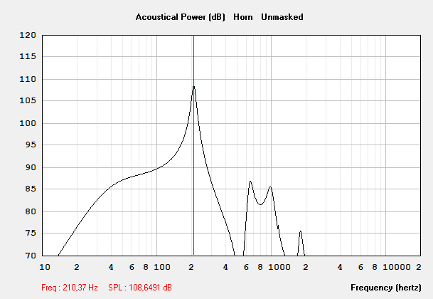

Just for fun, I tried to somehow model this slotted enclosure as OD horn in Hornresp (but with sealed back of a large volume). And this is the result:
Quite a good prediction I would say. I wonder why I could not measure much dipole cancellation with this build.
Hornresp record attached.

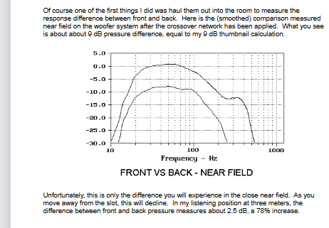

If the front slot is narrow you might get a good output velocity push forward with higher dB out the front; as long as you arent too far back. How far from the SLOB were you?
When you try it again, see if you can set it up in the near field.
It could be just in front of your listening position, eg under a coffee table or on the floor with a throw over it turning it into a coffee table or foot stool. On the floor you should get a half pi dB boost. Plus a near field proximity boost of maybe >3dB and with less room excitation. Possibly one of best bass options designs.
Otherwise, it could be set up behind. Perhaps elevated and very close for a +6dB to +8dB boost. Perhaps on legs and angled so its hidden behind the chair back and the slot is pointed straight at your ears. If you do 30-90Hz hopefully you wont be able to locate the SLOB behind. The HD higher tones that would give spatial locations cues should be low with the SBOB woofers just idling in a very near field set up.

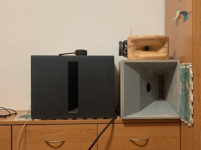

I did a little listening test. It seems to work quite well. Listening distance is around 2 m. I had to equalize the peak and add a HP filter at 40 Hz to prevent overexcursion. The level of bass is not dropping fast in the room, it strangely behaves like a normal box, I do not understand that. The picture of placement is below (the wooden horn is not connected).

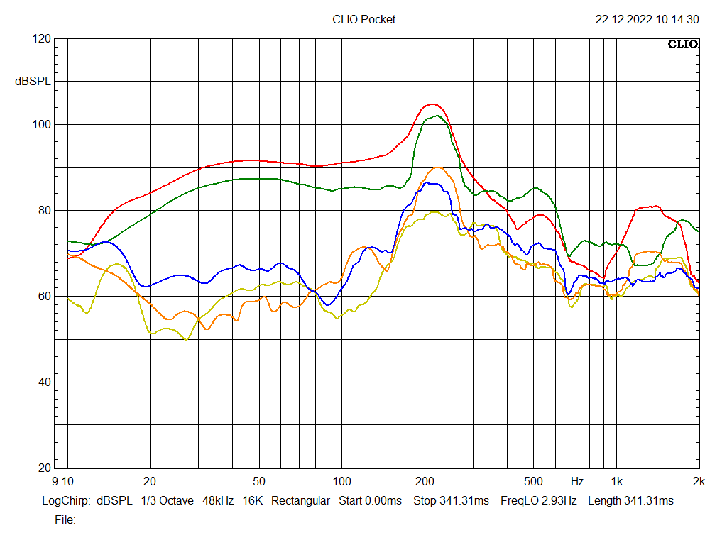

So I have some more measurements in the position shown in the picture.
The red trace is 5 cm away from the front port, the green trace is 5 cm away from the left woofer magnet and the other traces at roughly 0 (yellow), 45(brown) and 90(blue) degrees 1 meter away to the room, all 1/3 oct smoothed.
I wonder what am I looking at. The peak would be normally EQd out, so it would not be there. What I see is low efficiency, but quite flat bass down to at least 40 Hz all over the room (with room influence).

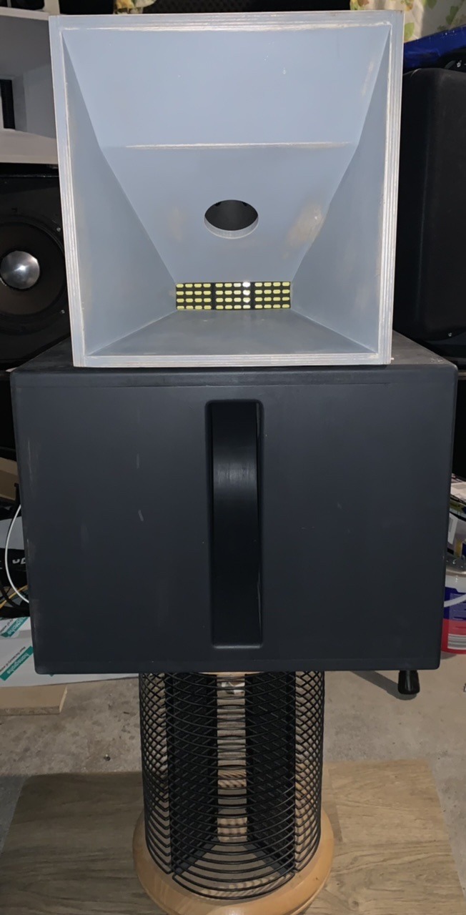

Hey what is that a speaker attached to the side of that wood horn or I'm seeing thingsI did a little listening test. It seems to work quite well. Listening distance is around 2 m. I had to equalize the peak and add a HP filter at 40 Hz to prevent overexcursion. The level of bass is not dropping fast in the room, it strangely behaves like a normal box, I do not understand that. The picture of placement is below (the wooden horn is not connected).

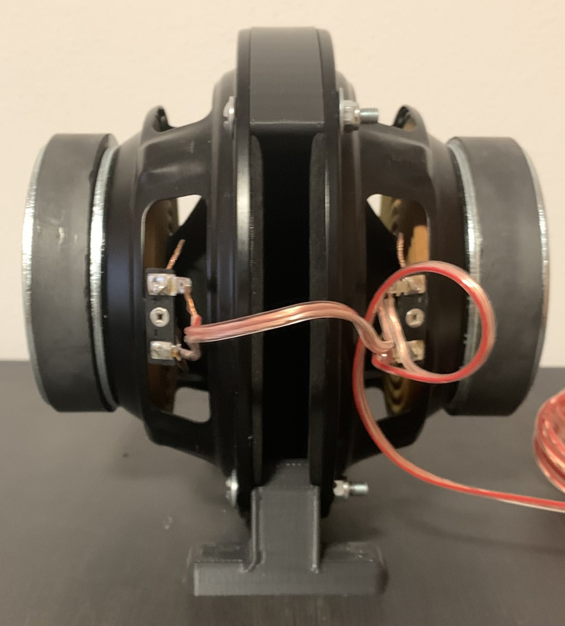

Thanks for the reply I thought it was a compact unity horn it would have been cool if it was the world's smallest unity hornThat is a (partially) unsuccessful project. It is not mounted to the horn. These are two woofers with a 3D printes spacer to form a slot loaded pair. It only works in extreme nearfield.
