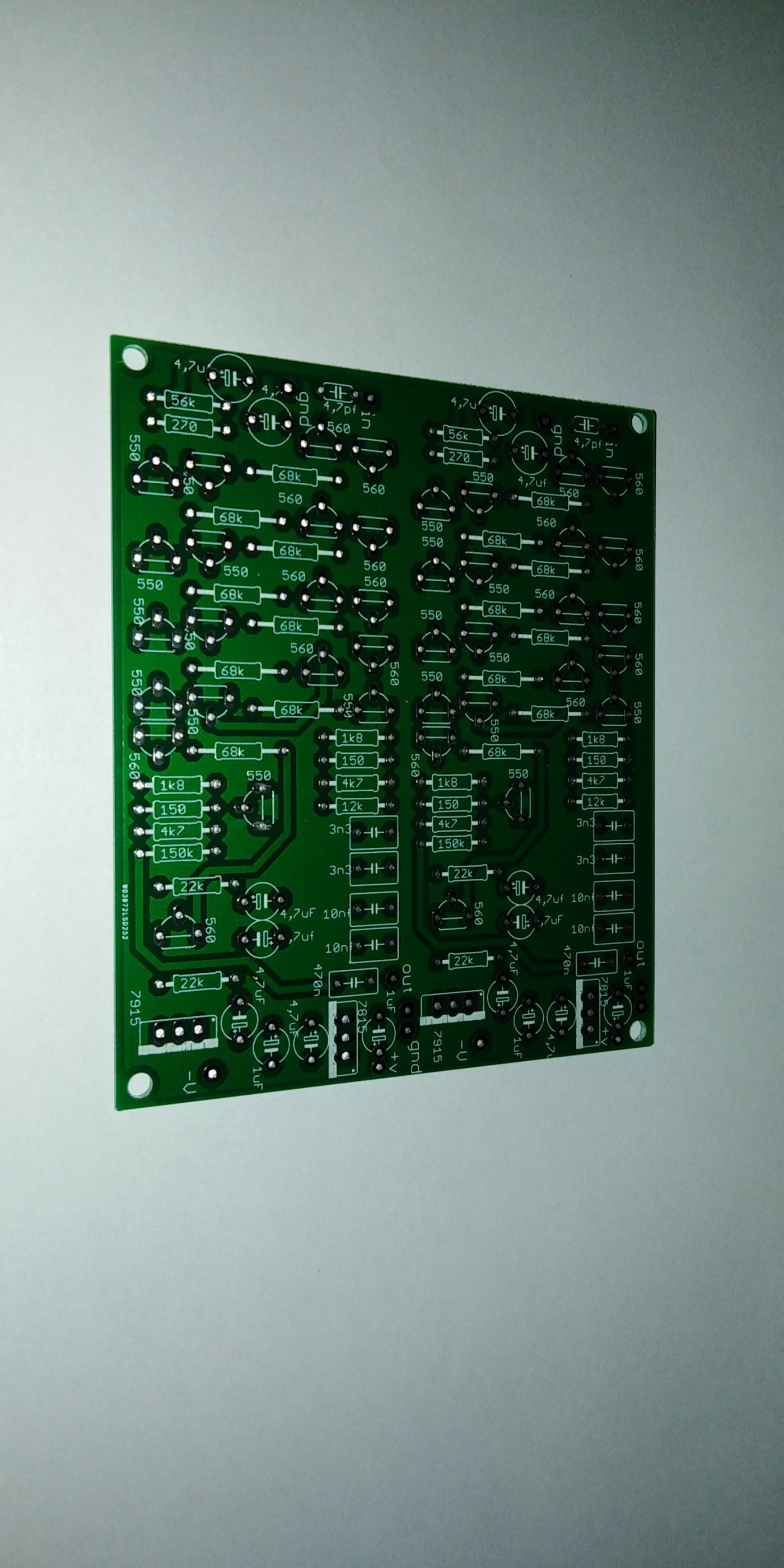

pcb of sln elektor
i've some pcb for sale of thi project on my Eba..

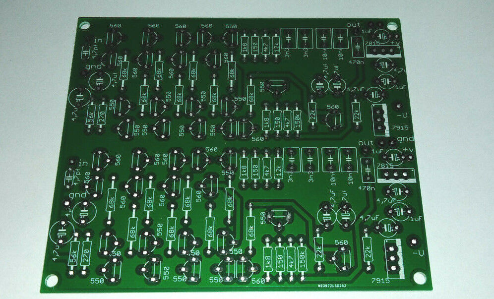

pcb available now...i've some pcb for sale of thi project on my Eba..

another pcb available snl elektor
link to buy :
it will be send to you with black solderesist😱
