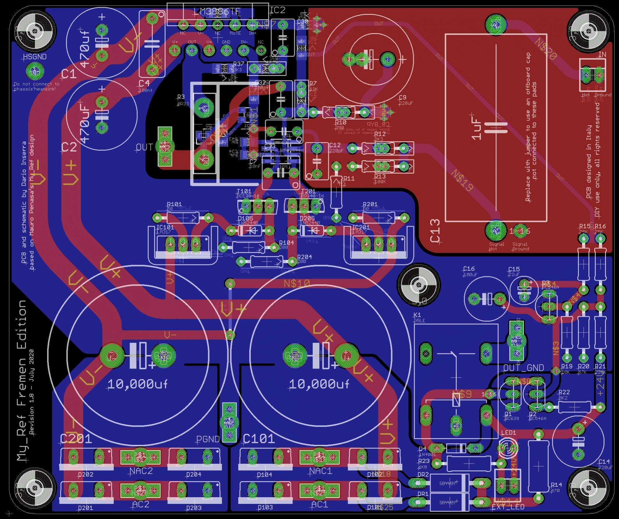

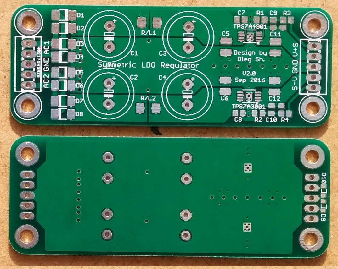

Oleg, can you tell me to which point are attached the ground pin of the regulator (actually where the internal reference voltage is connected to ground) and the same - for the resistor from NF voltage divider?
Regards

The ground pin of the reg is connected to its thermal pad (look at the upper right pin of both ICs) and the ground leg of the feedback voltage divider (left edge of R1 and R2) is right next to the IC package.

Yes, I can see this 🙂. My question is: referring to your electric schematic, to which point of it these pins are attached?
I don't understand the question. On the schematic diagram all ground pins connect to the GND symbol 🙂

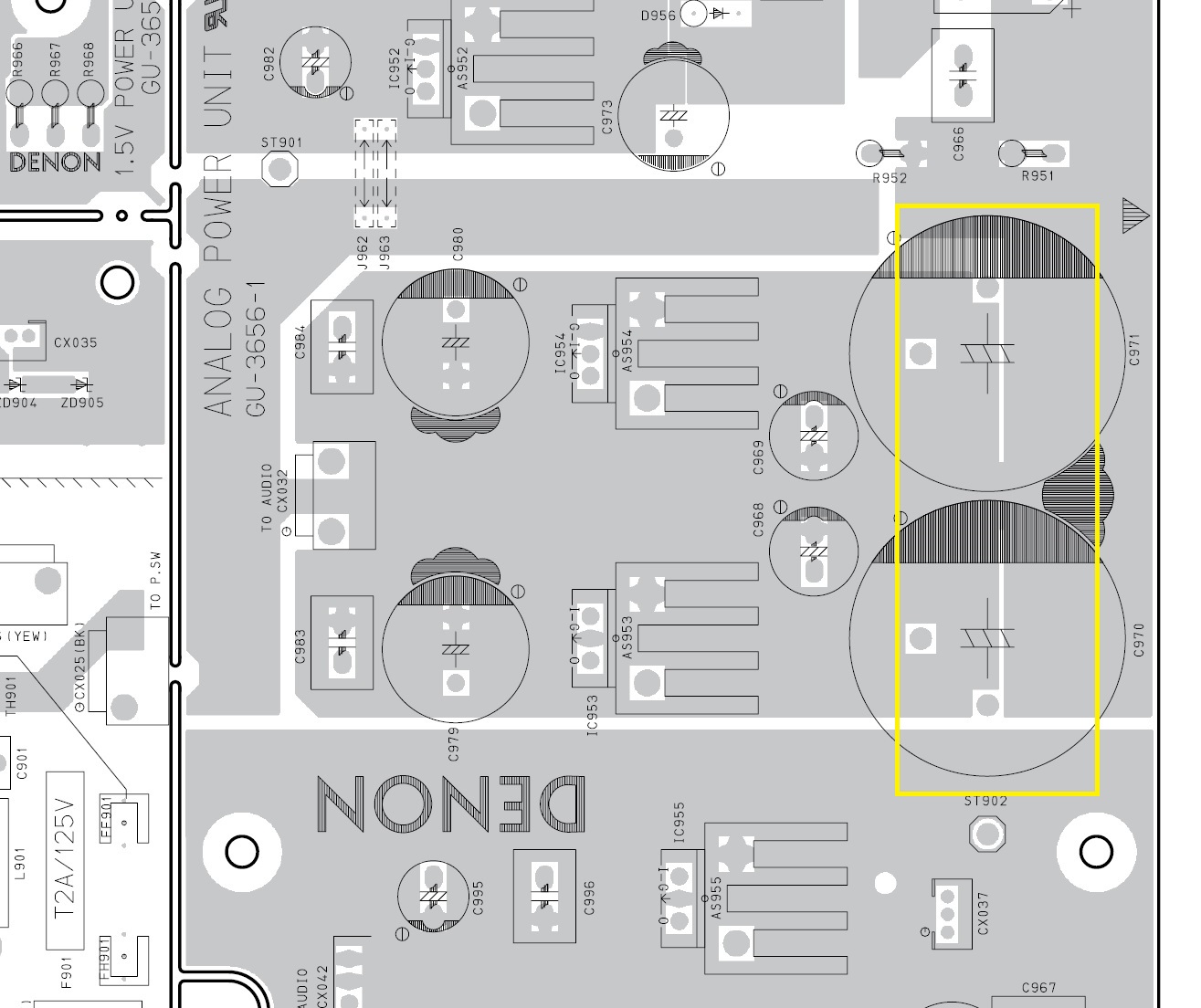

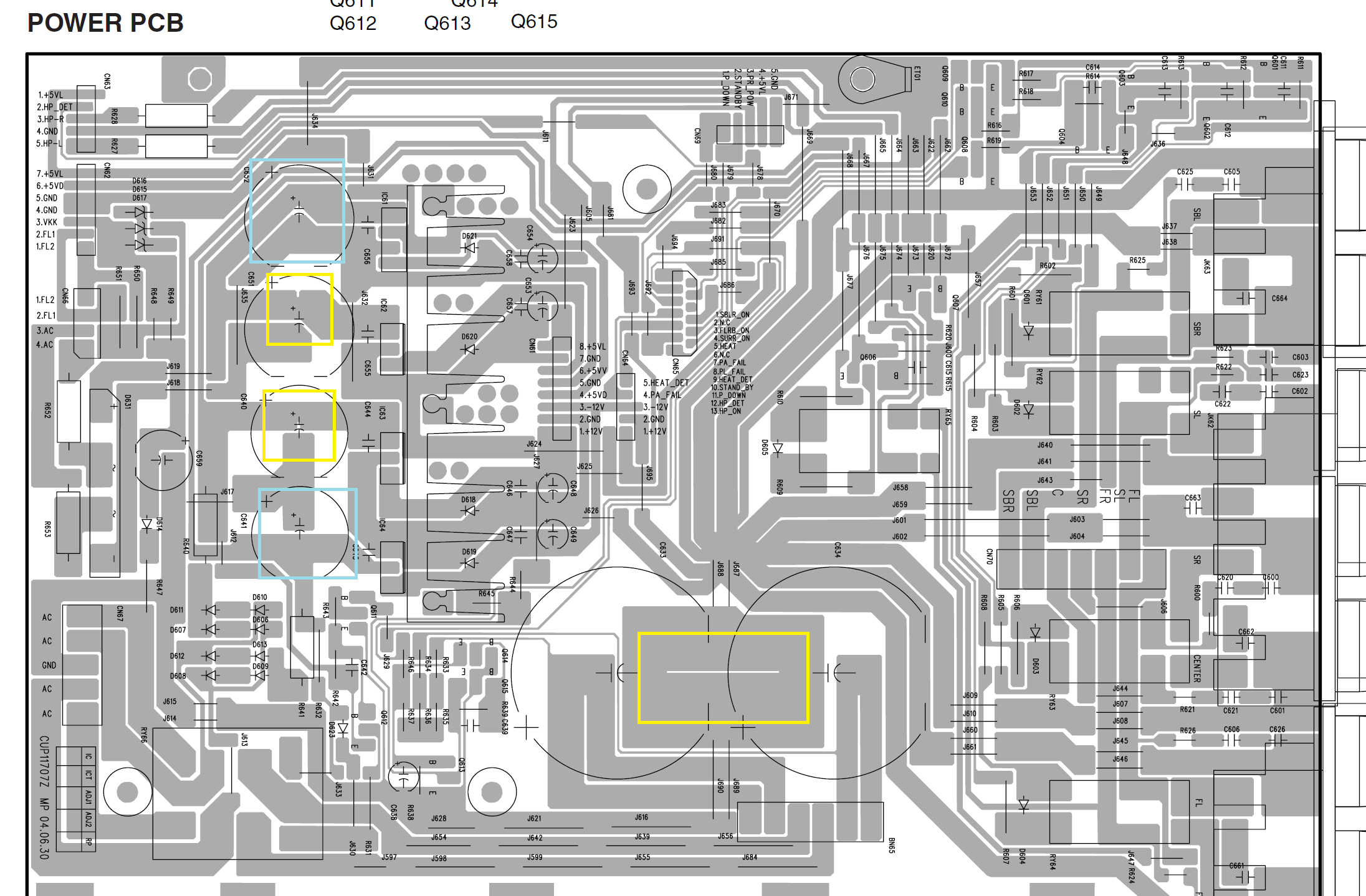

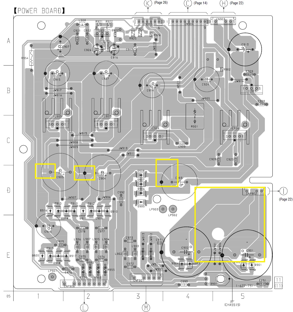

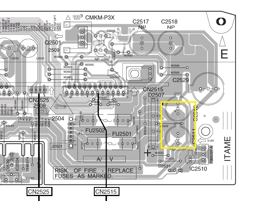

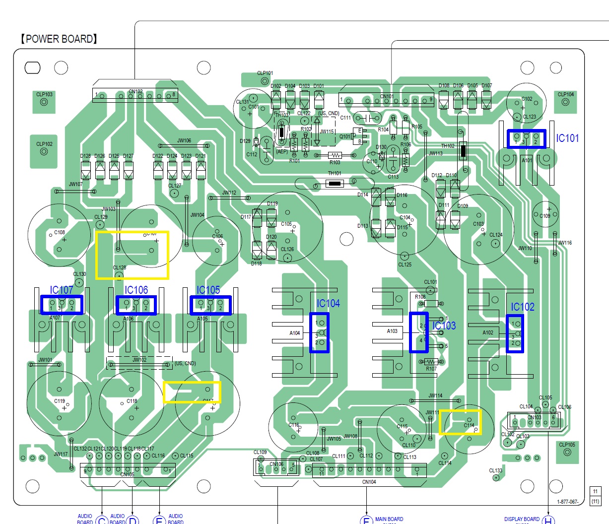

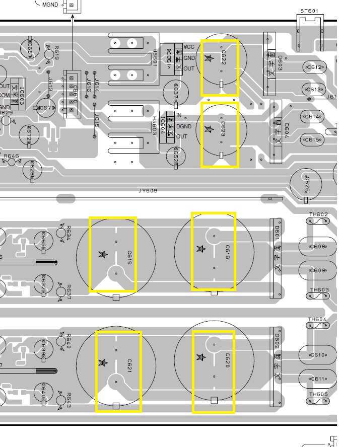

Yellow rectangles show good low-noise PCB design examples.Again, no ground planes, a normal star ground and yet on the ground pour between capacitors' pins they felt a slit was needed...why?
And, also why the slits on the left (in yellow) and other traces without (in cyan)...
🙂 So, according to you, since the GND is on the whole bottom layer's ground plane, there's no difference where the internal REF and the feedback's resistor will be attached.
However, this is not the optimal approach according to the PSRR and noise performance. These two nodes must be attached to an unequivocal and steady point of the ground.
You stated that the currents will follow the least inductance path but I'm afraid it's not always the case. In the past I also thought this is the right approach and just placing a big ground plane for the ground return will do the job until the reality punch me in the nose (badly 🙂).

Am I missing something? Or maybe you are missing something? 😕Yellow rectangles show good low-noise PCB design examples.

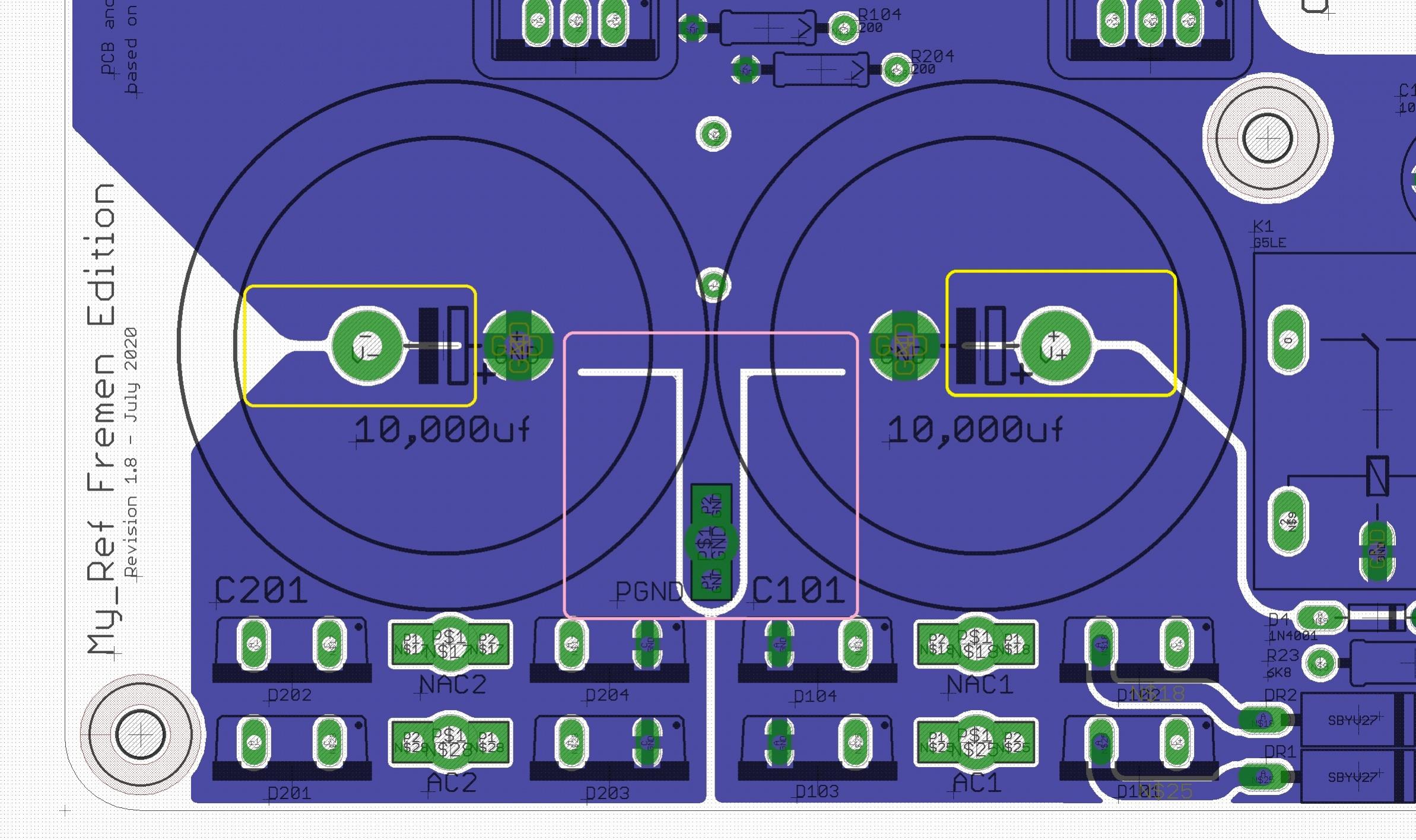

I use those same slits in my design, and I was illustrating to the opener that those were used in several hifi products.
What I don't know is the inner working of those slits, it seems that you know it, can you shed some light on them, on how and why they work?
Thanks in advance 🙂
arpagon, I hope you understand that your PCB is not a generic example and thus you can't generalize your single PCB design experience on any other PCB design. Using the ground plane also needs care. For example if power return path overlaps with the signal return path for an extended length on the PCB an increased hum is not a surprise. Simply using the ground plane and paying no attention to power and signal routing is not going to work well. One should carefully consider a number of factors even if using the ground plane. Often one uses two separate ground pours, one for the sensitive signal area and another for the high power area and connects them in a single carefully chosen point. So there is more to it than just flooding the bottom of the PCB with a ground plane.
Oleg, call me Alex (or Aleksandar), please. Of course I'm not claiming that my board is the ultimate and the only possible design, I just want to stress that when you design a linear PSU, the abovementioned nodes (ground connections of the Vref and the NFB divider) MUST BE connected to a well-known steady point from the ground return path, not "in the middle of nowhere" where is the case with the simple ground plane. The ground plane can be more or less acceptable when the currents are low but once the currents go high, the problems with the ground plane appear.
Choosing the right point for the star center ground is also a bit of magic 🙂, but in a case of bi-polar PSU I suggest an artificial point as closer as possible to the output terminal's GND pin.
For uni-polar PSU this center must be attached to the ground leg of particular filtering capacitor, can you guess which one is the right choice - the input capacitor after the bridge rectifier or the one on the output?

Current has to have its way only through a capacitor pin, but not far from pin. We can't put cap pins everywhere we need, but we may move PCB wires so they led current through a cap pin.What I don't know is the inner working of those slits, it seems that you know it, can you shed some light on them, on how and why they work?
Its all electrickery.
The main object with star ground and copper pours is to screen and keep high/medium power return paths away from small signal paths.
The high power stuff modulates the ground and if not laid out right the small signal ground too.

Thanks for the answer 🙂Current has to have its way only through a capacitor pin, but not far from pin. We can't put cap pins everywhere we need, but we may move PCB wires so they led current through a cap pin.
So I was not far:
Nevertheless it made sense to me (I've seen it as way to make the capacitors more effective) and so I've did the same.
Still no word on whether split plane for voltage return positive and voltage return negetive is better or not.
My hunch is that because the positive and neg supply rail modulate the current ever so differently, if their grounds r shared their modulation will fight eachother and affect their output whereas when split til the rectifier return the modulation will be contained and the overall ground quieter, tho with higher impedance.

Dario please have a look at AMP???? Amp Repair Studio. Its evident from photo documents that even the japanese high end gears all used the same slit and split tracing as you showed earlier here. Sansui au-11 for example splits the ground plane all the way down to the rectifiers. I dont believe these japanese designers of the yesteryear were novices. Quite the contrary infact, and as we've been reinventing the wheel we probably chose to forget some of the details that mattered to these people.
