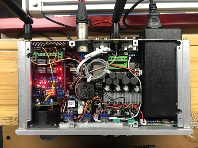

Has anyone looked at the Arylic devices?
I built a class D 2.1 multiroom amp with their up2stream amp2.1 in an old mini-PC housing, and I must say it sounds absolutely fantastic!

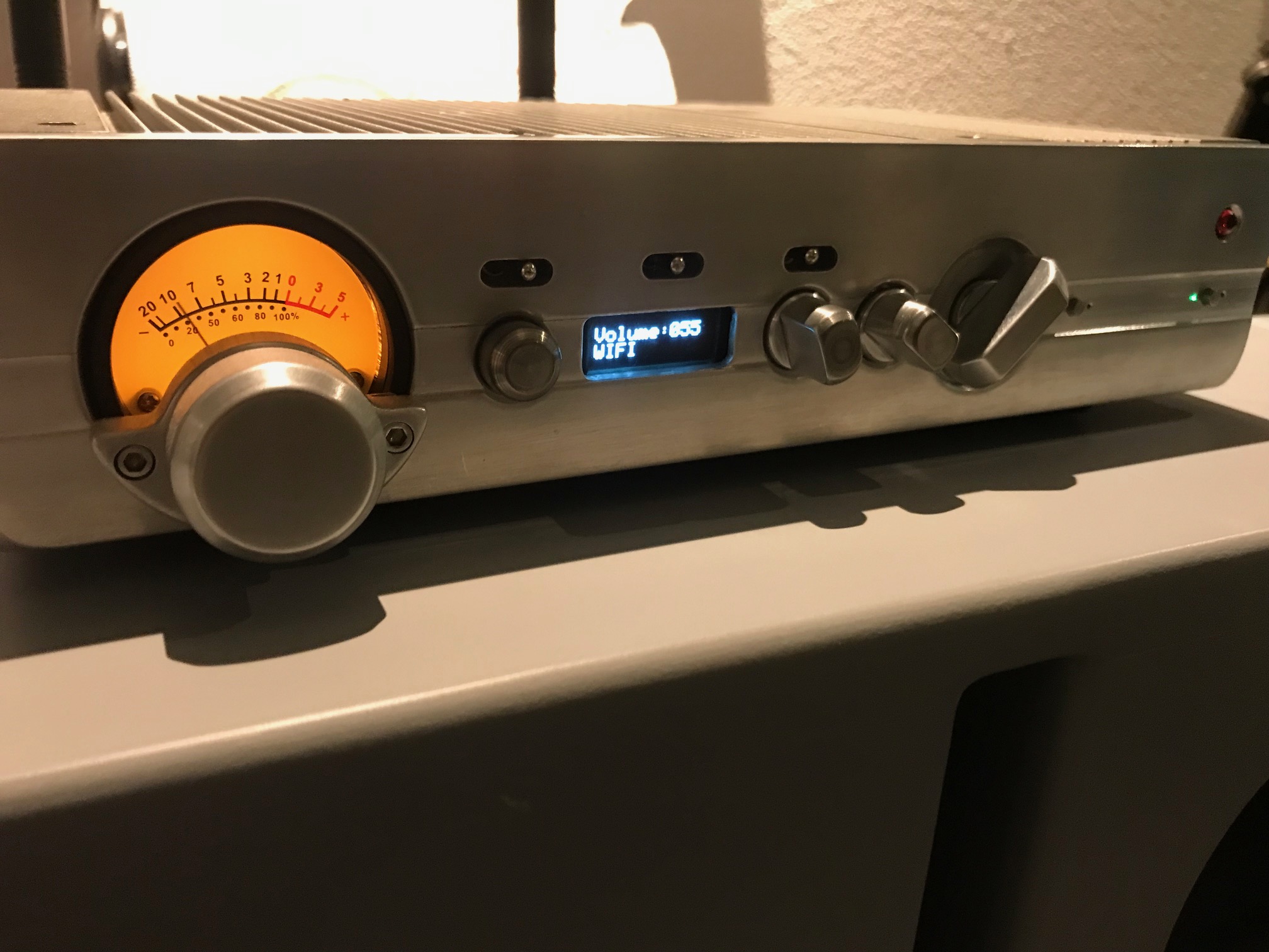

I managed to figure out some of the serial commands and handshake between the Linkplay board and a up2stream_amp2.1. The board is built inside an old mini PC housing with a new DIY frontpanel and all parts are home-cut. (some design features are stolen from a high-end brand…:)
11.jpeg [/ATTACH][/ATTACH]
An Arduino is translating the data to text strings. I also added some buttons for on/off and mute. The VU-meter and other hardware is eye-candy…
