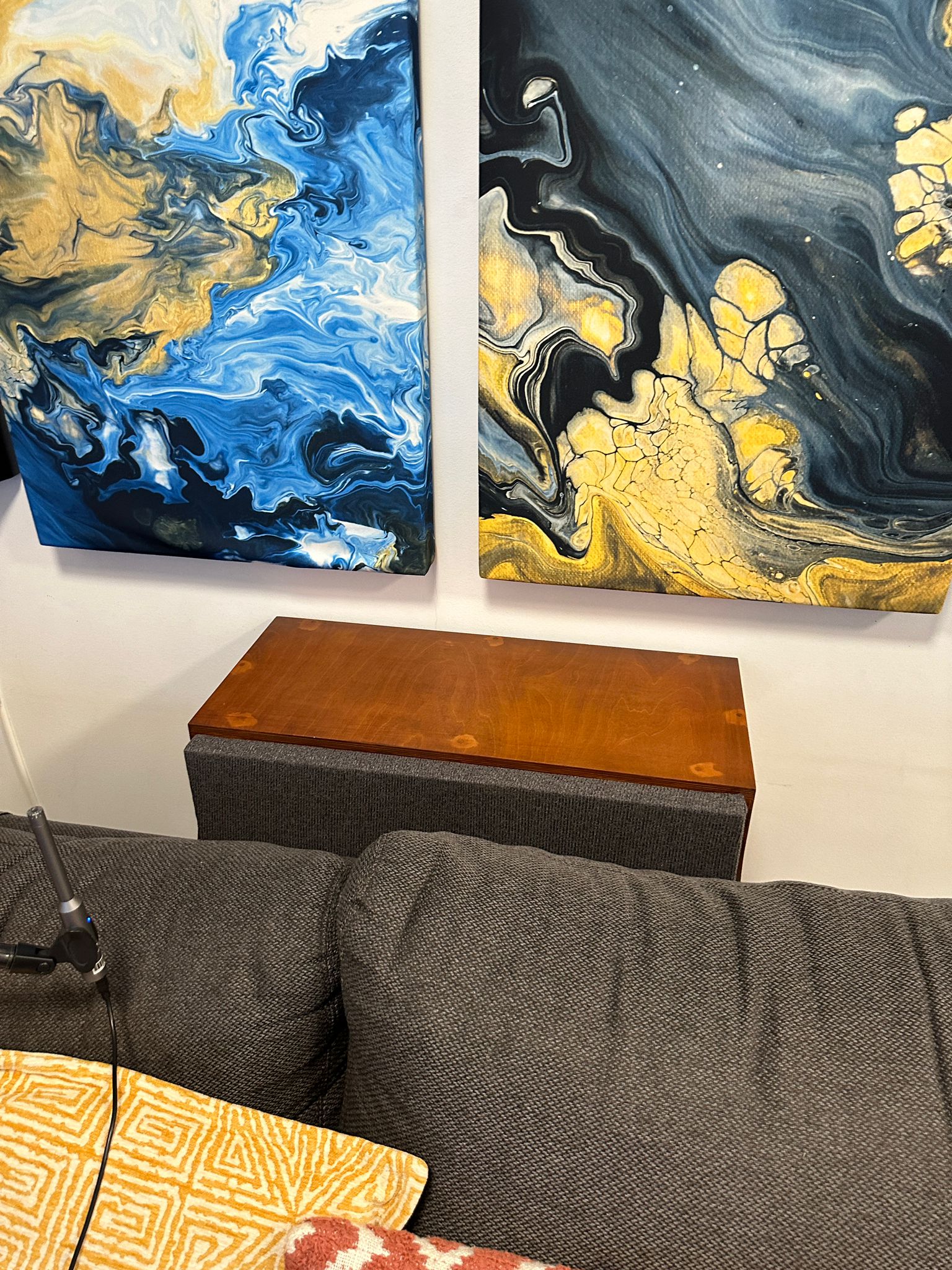

This is my current room (see attached image). I have a space behind my sofa (if moved forward) that can accommodate an enclosure/s up to a combined total of: 118" wide x 14" deep x 31.5" tall (about 30 ft3) - however this space also needs to accommodate the amplifier.

I'm not seeing how you're going to move the current sofa out by over a foot without seriously impacting traffic flow through the room. Are you going to remove the L part of the sofa to do that? If that is the plan, you could also leave the straight part of the sofa where it is and replace the L part with a subwoofer built into a coffee table (assuming you have the skills to finish to that level).
Another option may be to put a sub under the dining table. From your diagram it looks like you may be able to fit something against the wall there. Obviously that assumes there's a mains outlet there. The signal can be handled wirelessly.
Thanks for the reply.
The sofa already sits about 8" off the wall as I've got a little stand back there for drinks. I can also move the TV cabinet back by 6" easily so hopefully with an increased distance to 14" it won't impacting any walking space.
The sofa will be staying in its current configuration and no plans for a coffee table. Unfortunately the idea under the dining table is also a no-go, we move the table out a lot when friends come and it just isn't feasible.
So, for now I'm going to continue pursuing the idea of a sub tucked away behind the sofa. If all else fails, I'll just put a subwoofer where the PC4000 used to be.

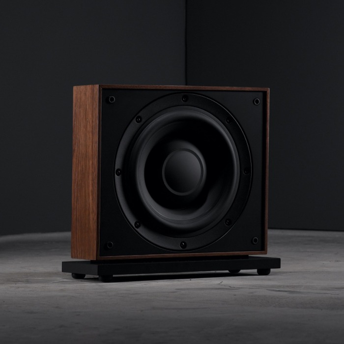

Maybe something like this
https://www.leonspeakers.com/residential/series/aaros/a10-ut
Small, compact, closed box ... but you will have to use DSP to apply linkwitz transform
It is using SB acoustics shallow subwoofer 10' SW26DBAC76
https://sbacoustics.com/product/10in-sw26dbac76-8/
There was dual voice version, but I think 8 or 4 ohm would do the trick just fine...but, I'm not an expert 😉
Any way, this SBa shallow subwoofer + hypex FA501 plate amplifier with DSP would fit into budget and mide be what you looking for.

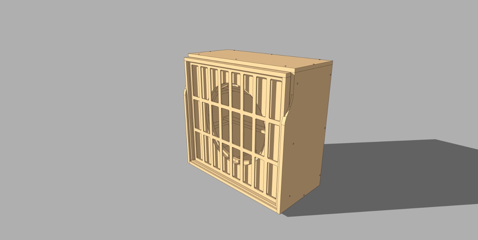

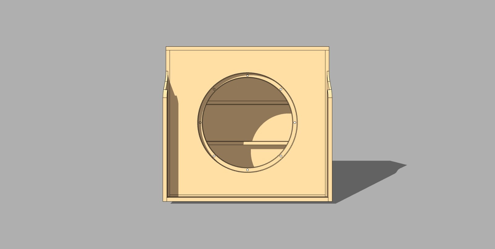

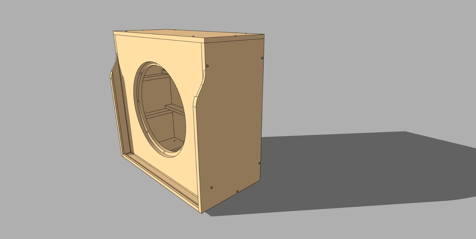

Hello again,
After a busy year, I'm back!
What MrKlinky said about moving a lot of air gently really struck a chord with me. As such I decided to go with 4 x 18" nearfield subs. Towards the end of 2022 I worked with someone to design a relatively slim sealed enclosure that would go behind my sofa. The idea is to have 4 of these in a row as nearfield subs. The subs are going to use BMS 18N862 drivers.

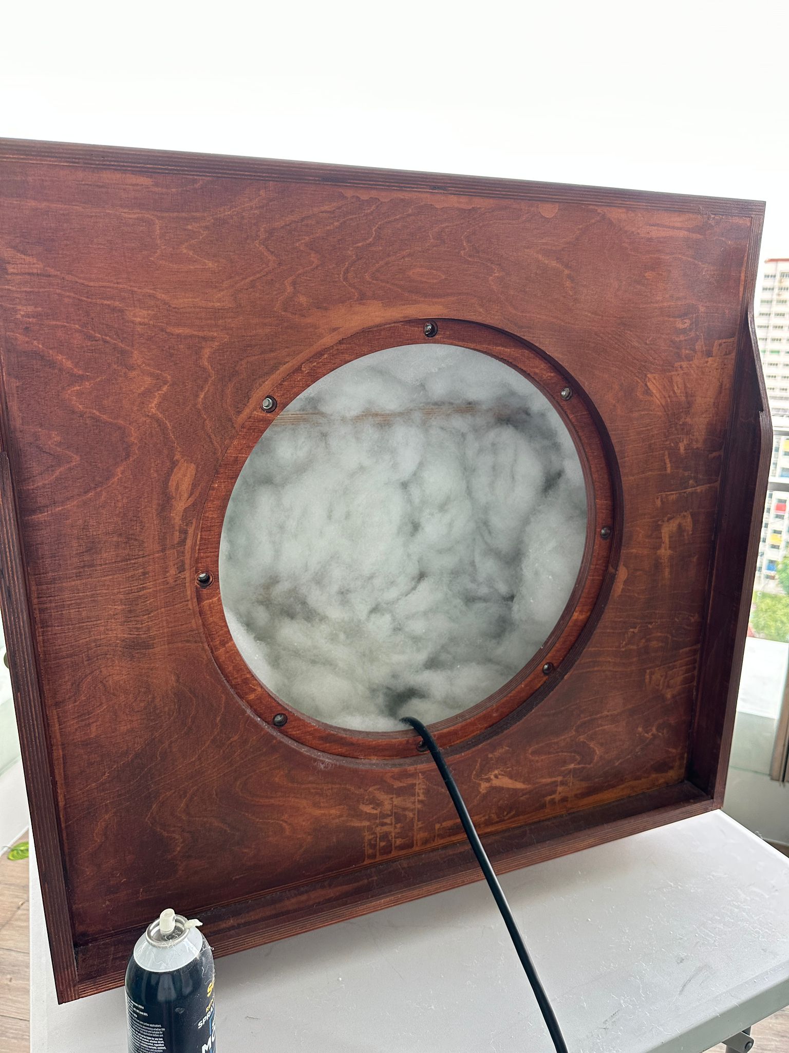

I've just got the first one built and it's woring fine. However, then I put my hand on the cabinet there's a slight vibration. It isn't audible and it isn't causing any problems, but it's more that you can feel the pressure of the driver compressing the air inside the box.
Is this normal or should the box be more inert with no sense of movement?

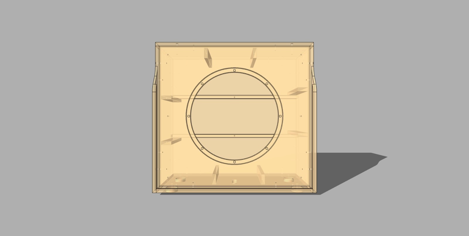

The box is made from 18mm baltic birch with a double front baffle. It's screw'd and glue'd to high heaven and there's internal bracing too. I've also stuffed the box with polyfill and have run sealant around all corners of the box interally. The box is definitely well sealed.
So, I'm unsure about the vibration which I'm feeling in the box. I'd say there's a relatively equal vibration on the top, the sides and even the back. It isn't horrendous, but it's enough to notice it when you put your hand on the cabinet.
What do you think? Does it sound ok or do you think there's an issue?

Short answer: I think you're fine. If it sounds good, it is good.
Longer answer: Even on highly braced, well reviewed speakers that sound like you're knocking on a solid block, you can still feel slight vibration once you get above background listening levels.
In a subwoofer, the panel resonances tend to be higher frequency than the pass band, so they're not excited to a high level. Being lower level, they're also more likely to be well below the level of the main speakers. You often see commercial subwoofers of good quality with minimal or no bracing.

Thanks for the reply. I soldiered on today and started testing, MiniDSP'ing, REW'ing and Dirac'ing.
Once everything was EQ'd the vibration on the panels of the box greatly reduced.

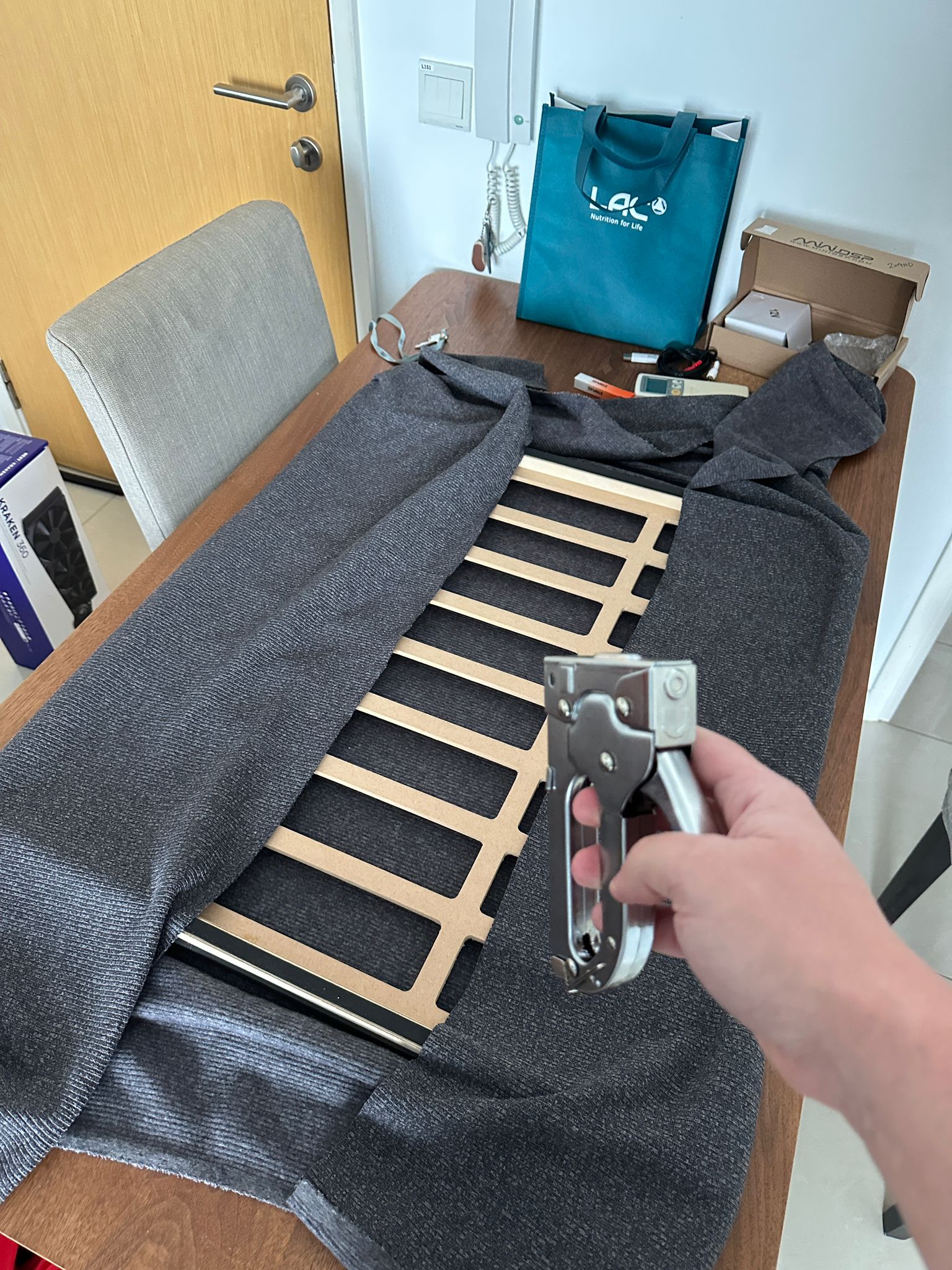

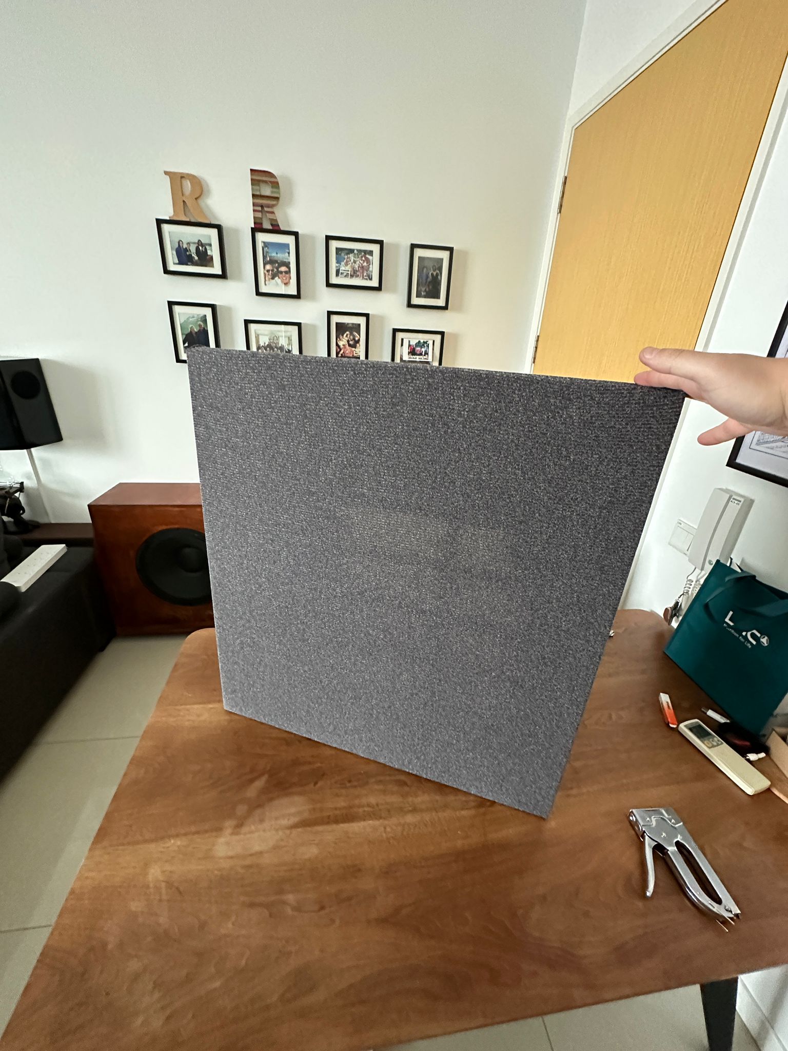

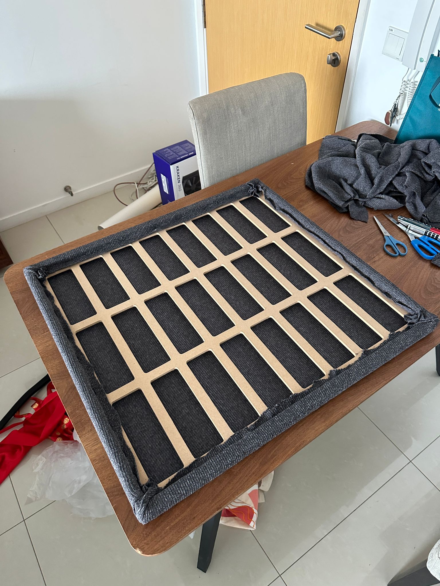

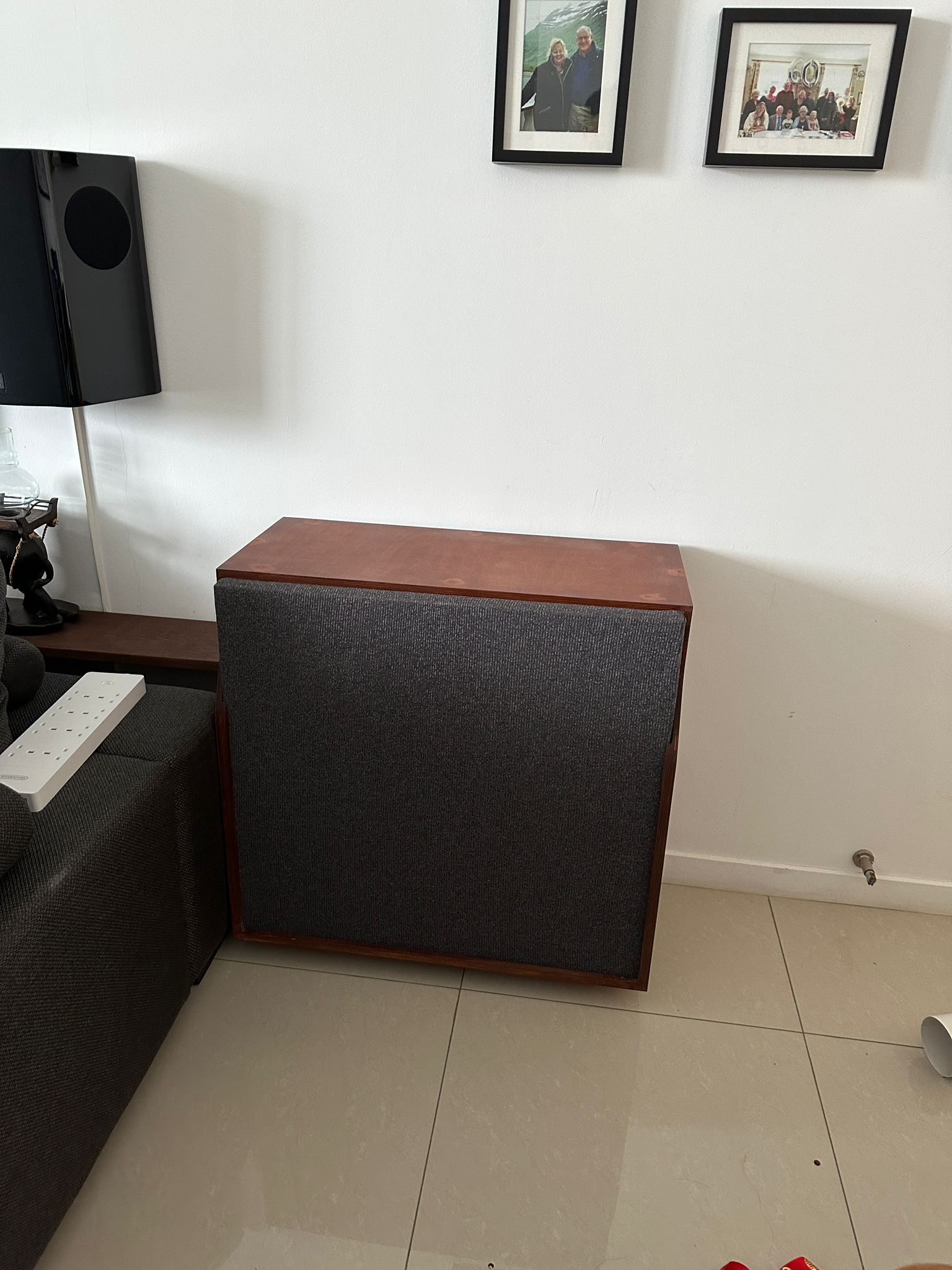

I must say, the thing which I was most satisfied with today was how the grille turned out. The box is designed this way so that the sofa can safely push up againt the box without it touching the driver and to ensure the driver has enough room to breathe. I used gasket tape diretly on to the wood then wrapped it in an acoustically transparent fabric. It was so snug and couldn't move at all, so zero rattle!
I must admit, having tried to stain baltic birch, I'll never do it again. Next time I would fill in the screw holes, then probably paint or vinyl it as it currently looks a bit of a mess. Thankfully as it's tucked behind the sofa the wife will let me get away with it.
It may not be slim by some standards, but considering it's an 18" driver, the box being 37cm deep isn't too bad! My sofa has only moved forward about 15cm compared to before.
So, how does it sound? Well, this is just one box so far, I need to make another three, but I've never felt bass like this. It's so tight, deep and fast. It just sounds so effortless, and as it's nearfield it really puts a lot of energy in to the sofa with a satisfying rumble without being too overbearing.
