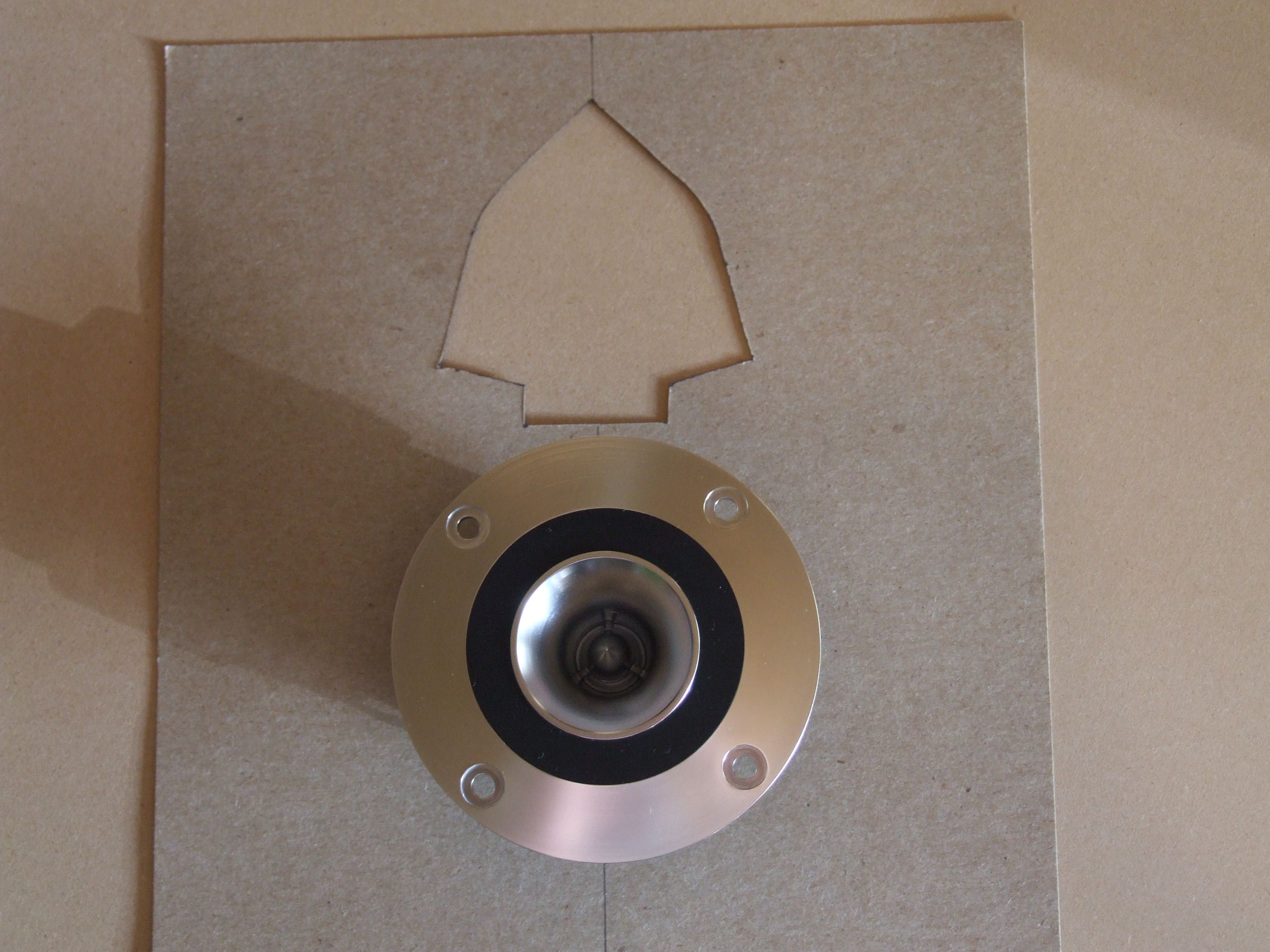

I don't mean to contradict you entirely, but I'll share what I've learned recently.
There have been at least a dozen proven builds with these drivers over on the partsexpress forum in 1 or 2 driver configurations with the same tweeter that was recommended to me. These guys have tested these drivers in MT and MTM configurations. The one I'm going to be going with is a .55 cubic foot floorstanding box tuned to 39 hz yielding an F3 of 38hz.
These drivers are producing so much bass at such low frequencies that people have had to double check that their subs are indeed off when testing. It has been done, and the sub isn't needed here, although I do have one for use if need be. The thread containing all of this information was posted a few posts up.
I know a bit about "super tweeters." I definitely like the idea of using a horn loaded tweeter as a super tweeter, because a horn tweeter has a constant power response, but it's a big mistake to not attenuate the tweeter. Horn tweeters are often in the area of 94-96 dB SPl and small full rangers are way, way lower. Now some people think adding resistors is anathema, but if you are going to use a passive crossover (capacitor) then what's the matter with using resistance too. In fact I really like the idea of an adjustable L-pad for use with a super tweeter. Select the crossover capacitor/crossover frequency first then dial in the amount of attenuation needed.
One of my all time favorite super tweeters is the AUDAX TW74A/TW010F1
The L-Pad is one way to do it. The way i decribed is also valid. The tweeter is attenuated, but by being tricky.
As an example lets consider a tweeter that is 6 dB hotter than your FR and you want to XO it at 15k. A 1st order XO attenuates at 6 dB/octave so if we XO at 30k then at 15 k it meets up nicely at the XO point. Works really well.
dave

Typically a super tweeter is used at a slightly lower frequency, maybe 10-12KHz. 15KHz would be too high of a frequency for some of the guys with hearing loss. I'm pretty sure I don't hear past 15KHz any more, however my overall hearing sensitivity is still quite good.
Further it's not difficult to imagine a horn tweeter being even 10dB louder than many a small full ranger.
Your method leaves you with a rising response even off axis.
As you have to cross lower, you may have to take on a different strategy. i have successfully used it down to 10k.
Even the guys with hearing loss, i believe, can often benefit from extension beyond what the sin waves mention.
If the tweeter has a larger differential then you cross over higher. One local installation had the XO set at over 50kHz to get the T900 down to match the FE206eSR
On the last, 2 factors make this doable. The tweeters have a natural fall-off at the higher frequencies, and our ears get less sensitive this high up.
If it works for you great, if not try something else. I like to avoid L-Pads.
