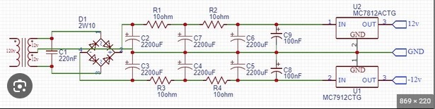

In my AlephX there is no hum with a CRCRC capacitor bank.

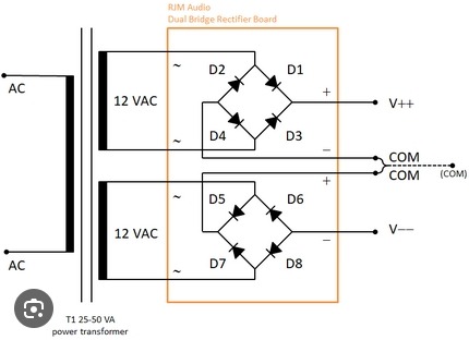

I also updraded it with a dual bridge rectifier to eliminate the tiny bit of hum.

Please, forgive my ignorance but, what's a CRCRC bank, how is it made? Is it the typology suggested in DIY Aleph 3 scheme or it was you to implement that in your gear?

Here, you can see that after the rectifier there are 3 banks of large 2200µF capacitors with resistors in between.
Adding these resistors greatly reduces ripple. That's a C (cap) R (resistor) C (cap) and so on, bank.
There was some slight hum in the original AlephX. Nelson's tip to add a dual bridge solved it almost completely.

A dual bridge can only be made if the transformer has dual secondaries.

Netlist.... that is not a power supply for the Aleph 3. Appreciate it shows the principal but with a 1.2A bias those 10 ohm resistors between the caps would be dropping 12 volts each not to mention how much power they would take. I have a clone of a well known class A amp, single supply rail and single ended. It does have a small residual hum, very annoying. It has dual supplies with individual rectifiers and increasing the value of the smoothing caps made virtually no difference. I put up with it because it sounds so good.Here, you can see that after the rectifier there are 3 banks of large 2200µF capacitors with resistors in between.
