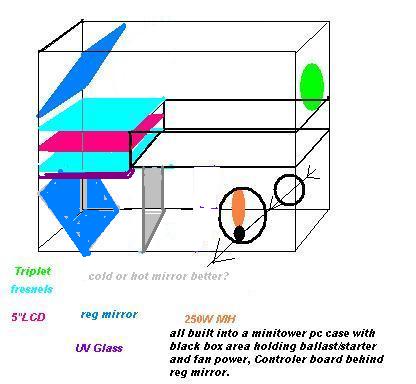

think the only parts left are reflector behind bulb, mirror to bounce light to fresnel (cold or hot?)
UV and IR filters
Idea's?
mirrors & filters
If you want to bounce the light off it, then it has to be a cold mirror. The only reasonably priced cold mirror I have found is surplusshed's $5 4.75" diameter cold mirror. All the rest I have found are much much more.
Hot mirrors are much easier to use, since you can fit a small one into a straight light path. There are also lots of sources for cheap and not-so-bad hot mirrors.
For UV filtering, you can buy UV filter sheets at some of the DIY projector web stores for <$10, or you can just use Lexan XL10 to support your fresnels. Lexan XL10 is sold at Home Depot as window glass replacement and has a great UV blocker built in.
so then, your not using a Hot mirror to reflect the Driver light(light for LCD) but bounce the HEAT Rad back, so this could be placed just before the 45* cold mirror bounces the light to the fresnels for the LCD. then use the Lexan to filter UV at the fresnel.

hot & cold
Yes, that is how hot and cold mirrors work. But you don't really need both. If you put a good hot mirror across the light path, then you don't need a cold mirror. You could use a first surface mirror (or even a standard mirror before the LCD), which is much cheaper than a cold mirror. (Also you have to keep in mind that every mirror will lose about 10% of the visible light. )
On the other hand, if you can actually fit a cold mirror in the light path, and find one you can afford, then that has some real advantage over using a hot mirror: You get to direct all the heat to the area behind the cold mirror, where it can be absorbed by a heatsink and then removed by a fan.
In my projector, I use hot mirror to bounce the IR back toward the lamp, and I use Lexan XL10 to support my fresnels which acts as a UV filter.
