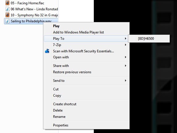

Hi All,
Thanks for all the information. I am getting hooked
Setup updated - decided to bring a PC into the "picture" for tests.
Configured Win7 for DLNA/UPnP and was able to discover all devices. Then with Window Media Player, was able to stream music from PC into the Samsung Gear 🙂 - No mapping of drives
Possibly I can test the EDEL-NMR this way
Final setup will be using mobile devices only

Control Point at the Blu-Ray player using its own remote

Win7 PC as a Control Point succeeded. So network is fine. Found this useful:
