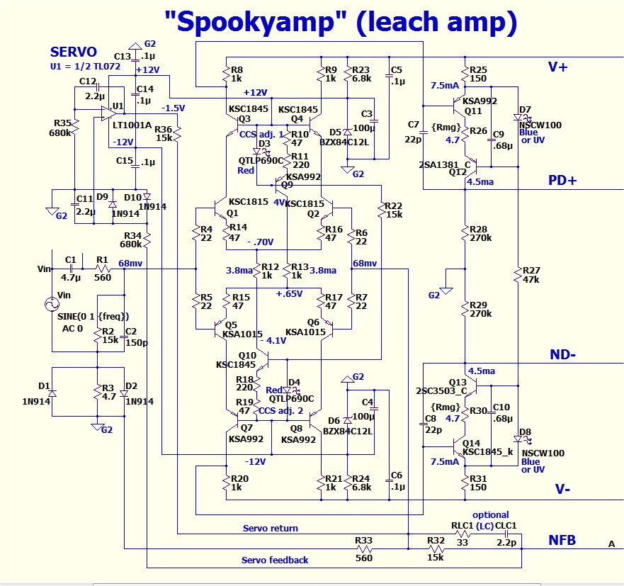

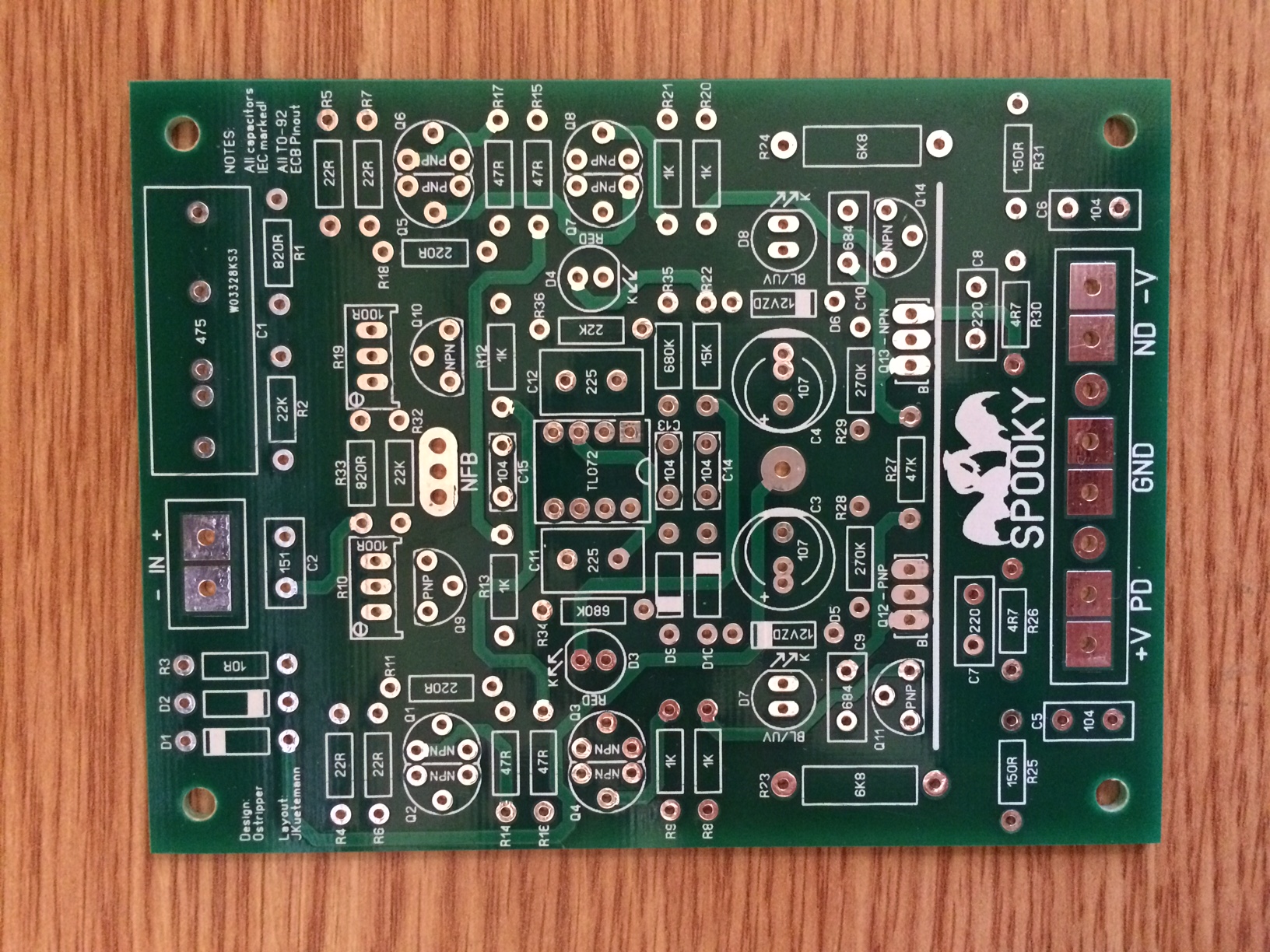

I used your files to have the 5P OPS and Spooky IPS manufactured in China. After brief inspection I found that the Spooky IPS doesn't match with the schematic I have. Which version did you use to do the layout? A few examples of what is different:
R3 = 10R on PCB, 4R7 in schematic
R32 = 22k on PCB, 680k in schematic
R33 = 820R on PCB, 680k in schematic
and so on. I even see connection differences, not only component vales.
I obviously have a wrong (outdated) schematic, but can't find any other version.
Thanks for help.

A few values were changed to make for a better 'match' to the other designs so things were more standardized. This was a personal call I made in ostripper's absence. All the values on the silk are functional, this has been verified with actual builds. You can build by either by the silk or by the schematic and have a fully functional module.
I have attached the v1.2 schematic that I used during the layout process.
Thanks a lot Jason,
it makes sense with the new schematic. I missed it somehow.
I guess I'll go by the silk.
