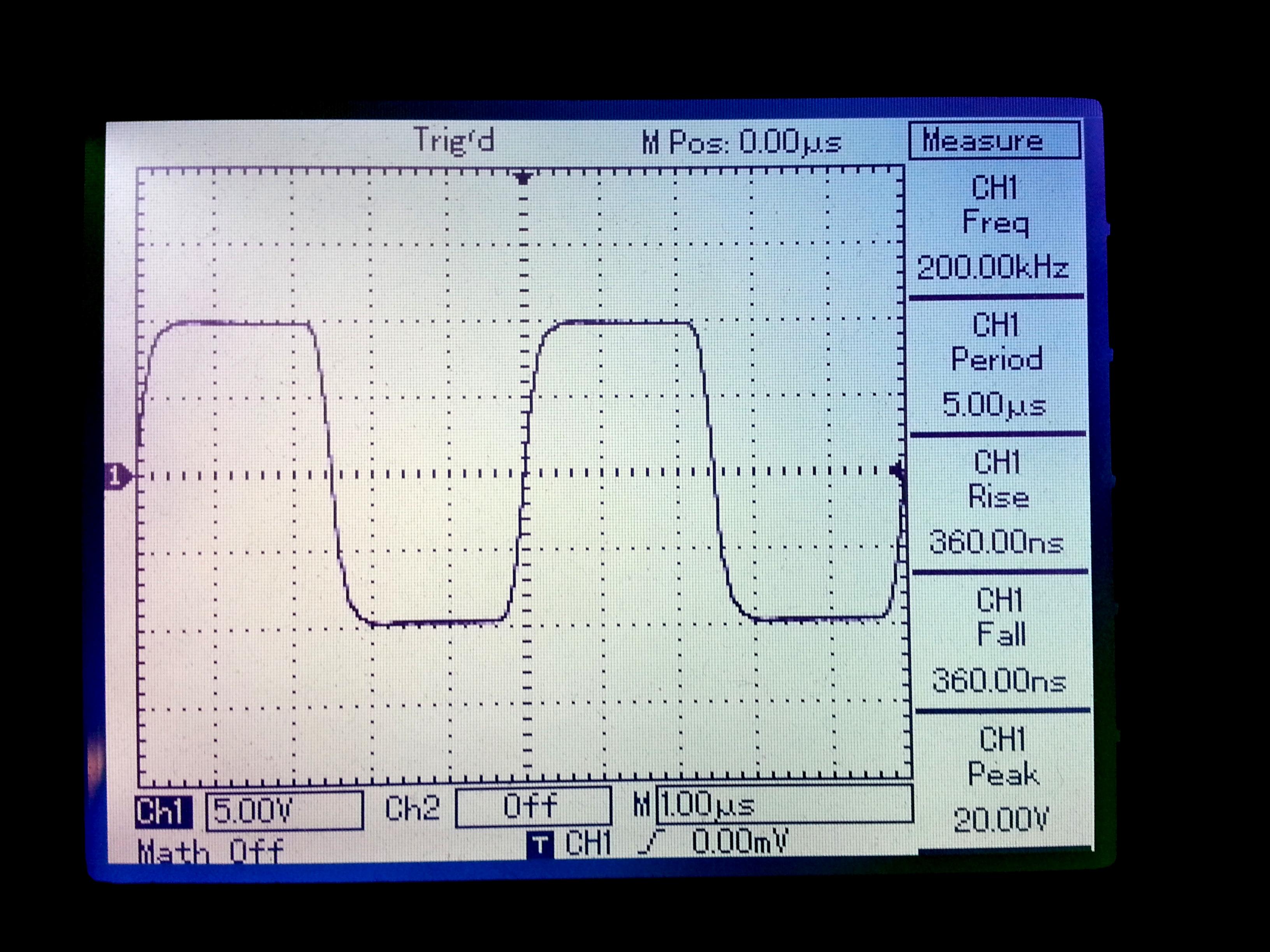

Can you give us a direct foto with load 4Ω - scope wave at 200khz . 20V p-p ?
Higher than 20 Vpp at 200 kHz is not possible in my setup since that would overheat 3 W SMD zobel resistors on my PCB. Zobel filter alone has 16 Ohm impedance at 200 kHz.
What about foto with load 4Ω - scope square wave at 200khz . at 20V p-p as you say ?
Look thimios how 200 kHz square waves under load should look from good CFA. You still have to do some work on this design hehe
My 200kHz @ 20V p-p (4 Ohm)
Yours is still a bit better, but I still have some room for fine-tuning
360 nS rise/fall looks not bad IMHO

Thimios try to low the c2=47pf c10=5.6pf c9=5.6pf like Lazy Cat, no input cap =Good Gen with zero offset and you get 200khz .

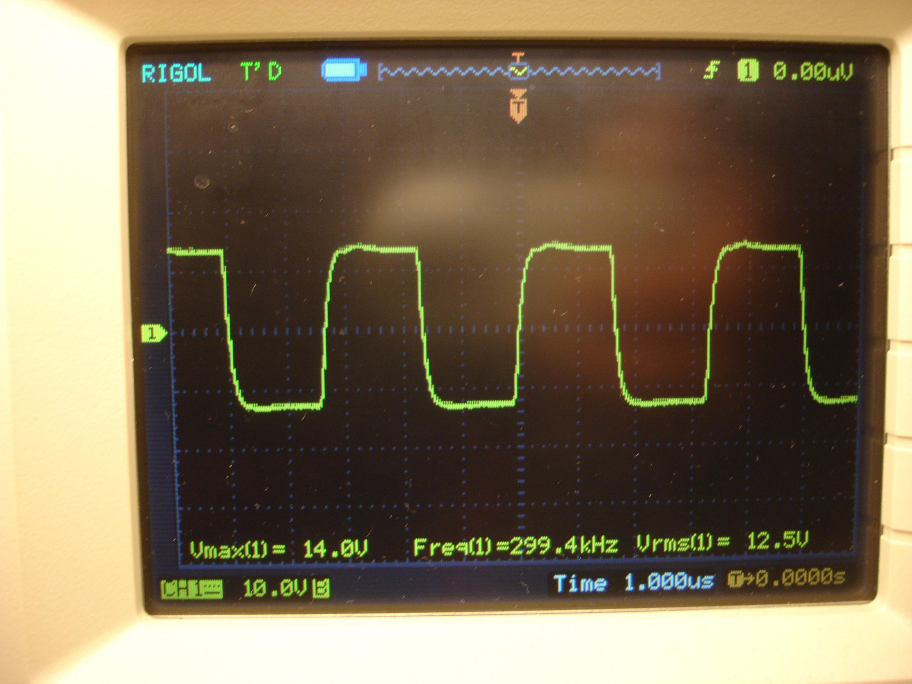

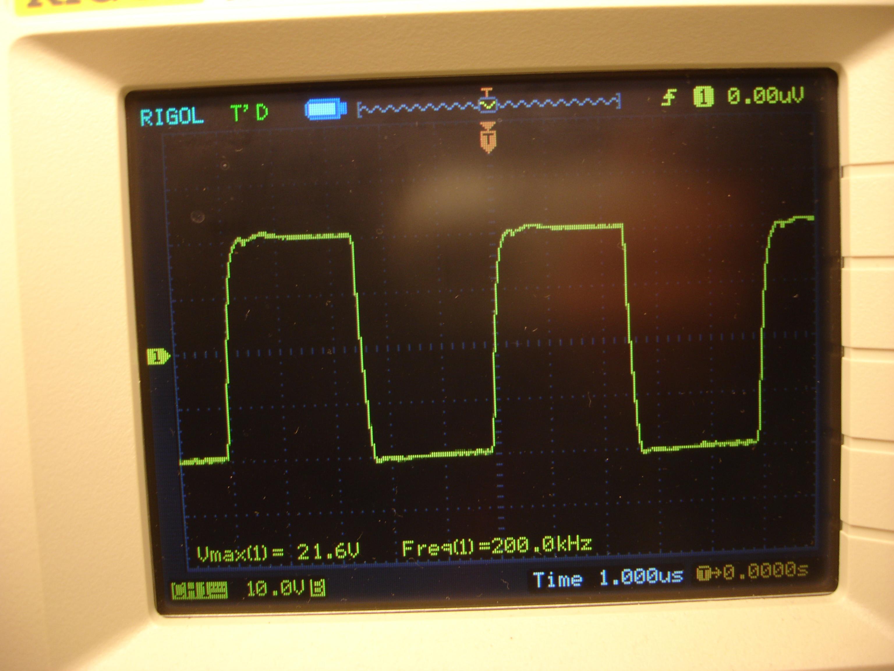

Here it is ....1)300KHz/4R DUMMY LOAD.
2)200KHz/4R >> >>
3)500KHz/4R >> >>
But how make it so fast do you have new PCB layout , do you bye new parts, do you raise the bias current or change compensation scheme ?

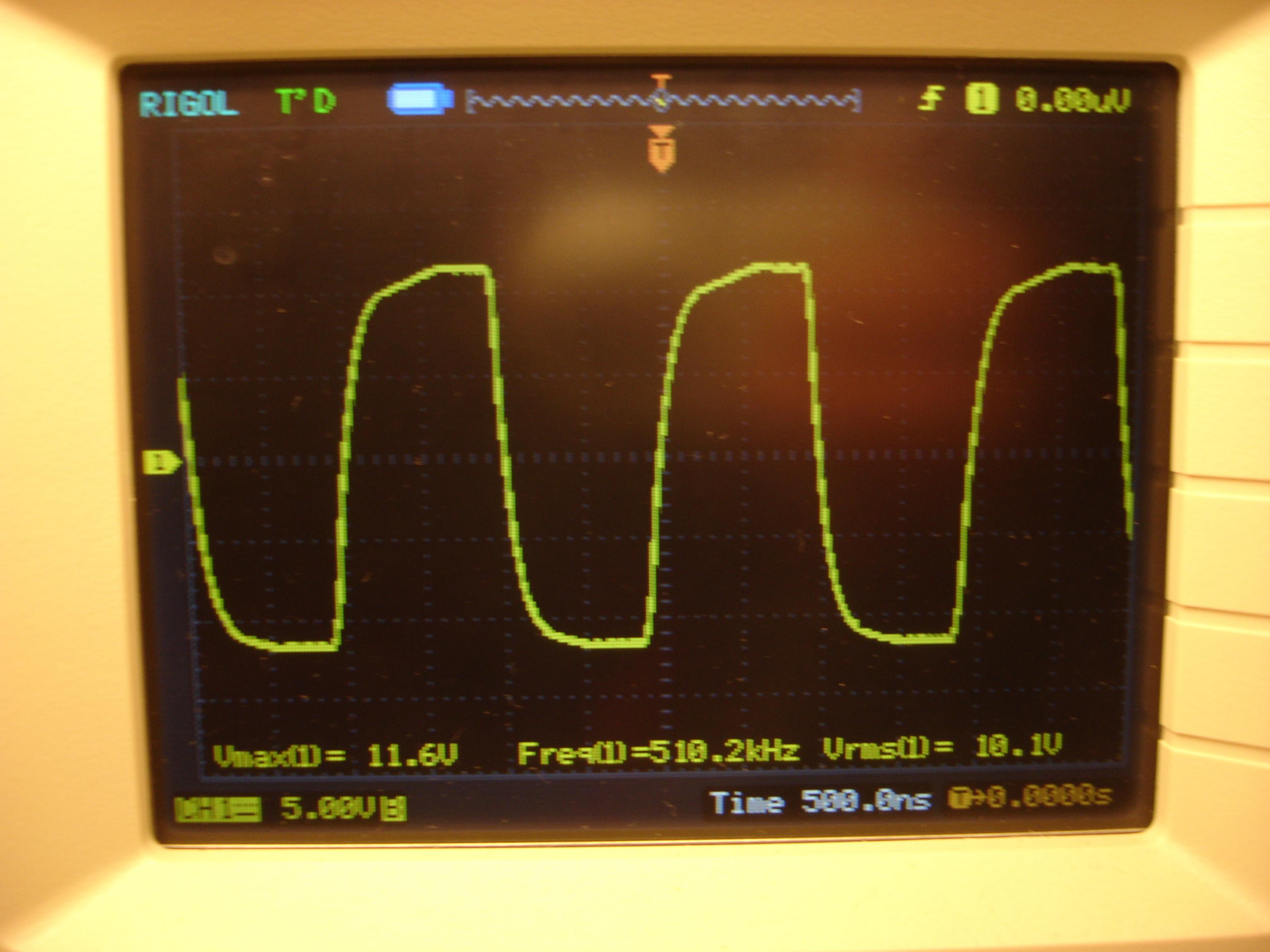

My <<NEW>> amplifier......
I tried Bimo suggestions.
