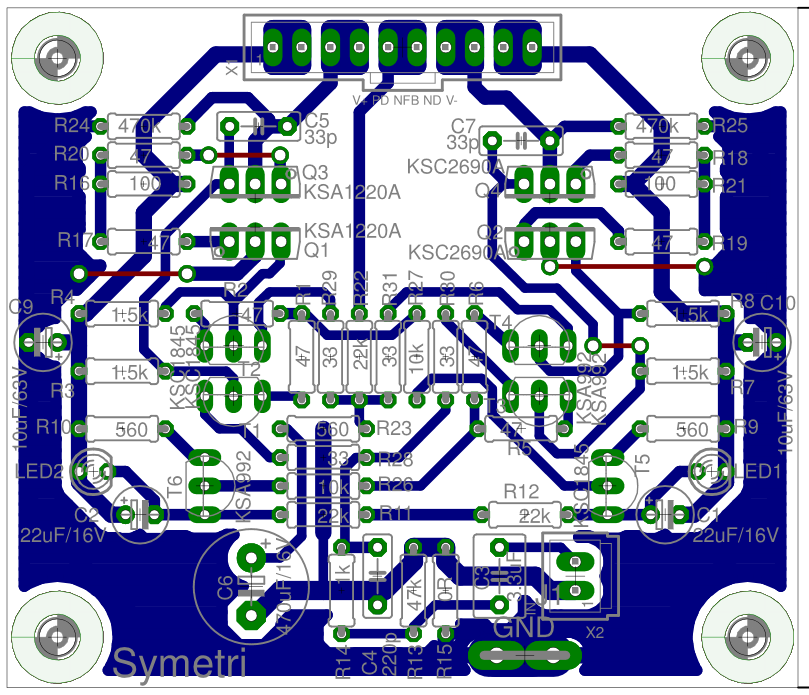

I am taking few days off but after that I will try to solder the symetri IPS, it is very simple and I like simple stuff, they are allways good.
bimo
Thanks a lot !!. Write down what kind of measurements U need and I will do all of them (after my holidays 😀).
Regards

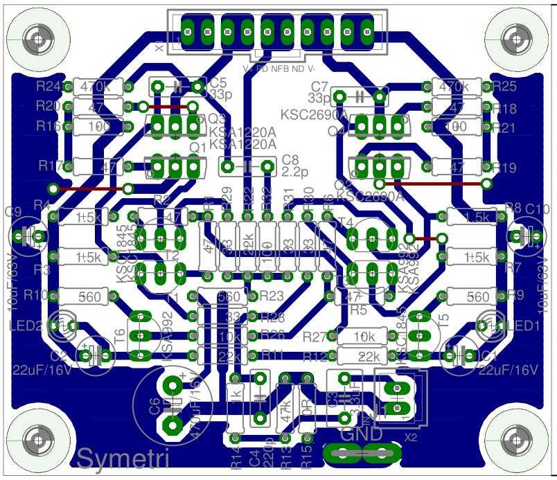

Hi boris,please post Eagle files here.🙂
An alternative pcb is always useful.
Bimo want ARTA measurements,Spectra lab is the same thing.
