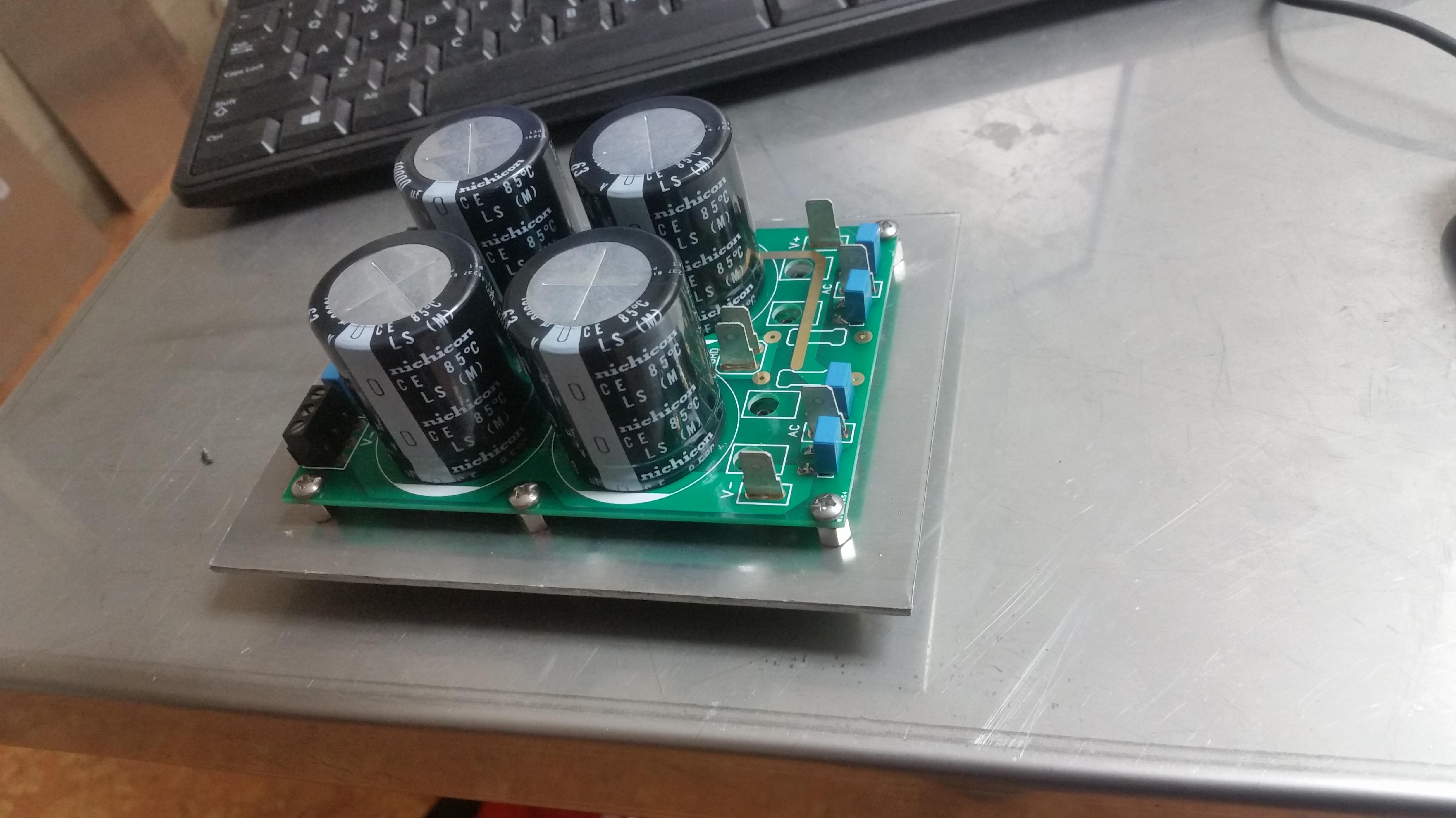

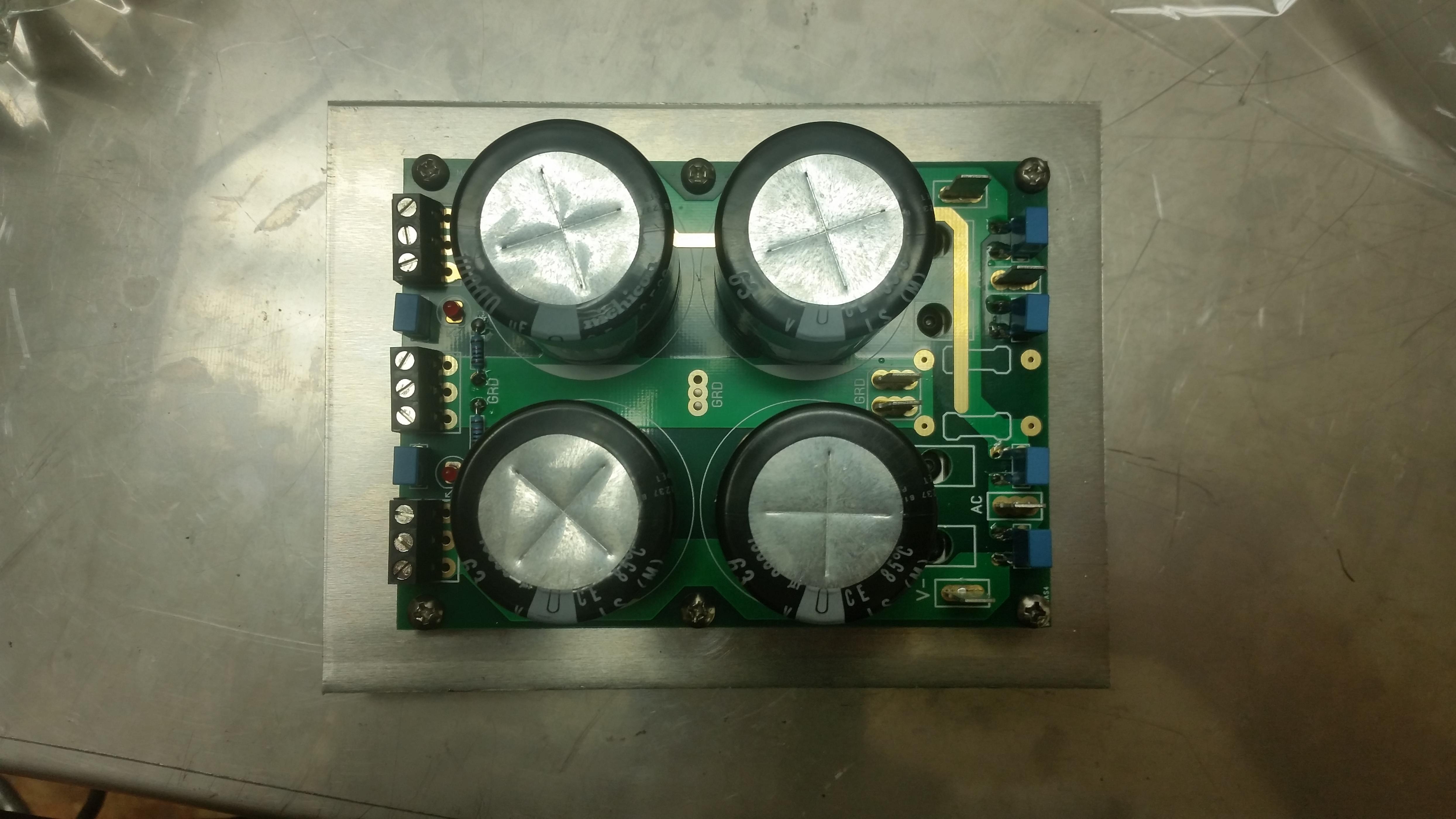

I received my modular supply boards today with some cosmetic malfunctions from the board house.
Was the board house in Lufeng, Guangdong (china meth city) ? 😀😀
What's that orphan trace on the V+ side ?
As long as it goes nowhere - they still look good. (big discount for screwup ?)

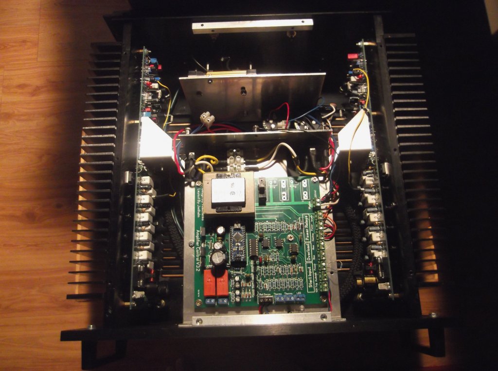

PS - Been playing the jury- rigged slewmaster (below). Dead silent - even with jury
rigged grounds.
rigged grounds.
OS
That trace is just missing solder mask. It's the same on the underside. I need to check the Gerber files and see if something happened there. These boards are so cheap to get made it's not worth the time to haggle over a cosmetically screwed up one though.
Your amp's looking good. It's getting really full inside there.
