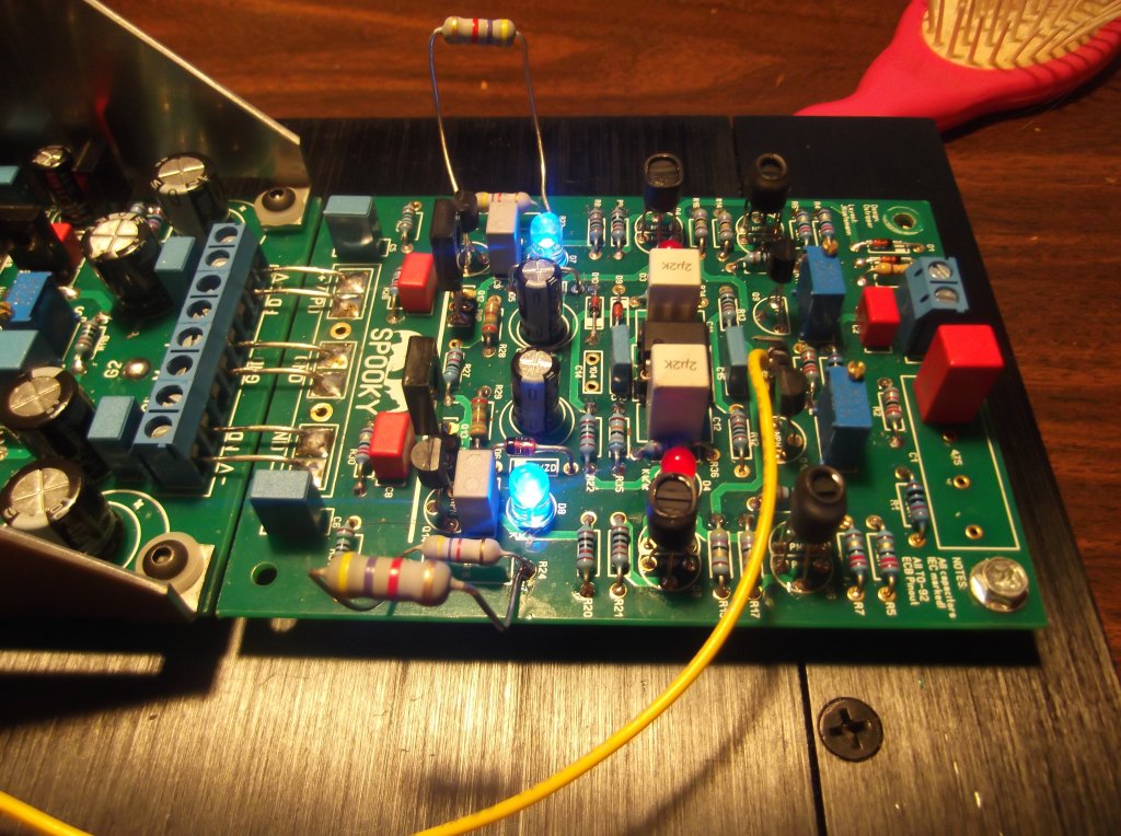

Wolverine works ! (below).
With no pot adjustmants,drivers were 1.25V across the 150R ... offset was .5mv.
Little CCS was 2.4 ma and the VAS CCS was 5.25ma.
VAS has NO heat @ 5.25ma. (do I really need a heatsink ?)
It's nice for VFA's , don't have to test with outputs (2 -1K's to NFB).
Spice estimated 25 and 21mA driver/IPS current draw. Real world is 25 /22ma.
From 10C outside to 25C inside both CCS's and drivers measured the same.
OS

How do you make the feedback circuit operate? Jumper the base to output?
2 - 1k's from each side of the 150R driver resistor -> back to NFB.
Then , adjust driver bias to 1.1V across the 150R. NO chance of a blown output.
Hook a cap /47R in series out to a set of headphones . Amp (IPS) tested.
Just got the spooks running (Below) - thought I messed up (zener resistors) .. lower
voltage = 2K instead of 4.7k.
3.2ma CCS's exactly gets .95V on the VAS Re (6.3ma) ... but minus the 1ma
hawksford led I. .
CCS trimmers are reversed - one CC , one CW to increase current 😱.
Servo settles better if you do this trick. If it comes from the negative side - reduce the
negative CCS a little. Settles in <1 sec.
PS - put these in the freezer , too. within .2ma -10C to 25C
OS

Got all the "bugs" out.
Well ... almost (below). And blew up one of my IPS's. Spooky with no IPS ground = fried TL072 servo. Thats it ! 1845/992's are high voltage , servo is not . All 4 OPS's and 3 IPS's - perfect , easy .... who designed this stuff ?? OS
