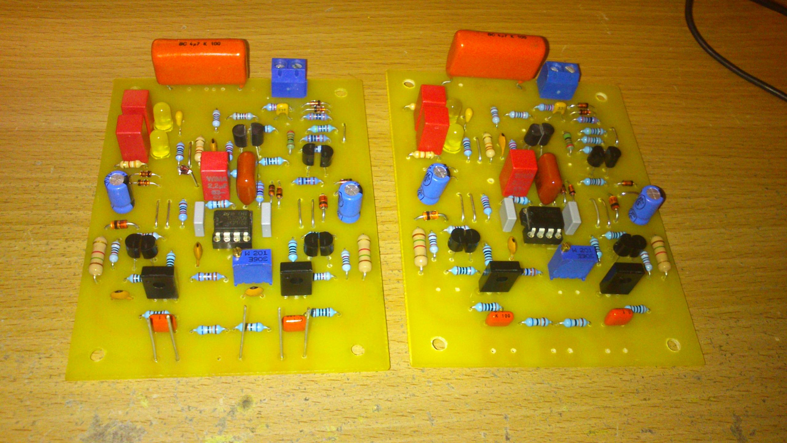

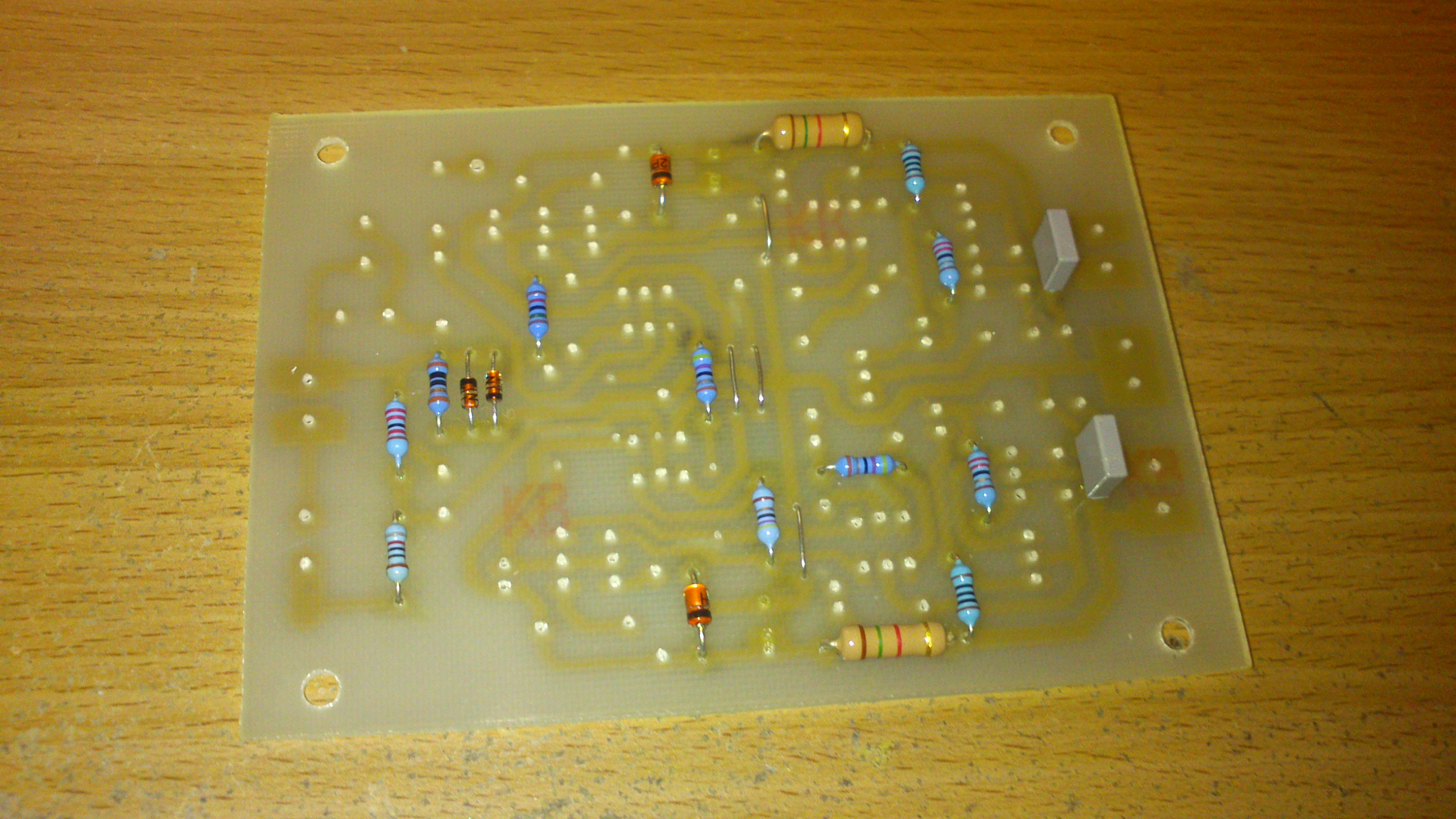

These yellow leds have a voltage drop of 1.84V each so i guess its fine....For R7/R8 i m using 100ohm resistors. Offset is about 20mV (i dont remember whether positive or negative) even even after 15minutes..
Can anyone who has built kypton v check output offset and post?
About sound impressions.. it has very clear highs...like giving more emphasis in frequencies above 3khz but it lacks a bit at low frequencies.i think kypton C is better there...maybe i have made a mistake somewhere...But these are very personal tastes,depending on equipment used,componnents used so they cannot be taken for granded.
531 is quite the beta on the IP.. Increase value on R7/8 to = or >100R.

I checked all parts of kypton-V but i didnt find any mistake.Offset is about -20mV . I replaced TL072 with another one and offset was better at about 9 to 10mV. The sound of this amp (Kypton-V without ) is marvellous!!! Kypton-C sounds like a combination of CFA amp with some tube characteristics,An excellent one!
I'm glad you like the kypton's - show some photo's 🙂 .

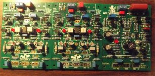

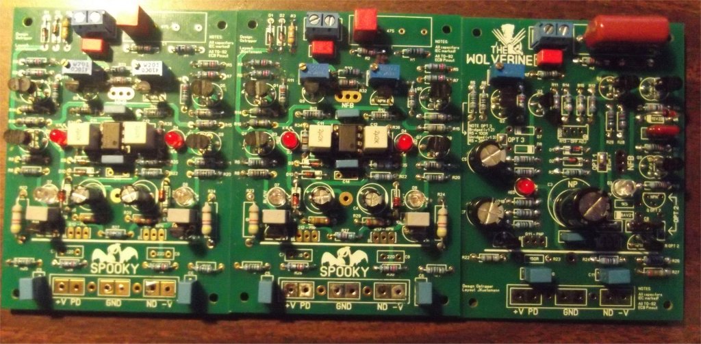

I did notice 2 discrepancies on the spook/wolverine.
Spook comp. capacitors are marked "220" ?? These are actually 22-47pf .
On the wolverine , I might not of "standardized" the 5.5ma VAS current yet ....
(2'nd oldest design). R23/150R would be 120R for a rock solid 5.6ma at the
big CCS. Otherwise , the layout and grounding of these PCB's should really
make for a fast , quiet amp 🙂 .
Also - the wolverine R5 = 150R for the middle adj. (95R) of the 200R
"CCS adj" = 3.6ma . Even as this is going to be a"grunt" amp (SUB) , why
not make it right ?
Edit - wolverine Q10 was changed from the original designs to-126 , no real issue.

The capacitors are IEC marked, as indicated on the board, so 220=22pF (22x10^0) which though it has confused some is not a discrepancy. Only values under 10pF would be directly marked as per IEC guidelines.
Resistor R23 and R25 values are as per the v1.2 / v1.3 schematic without substitution. Q10 was changed to a TO-92 part as there was no need for it to be a TO-126 and doing so made routing just a little easier. That was a pure convenience move and also gave a little more visual symmetry, even though there isn't really anything symmetrical about the design.

I was just worried , some "villagers" (like me) , might plunk big caps in there.
Great for a sub amp , but not for "audiophile".
I adjusted my simulations to the actual boards , all is well. Just the 5.5ma change
to the "wolverine". This will allow for a perfect swap to audition different IPS's.

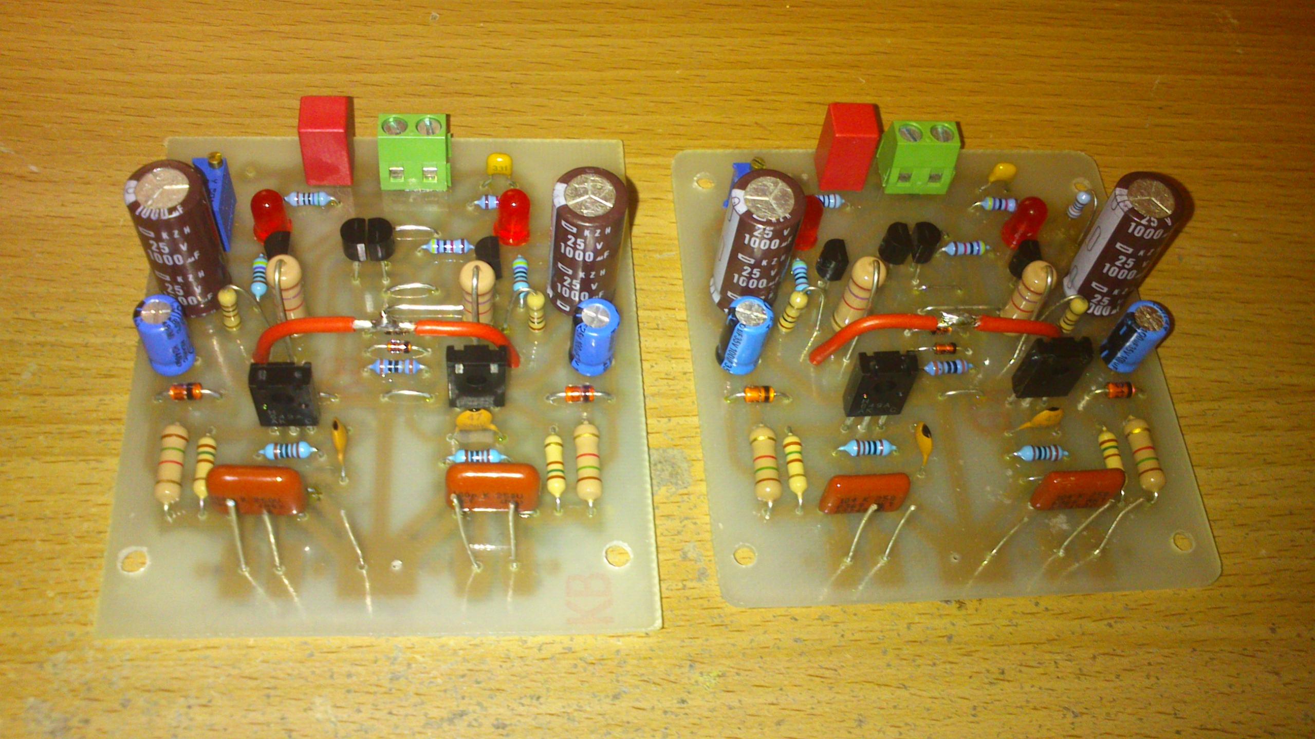

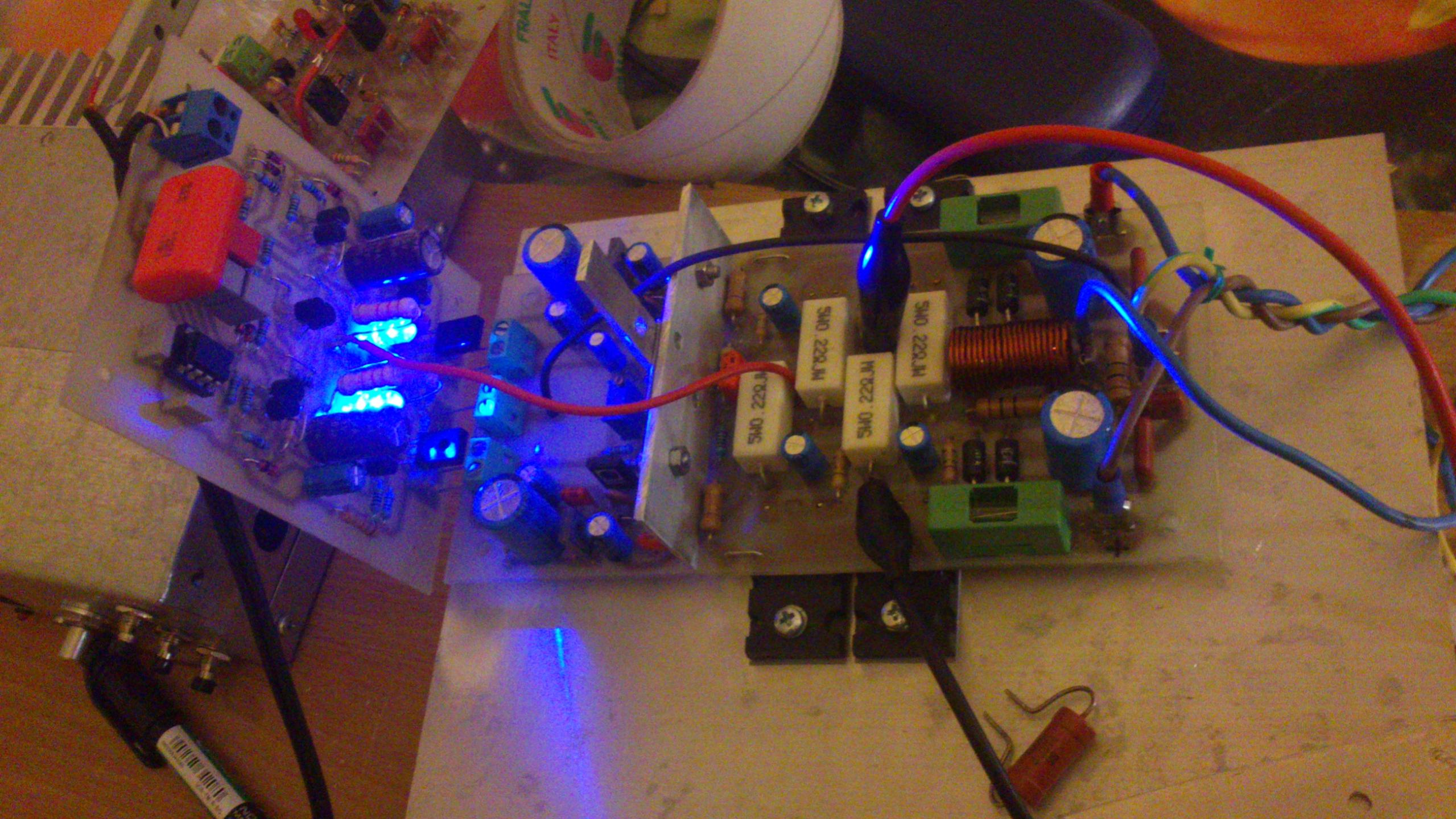

This is all my collection!!! 😀 CFA-X is the one with the red leds,Kypton-C is the one with the blue leds,Kypton V is the one with the yellow leds. I started building Infidel but due to the thermal problem i stopped..
That's some perfect toner work. Greeks are top craftsman ! 😎
You think the Kypton V/C are ready for action - no issues ?
PS - since you have Kypton C - is it better than CFA-X ?

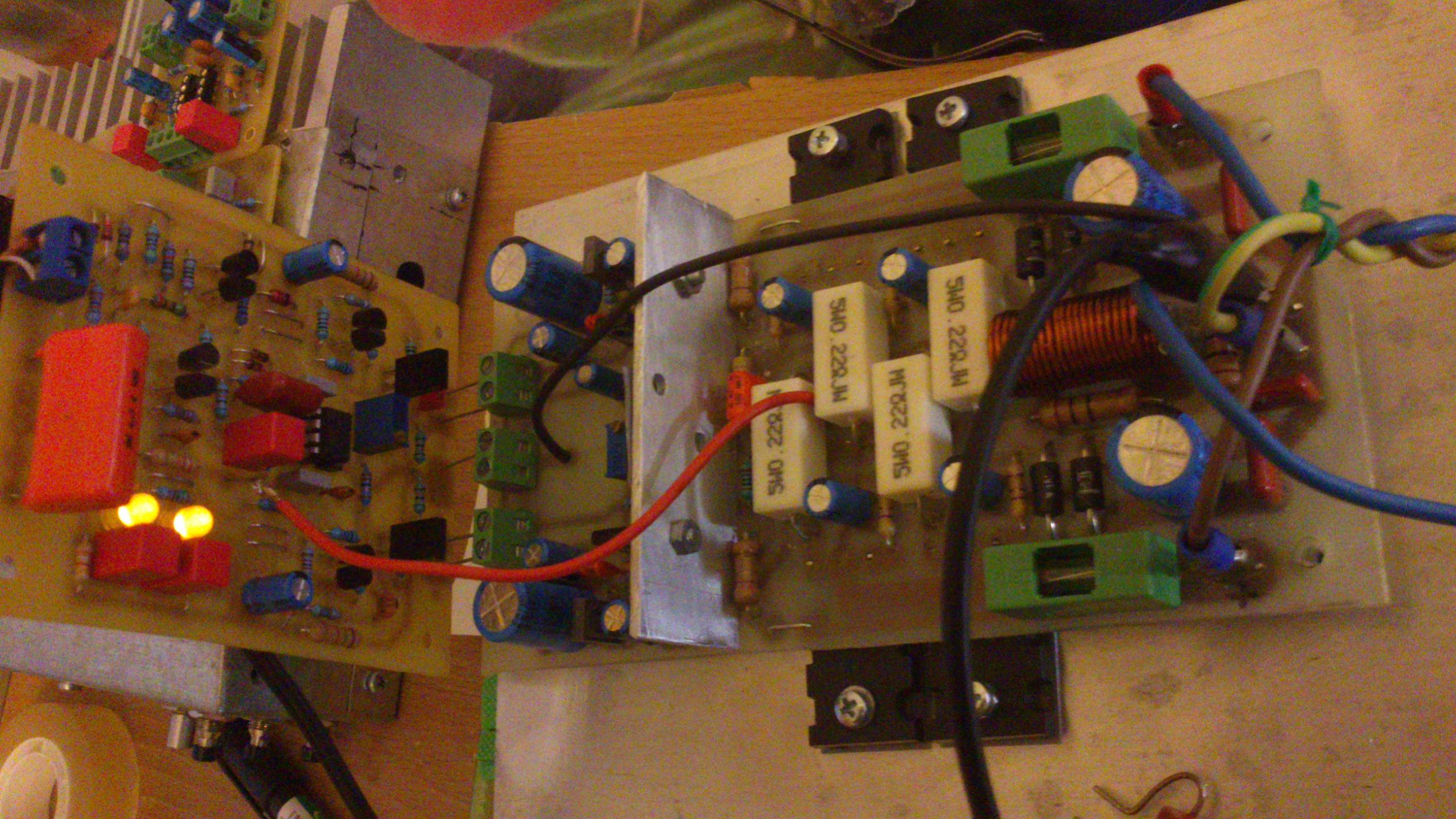

Thank you all for your nice comments. 🙂 I am using +-36V rails,i changed zener diodes to 1.5K/1Watt. In CFA-X I saved one trimmer by replacing it with a fixed resistor. In Kypton C i am using 2.2K/82 for feedback resistors and 47p for compensation.

I dont have an oscilloscope to test and abuse the ips's a bit so i cant tell for sure.Thimios and Terry have made a very good work here! I have been listening all of the three ips for more than half an hour in medium levels and high levels with no problem.
I believe CFA-X and Kypton C are surely ready for action.As far as Kypton V goes, i m concerned about the compensation scheme and the stability margins it gives. i would aim at a gain margin of >=20dB and a phase margin of >= 81 degrees.Can you suggest part values to achieve this?
Despite its small amount of parts,CFA-X sounds very good too. Personally ,i prefer Kypton C to CFA-X. Its like a CFA with tubish sound!
