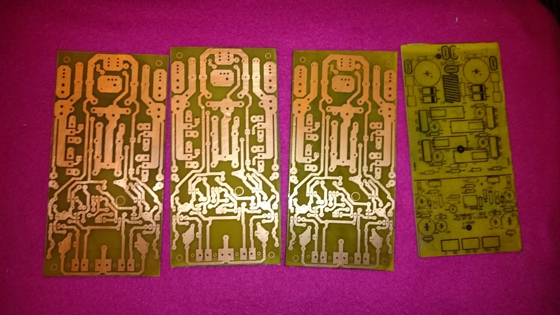

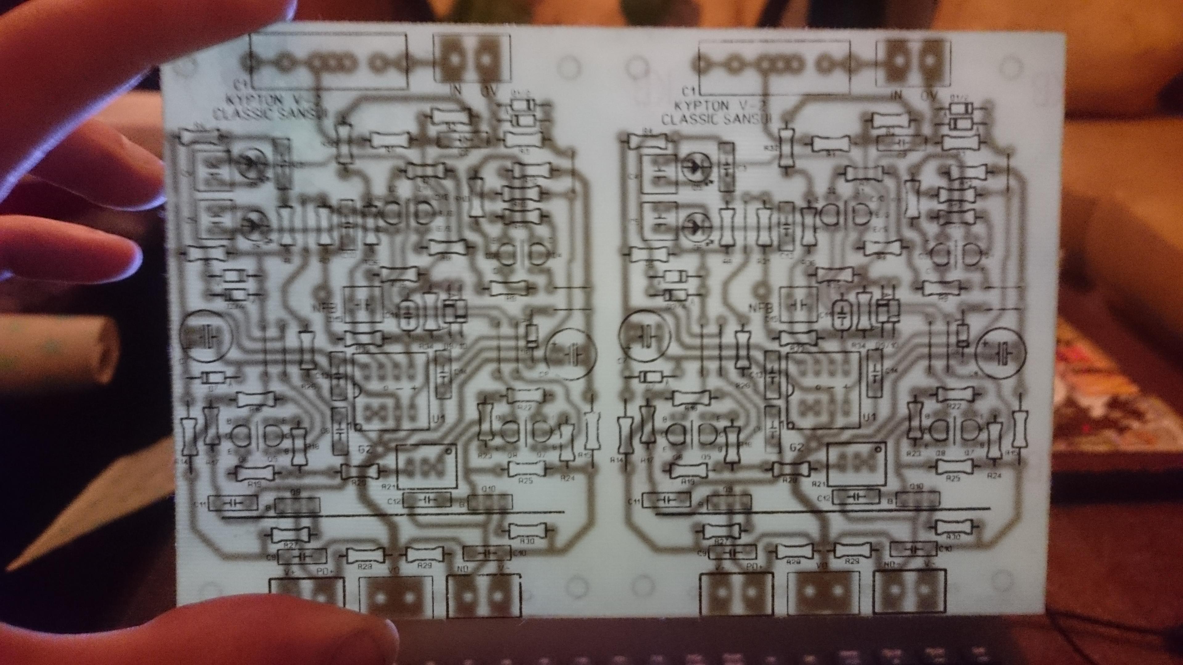

Thanks. I'm very happy with the result. I use a Brother laser printer and rumours say that they can't be used for toner transfer. I had a lot of failed attempts before I ended up using Christmas gift wrapping paper. Combined with lots of pressure and not too high temperature I finally get consistent transfers. 🙂
