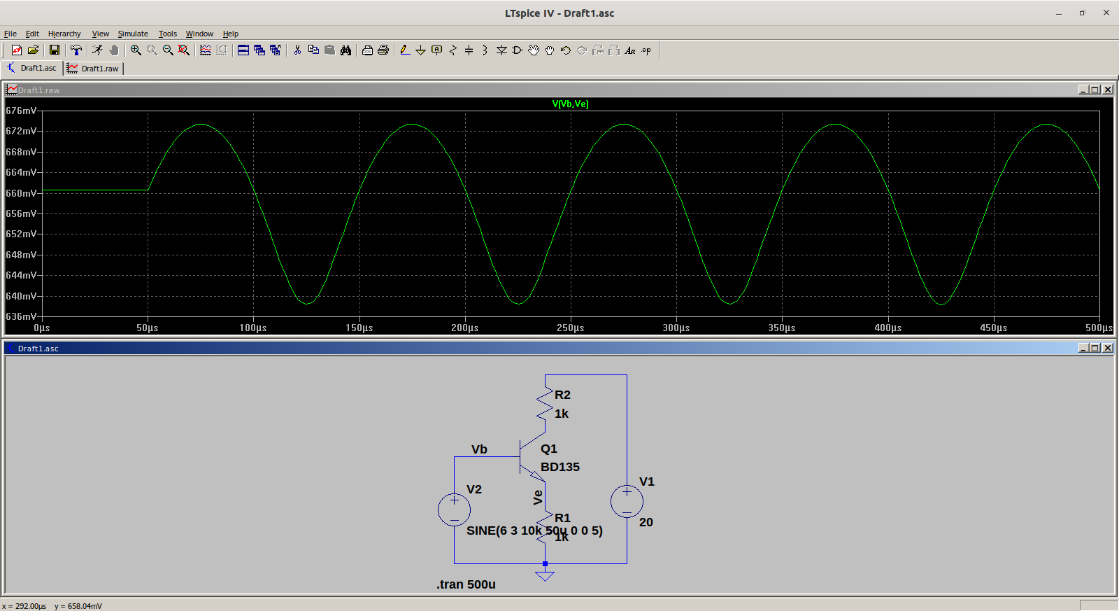

You're right , we should say "precise in time" . Obviously both expressions are related , because it takes speed to be precise.CD goes up to 20kHz. That is not very fast.
The claim that an amp needs to be very fast needs explanation.
For example .
In this simple circuit -with ideal sources-, the signal time is modulate with VBE , no precise in time .
An sinus wave doesn't show the timming errors ,which could occur in a complex signal , where the amplittude could moves in anywhere in the VBE .
Conclusion with this cicuit is impossble to get a free error timming , wherever it is placed.
This is fast? , yes , but not precise .
I hope I have explained .
BR

No, audio is fairly slow. Slew rate limit tells you how fast a voltage can change; it does not know, does not care and does not need to know what this voltage represents. Amplifiers do not see music; they just see a varying voltage. They simply have to ensure that the output voltage is as similar to the input voltage as reasonably possible. That is engineering; all else is alchemy.Ramcres said:Audio amplifier must be fast , but ...... for every tone and overtone - at every frequency simultaneously , at every amplitude , at every load ..etc
SR says nothing about this .
Can be useful for designing puposers , but not for audio qualities .
Am amplifier can drive a tweeter upto about 40KHz.
It can also need to output up to +/- 75 volts for a large power amp.
So that would need to be about 75v/6uS slew rate or 12v/uS.
