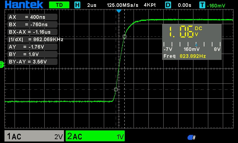

This is actually interesting, if the slew rate of TDA2040 is suppose to be 8V/µs (even the dataseheet doesn't say so for the TDA2040 for some reason). The amp I tested is only fronted with a passive attenuator, which shouldn't affect the slew rate I belive. And for signal I used my Wavetek 182 singal generator, 1 khz square wave. And drove a 4 ohm load, quite hard somewhere before clipping. Measured both "graphic" with my oscilloscope (which I believe gets the most accurate results) and by Douglas Self's method, using a rc link and oscilloscope. Both ways got me the same results.

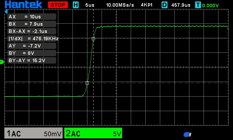

Well, my mistake then. Did the measurement again with 10khz square wave. This time I got 7,2 V/µs, which makes sense. Guess the TDA2040 is working as it should, it's just a crappy amp.

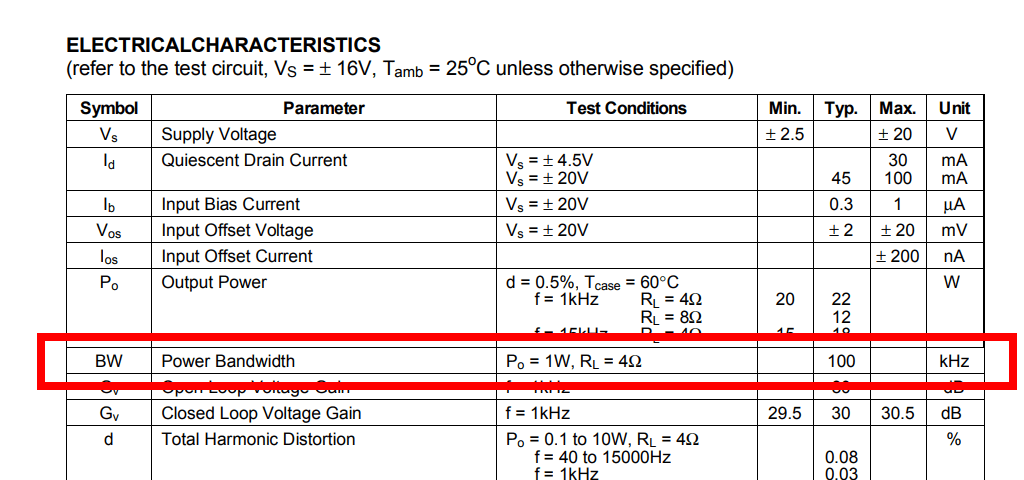

Attempt to find a willing electrical engineer who might help you calculate slew rate from these data found in the datasheet:
  • Full power bandwidth = 100 kHz when driving 1 Watt (RMS) into 4 ohms.
I suspect s/he will find it useful to remember that the derivative of [ A * sin(2*pi*f*t) ] with respect to t , is equal to [ A * 2*pi*f * cos(2*pi*f*t) ]
... which is handy because the thing we call "slew rate" is a measurement of dV/dt

I'm just an marine engineer myself, so I haven't managed to solve this equations yet. Instead I cheated and read Slone's book "High power amplifier construction manual" and there's a simplified formula for bandwidth and slew rate;
Sinusiodal slew rate = 6,28 * f * E(sine pk)
1W RMS into 4 ohm => U = sqrt (1 * 4) = 2V => E=2 * sqrt (2) = 2,82 V
Slew rate = 6,28 * 100 000 * 2,82 = 1 770 096 V/S = 1,8 V/µS
That's a dispointing result. Either the formula is wrong, or maybe the bandwidth specified in the datasheet is reffering to other limitations?

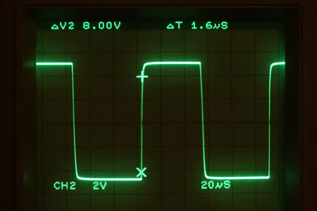

Here's my 10kSq into 4 ohms.
Peak to peak is 10V.
Rise time = 1.6us (10-90%).

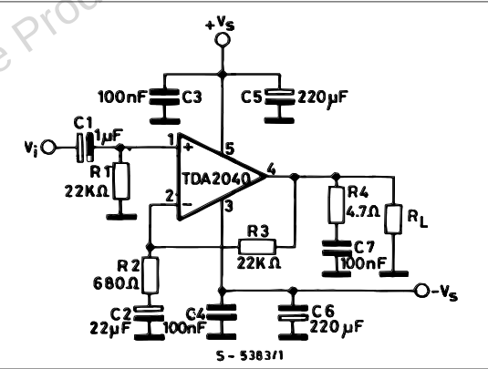

You may want to post your schematic.
It'll be easier to diagnose the issues.

Thanks for sharing your results. The numbers are actually not very far from mine, 8/1,6=5 V/µS.
I built the amp as suggested in the datasheet. And powered it with about +/-15 volts from an unregulated power supply. Not sure that it is any issue with the amp. Maybe it is working as it should. Your results also tells me that the slew rate should be somewere about 8V/µS (as for LM1875, so a bit lower maybe).

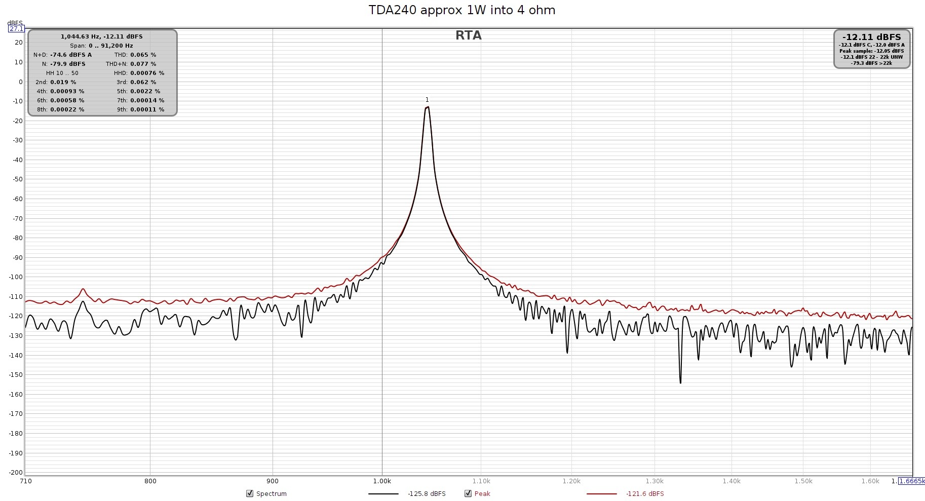

However, I measured the distortion today. At 1 W into 4 ohms load it was around 0,066% THD. Not the best equipment to measure with was used, my signal generator gives me 0,0015 % THD at the moment. But it's mostly 2nd order, the measurement shows mostly 3rd order so it's properly the amp.
The datasheet says 0,5 THD at 25W into 4 ohm. But as you say we usaully listen to the amp at 2 w (or less, small bookshelf speakers). I was pretty convinced then i compared the amp to anohter amp, and thought the TDA2040 sounded worse. And the numbers tells me the same thing.
