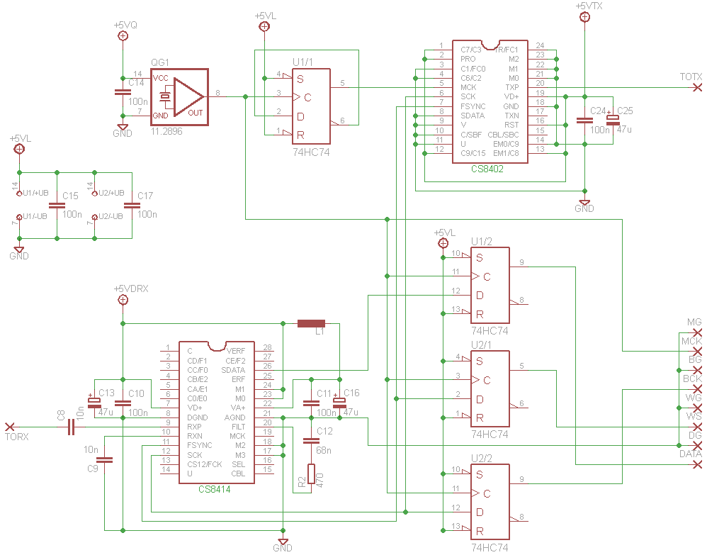

interface bug fixed
I have recently used the interface as visualized in post #1 on this 24 bit DAC based on CS4398 and found a bug in my interface.
The interface works well with a 16 bit DAC based on TDA1543 but with the new 24 bit DAC i get a hugely attenuated analog out.
I fixed the problem using MCK instead of MCK/2 to reclock the BCK, WS and DATA lines.
I attach the schematic with the fix.
Ciao
Andrea

I also did some measures on this new DAC to see the FFT of the Jtest signal in two cases: 1) using the onboard CS8416 as spdif receiver and 2) using my slaving interface bypassing the CS8416.
For now i don't have any good image to show (i did the measures on late night) but i can describe what i remember (i visualized the FFT with 11025Hz on center band and near +/- 4000Hz on each side):
case 1) the noise floor around the center peak near -95db
case 2) the noise floor around the center peak near -110db
This is only preliminary test and i used an inapprapriate software to see the FFT (i cannot change the number of samples nor the window).
I would like to repeat the measures using the hints in this article
http://www.msbtech.com/support/JitterPaper.pdf
to obtain more meaningful results to share.
