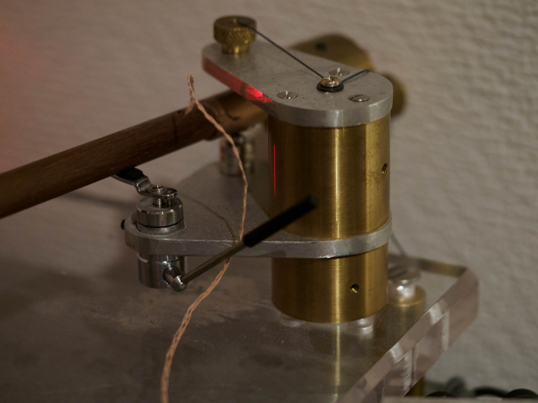

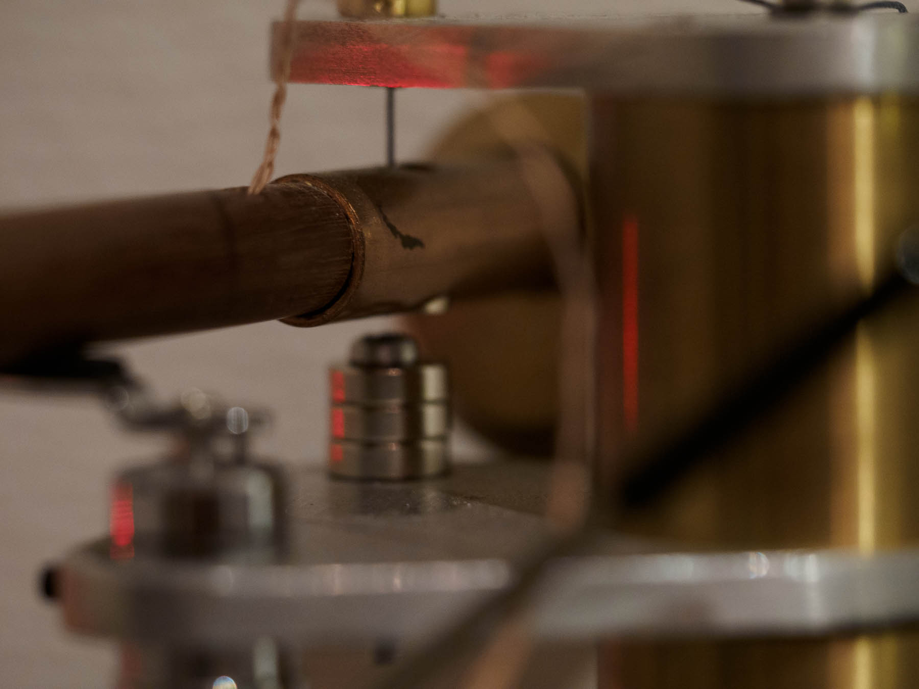

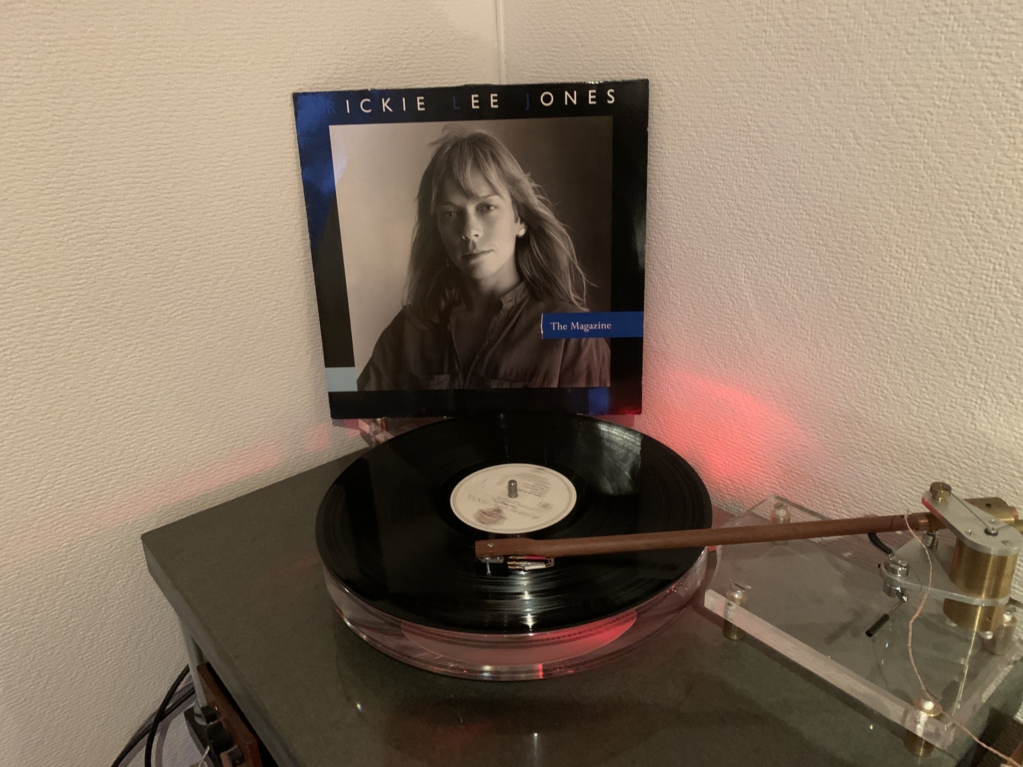

Long time, no see 😳 This project has been frozen too long, but two days ago I could finally spin records with the cocombole/pernambuco (I am not sure what is correct) arm, and it sounds really good. There have been a lot of procrastination in this project, so almost 15 years have passed. In the meantime I have moved three times, and a few years ago, I retired from work.
But the slate turntable have been sitting on top of my rack, with the unfinished arm laying around for years. While I was still in work, I machined the arm in a lathe. Without the lathe, I could never managed to make a hole trough the arm. Then: to solder the ultrathin wires seemed scary to me, but at last I had to.
So here it is, playing records and making me enjoy it a lot 🙂
