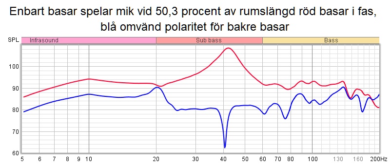

(I have a concrete basement myself, a bit lager than yours. Front superchunks with diagonal 86 x H 220 x D about 60 cm plus 2 rectangular BAD-panels 60 x 200 x 30 cm in the back corners, about 10% open area for the holes. Check out the picture with the red curve for the 2 nd room length mode at room centre. Quite a peak, in spite of the superchunks and thick BAD-panels, -the reason they don’t accomplish much for lower frequencies is due to too little wall coverage. There is no EQ or smoothing applied in the REW-diagram. The good thing though is that the 40 Hz peak can be EQ:ed down, the rest of the bass range is quite even but can also be EQ:ed.)
  • Enbart basar spelar mik vid 50 procent av rumslängd röd basar i fas blå omvänd polaritet för bak.jpg

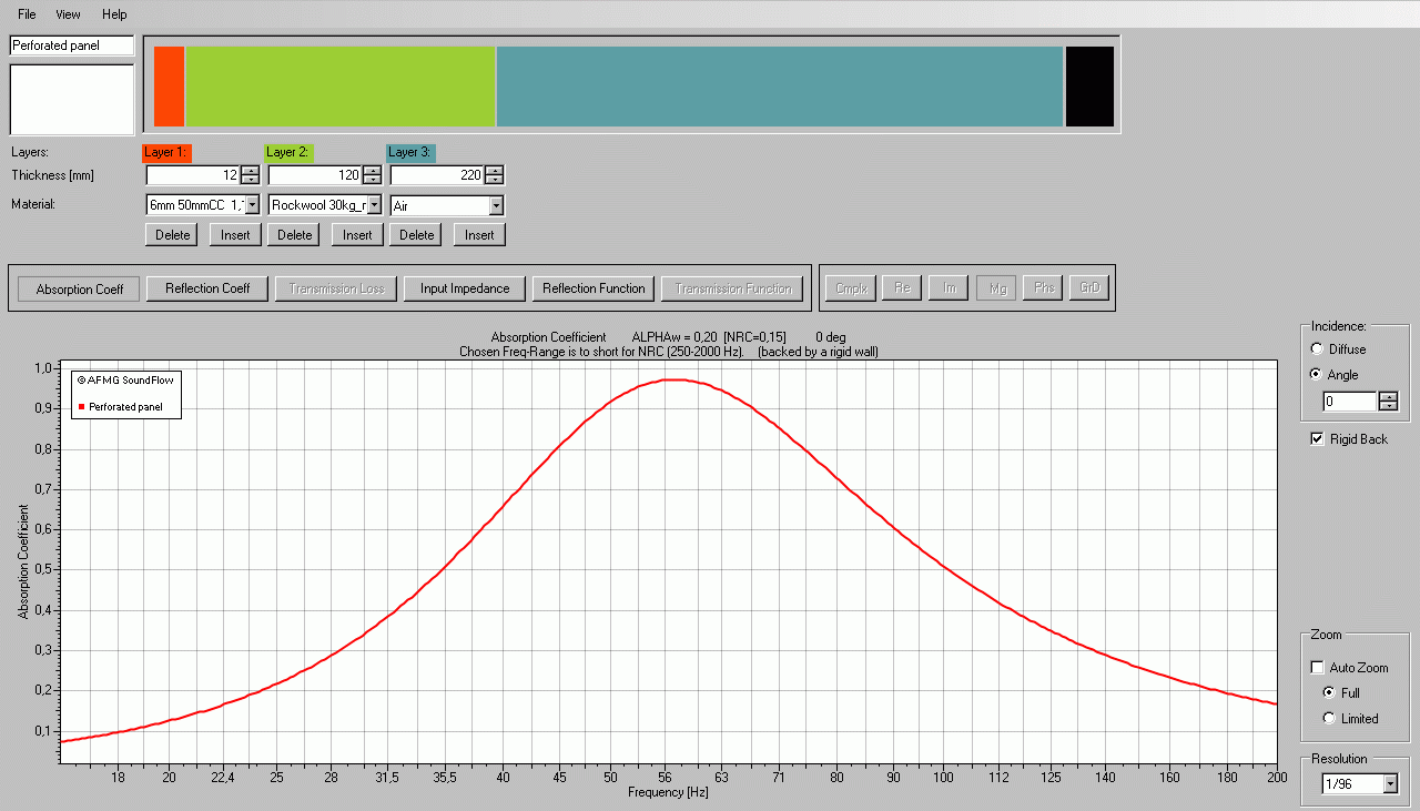

I guess you will have MLP close to room center with a peak of 2nd length mode in the 60:ies. Enclosed are 2 diagrams from AFMG Soundflow for helmholtzes which could be useful in that range if they cover the whole wall and are fully sealed around the perimeters with flexible sealant (leak proof box). Stuffing = Rockwool Flexibatts in both cases, 30 kg/m3, gasflow resistivity around 9 kPa.s/m²
