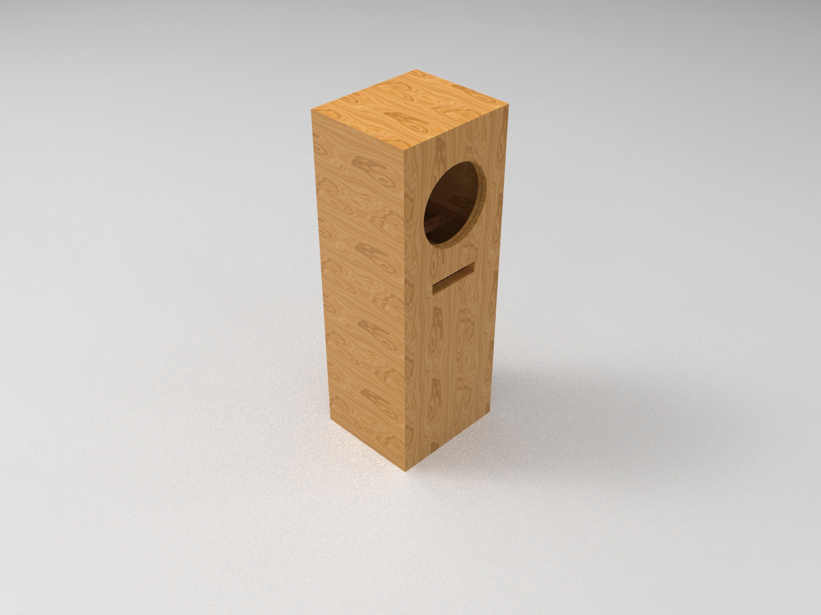

wel, i finished my design (but can't work with cad so no drawing, just numbers). It seems that with using a 174L ported cabinet with a port tuned to low i can get a flat response to 30Hz, as long as i don't go over 20w (otherwise xmax is limiting the response). I'll build that cabinet soon and post it here. My amp will be the ACA amp i recently aquired (8W class A, in mono it's 15W class A). At 98dB sensivity that 9dB gain should be enough for a small living room as i never will listen near that 110dB that a pair would give as theorectical max volume at 8W.

well, i'm soon going to know how much bass these fanes give. I got a pair ready and my design is also fully ready now. I even draw a cad version as this holiday i finally learned how to use a cad software and this is a rendering of how it will be. 174L ported tuned to 30Hz a bit modelled to the style of the Altec 620 cabinet. Sims show that it's possible, but now it's time to get the wood and make some sawdust...

And toppings, that slot is already 20cm wide, 4cm high and 3.8cm deep, tuned to a maximum power of 20w. This cabinet is not ment to be more as xmax limits it's response to that power. But this gives me already 106dB max volume for one cabinet, more than i ever will use. And the amp that will drive it is an ACA (now in stereo, but a second one to run both in mono is planned). so maximum power is 15w and a max output of 105dB
