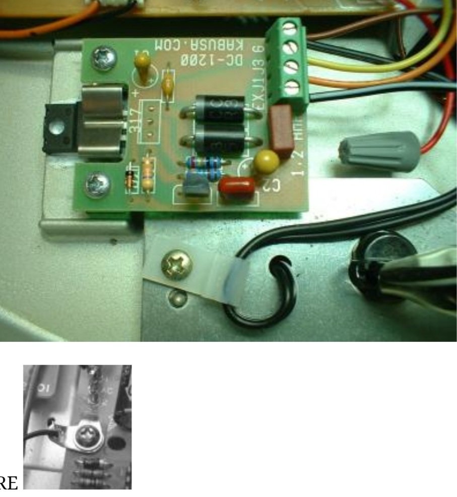

I don't fault the actual circuit design of this reg, but they advocate using a wire nut along with these solderless wire insert terminals, which I believe is just a lousy way to connect something so critical. The ground wire comes pre-installed into the barrier strip, but I should have checked it was tight. KAB even says to verify outout voltage despite also stating that every reg is tested upon assembly - based on the output voltage being off at first, I have a hard time believing that. This little reg costs $50. Thats a somewhat fair price for convenience, but when your selling $5 worth of parts with minimal assembly labor and charge 10 times that much, you should be making sure it works properly and all connections are solid. I did my due diligence first by testing the reg and still had to correct the output voltage.
Unfortunately I was too hasty, wanting to test the main board out before final assembly, so when I fired it up with the platter in place (to be safe), it almost immediately went into the washing machine of death mode, with the platter turning randomly forwards and backwards. This almost always means the AN6680 is toast, but the AN6675 got scorching hot just in the few seconds the power was applied. These are unforgiving ICs to over-voltage and frequently fail when the internal reg circuit develops intermittent solder joints over the years, especially Q201 - this transistor runs very hot and should be heat sinked.
Why they would cater to people who didn't know basic soldering skills for such a delicate application is beyond me. I would think anyone who tears into their expensive vintage Technics 1200 should know how to do basic soldering work.
This pic below is from the KAB site, showing the ground connection with wire nut.. absolute fail IMO. Again, not knocking the circuit design, just the solderless terminals and wire nut for the CRITICAL ground connection.

@Dave Cawley Well this last picture is from KAB's site, not from my install. Note the wire going through the hole without a grommet. Thats really sloppy..
Yes, there's no ground connected in that picture to the motor PCB. That's a bad thing on a linear reg, with the adjustment pin floating open in the air without a ground to reference. That makes the reg output V go high, close to the input V minus the reg dropout voltage.

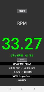

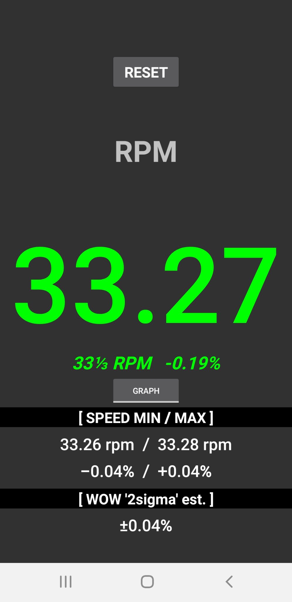

However, testing W/F revealed it to be over 0.1% RMS, so about 0.12% peak. So then I removed the motor armature and installed another one. Using the spindle to center the whole thing, it was reinstalled and W/F tested to be around 0.04% peak. That's an excellent figure and it can be reduced even more with some careful centering of the magnet asy.

@alujoe2 Its sort of a double edge sword with powering the 1200s motor. Less voltage on the AN6675 will help alot, but that reduces transient response of the drive output.
The RC filter zobels on the drive coils are designed to reduce EMF. They're sized to soften the leading edge of each drive pulse by reducing the resonant Q formed by the armature coils. The pulses can be further softened to improve flutter and cogging, but they're already on the edge of being too soft.
The cogging on 1200s isn't remotely as bad as people tend to make it sound. Thats mainly due to the fact that the motor has a 3 phase drive, plus the drive reference FB frequency is 50 kHz, far outside the range of human hearing. The platter mass will smooth out any residual peaks of drive pulses.
Further reducing drive current to the motor coils will increase the drive pulse rise time, in return reducing stress on the AN6675. This will reduce motor torque, but thats only a potential issue if the TT is used for heavy DJing.
