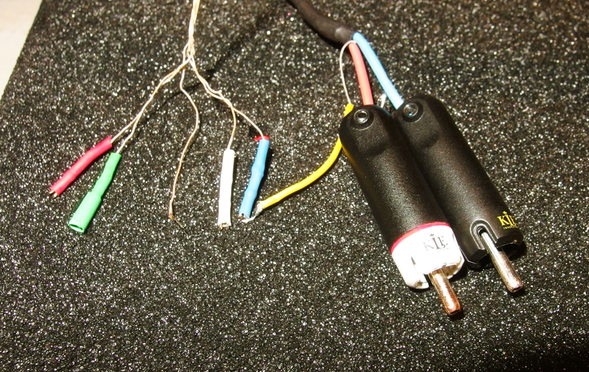

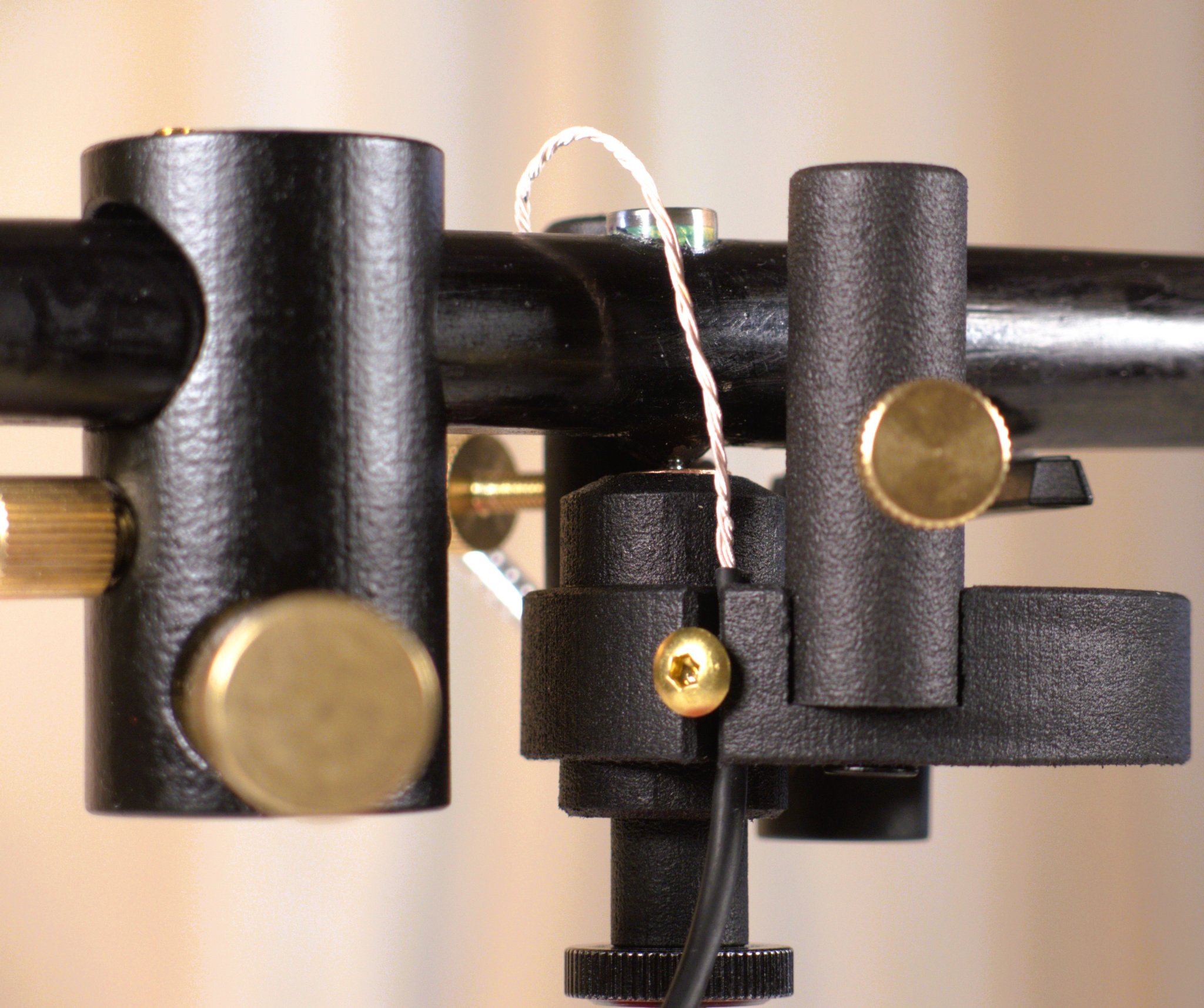

Hy Profiguy, wiring of tonearms is an endless topic. My personal experience is that "mechanics" are equally important as the wire metal. In my tonearm concept www.sambuco.net I twisted and glued the isolated wires together to make them physically and electrically "stable". Any movement of a wire (and there is a lot of vibration in a tonearm) changes its capacity and (little) resistance. Good luck!

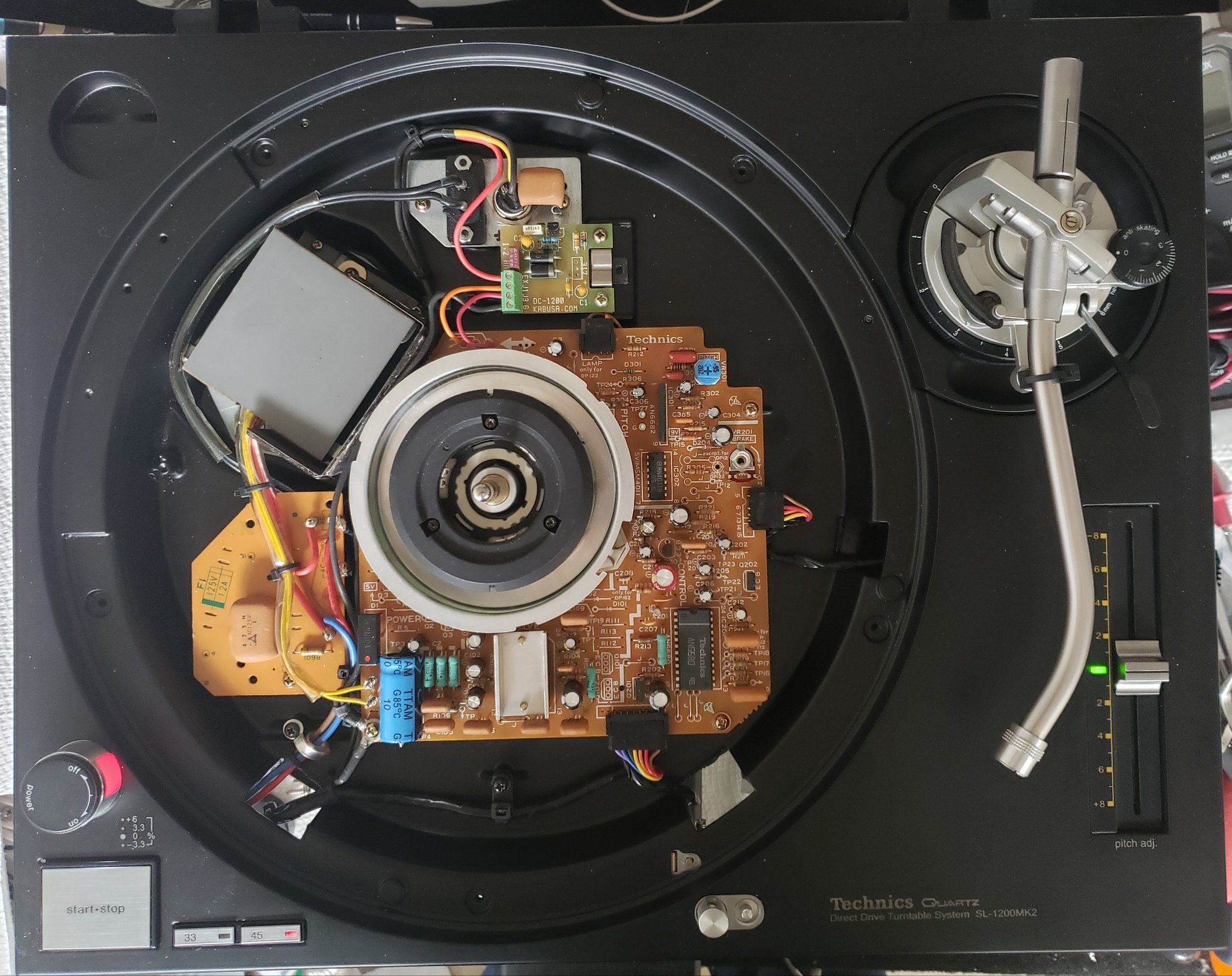

I ended up using the Magnesium arm instead of the titanium one. The Mg arm has a cleaner top end than any other material on this Technics arm. I also didn't dampen it internally. The last time I did so, it completely gutted the midrange detail and air in the treble. It may be needed on the stock aluminum arm tube, but even then it just dulls the HF response too heavily.
I have the top end all done with the arm in place and the drive PCB running off both internal and external supplies as options.
The external PS performs very well using that Mean Wel 50W SMPS. The supply doesn't even get warm in the sealed enclosure, which pulls and radiates any residual heat.
I really like the silver tone arm contrasting with the black base. It looks a bit more higher end this way instead of being all black.
