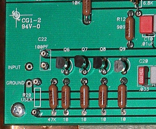

I finally got around to rewiring my tonearm last night. Took a bit of fiddling around to pull the wires through, but it all worked out. I haven't had time to listen yet - it was 11p by the time I was done and everyone was in bed. The overall capacitance measure of the new tonearm + cable is significantly lower than the original:
Original measures were 350+pF per channel and now both measure about 57pF (no cartridge installed).
I used the KAB SuperFlex Litz wire and a 1m set of BlueJeans cables for the external run. The BlueJeans wires are SO MUCH thicker than the originals, that the metal plate that goes on the bottom of the tone arm assembly no longer fits back into place. I thought about cutting it to make it fit, but there won't be much of the plate left after doing so. Its thickness and composition make me think it adds both structural support to the tonearm mechanism as well as providing some shielding, though...
I was able to stuff three of the cotton pads into the cartridge end of the tonearm. I didn't bother removing the other end of the arm wand. Is there any additional benefit to gain by adding some shrink wrap to the outside of the arm or will this change the mass/compliance matching too much?
I'll give it a spin tonight to see what the results are.

Right now, the input resistor (R20) and capacitor (C22) spots on my Pearle2 are both empty (I soldered in little sockets for easy adjustment), so 57pF is the total capacitance. With a recommended loading of 100-200pF, there is room to play around with different values that I have on hand. Little by little.

After living with the tonearm rewire and new RCA cables for a few weeks, the difference is just amazing! At first, I left C22 (cartridge loading) empty, so total system capacitance dropped from about 360pF to about 50pF. This was quite a change and my first reaction was "what happened to all of my treble?!?"
After letting my ears adjust for a little while, I realized what I had gotten used to was overly bright treble. The presentation, though, sounded a bit too dull for my tastes. After a week or two, I added 56pF in the C22 spot. This sounded better, but was lacking a pinch of sparkle at the top that I like. Another few weeks in and I am now running with 82pF in C22, for a total cartridge loading of about 125pF.
This sounds much better to me at this point and I am willing to leave it alone now.
