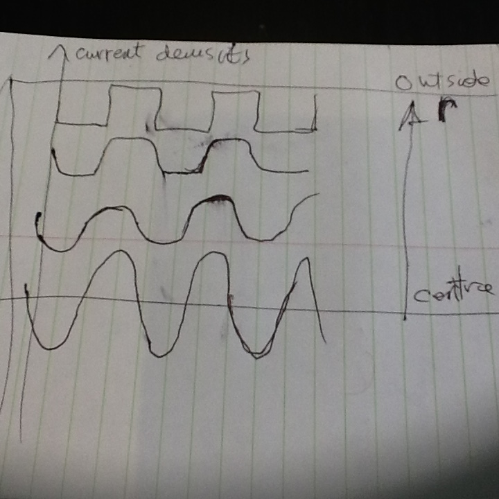

My take on skin depth. Quick (very) drawing of current densities for a square wave, many harmonics, from skin effect. Like decreasing the freq. of a low pass filter as you get closer to the center. And makes no difference for audIo.

It is a reasonable assumption.My take on skin depth. Quick (very) drawing of current densities for a square wave, many harmonics, from skin effect. Like decreasing the freq. of a low pass filter as you get closer to the center. And makes no difference for audIo.
The only place I can think is different, if the entire wire is engaged in the bottom frequency, then the current density at the surface cannot have a pure square wave current vs time as not all the lf current is there.. My take would be the density at the surface might look more high pass.
Course, since I can no longer do that math, and cannot think of any possible way of measuring it, I'm happy to just wave my hands about...
jn
If you think of the wire cross section as that wiki page depicted, note the currents in the conductor that are circulating from outer to inner as a torus.
Those currents are internal local currents that are created by the rate of change of magnetic field in the wire generated by the axial currents. When the total axial current is rising very fast, those toroidal currents will subtract in the center, add at the edge. The overall current profile is supressed at the core, enhanced at the edge, and gives the current profile we identify as skinning.
At any point in time, the current profile is dependent on how fast it changes, and what direction it is changing to with respect to the total current.
