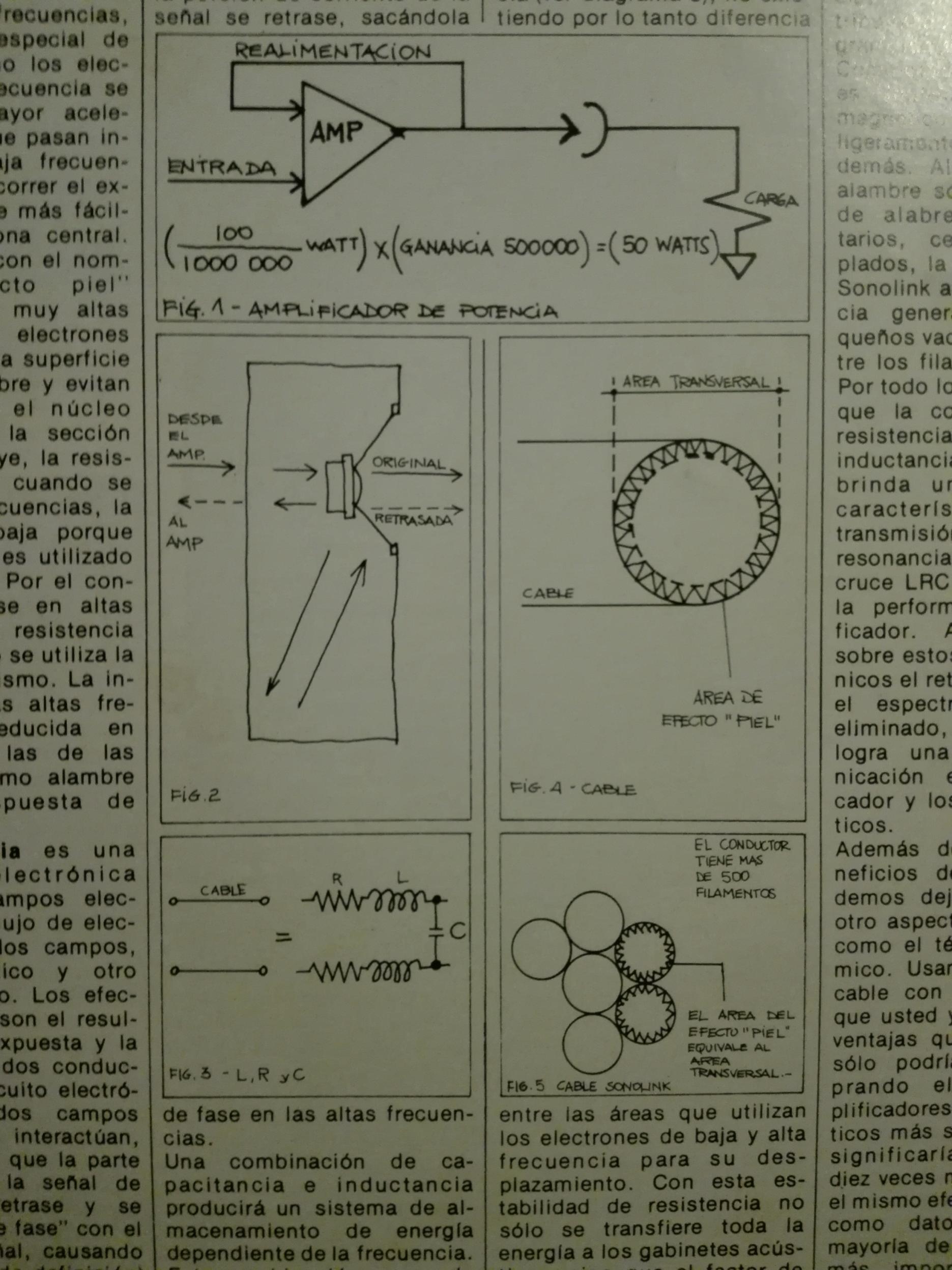

Year 1982, explanation of the skin effect, the cable is 500 threads, we manufacture it here, it is still in use in my system. I participated in the marketing and sale of it.
Personally I will decline the experiment of wrapping it in VHS tape of CRO2, is that you have to switch the signal to mono, locate the speakers in the center of the room and as close together as possible, etc ...
Good luck to anyone who tries and please report the results. I am intrigued ! 😉
