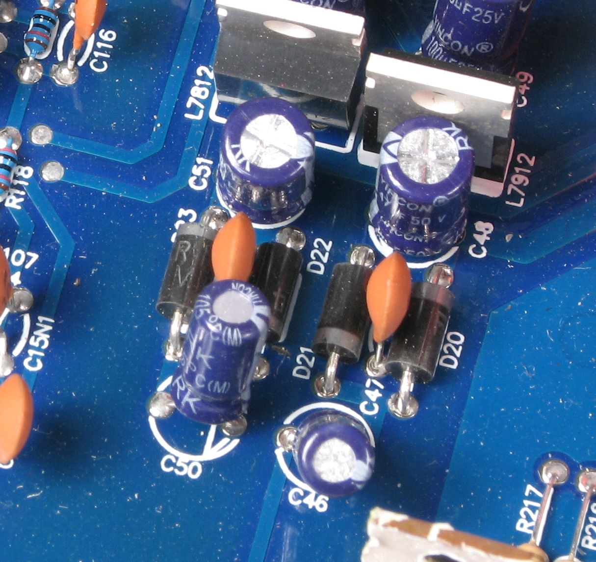

Skar Audio T1400.1 protection light flashes fast on/off?
It's best if you don't refer to anything as 'rails' except for power supply rails. Either the ± rails that feed the output transistors or the low voltage regulated rails that feed the op-amps and such.
Photos save a lot of time and cost nothing.
The hifonics amps that are similar to this one use FR154 diodes to supply voltage to the 12v regulators.
