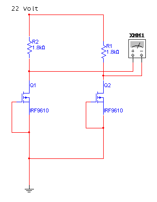

OK, so I have a blown output. An IRFP9240 to be exact. Rather than order another matched quad, I just ordered some IRFP9240 devices which means I will need to match them myself. My question is will using this circuit for the P-channel device work well enough to match them for this amp? I think Nelson suggests a 2k2 for the resistor.
How close in voltage do they need to be to be considered a good match?
Thanks, Terry
Thanks, Terry
I was able to match a pair but now it seems I have a problem with the other 2 as well. they are not shorted but I'm reading about 30R between the source and the gate. Going to have too pull them and see what's up with that. I'll get back to you.
Thanks, Terry
