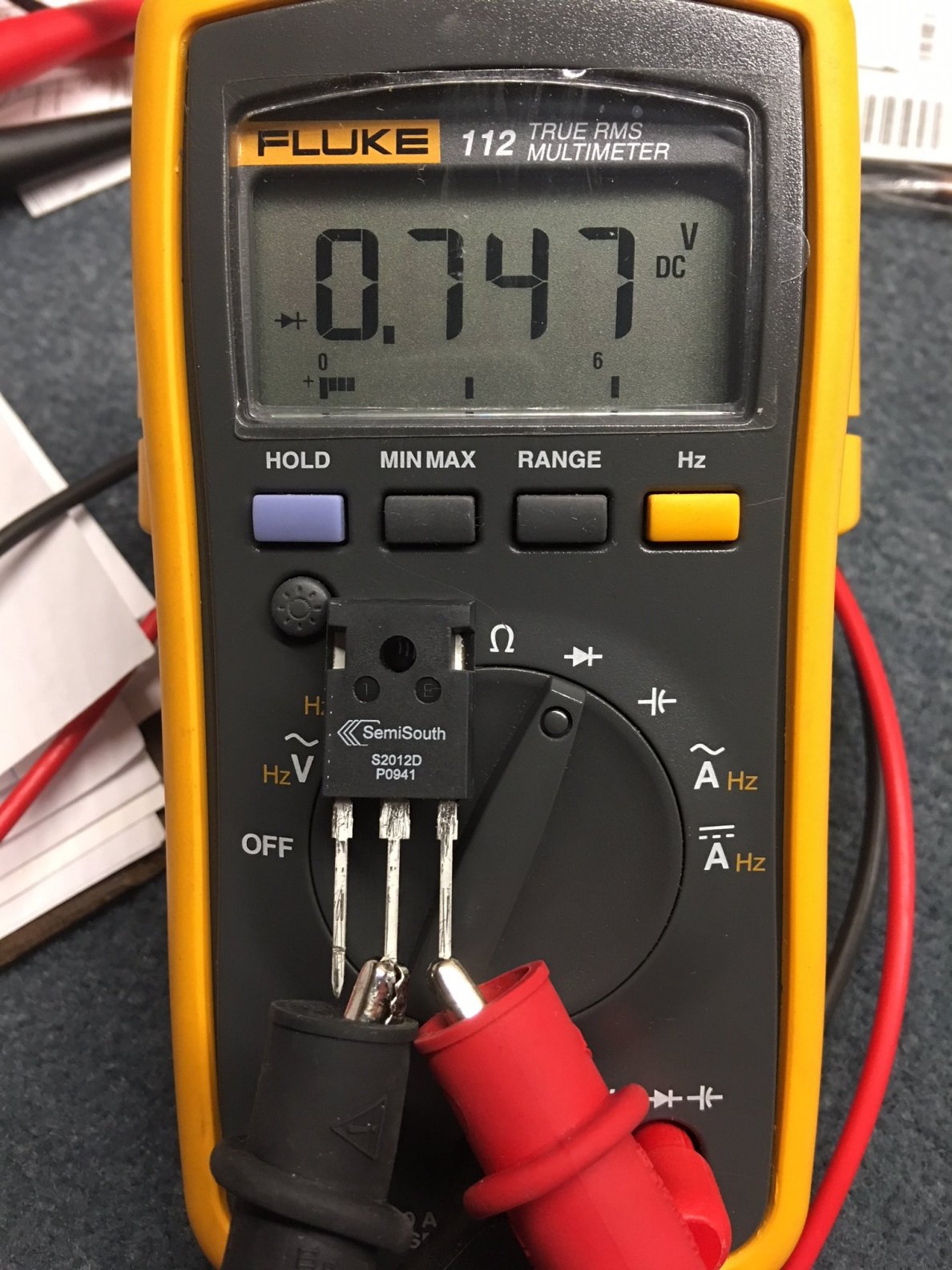

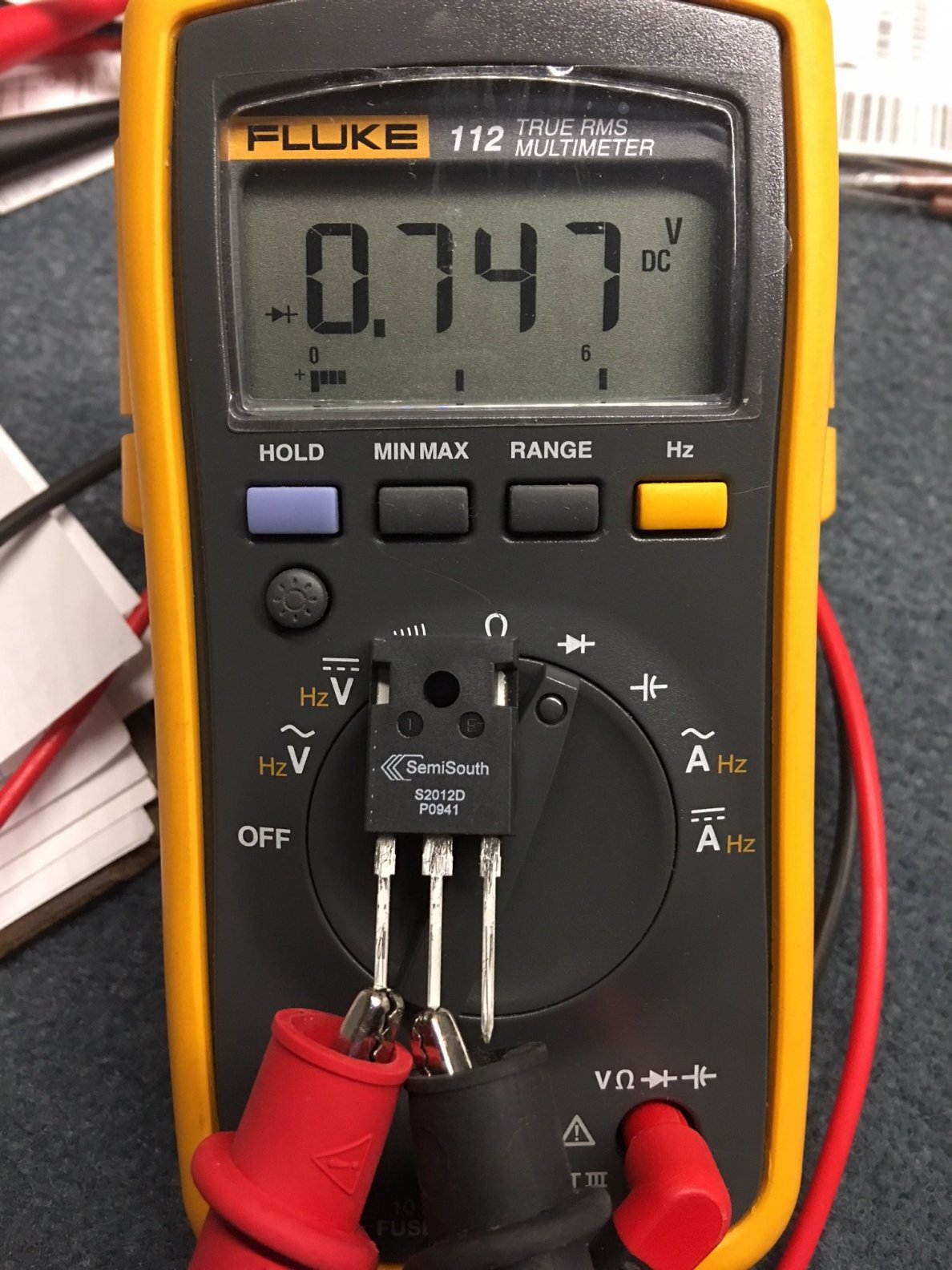

I went through the process of Testing for some "SemiSouth"
that I acquired.
Following the instructions from the inventor I went through
the following steps to test if they were real:
Now that Nelson has confirmed what they actually look like,
from the pic posted above, I know, and now you know what
pics of a fake "SemiSouth" looks like and how to give it
a quick and dirty test with your meter.
Hope this saves some folks from getting burned.
that I acquired.

IJW120R100T1 (and not SJEP120R100) was a SiC JFET by infineon which is already obsolete.
https://eu.mouser.com/ProductDetail/Infineon-Technologies/IJW120R100T1?qs=Du9m/J9cwrKdAsCBEB6txA==
There are still 70 pieces to be had at Mouser, for ~30USD each.
But the interesting thing is that it needs a negative Vgs of -13V for say ~1A bias.
Plug it in a circuit designed for the Semisouth with Vgs ~+1V, you will get a bias of ~110A.
Guarantee to blow the hell out of everything connected.
BTW, this is how the real thing looks like.
Not even close.
Patrick
