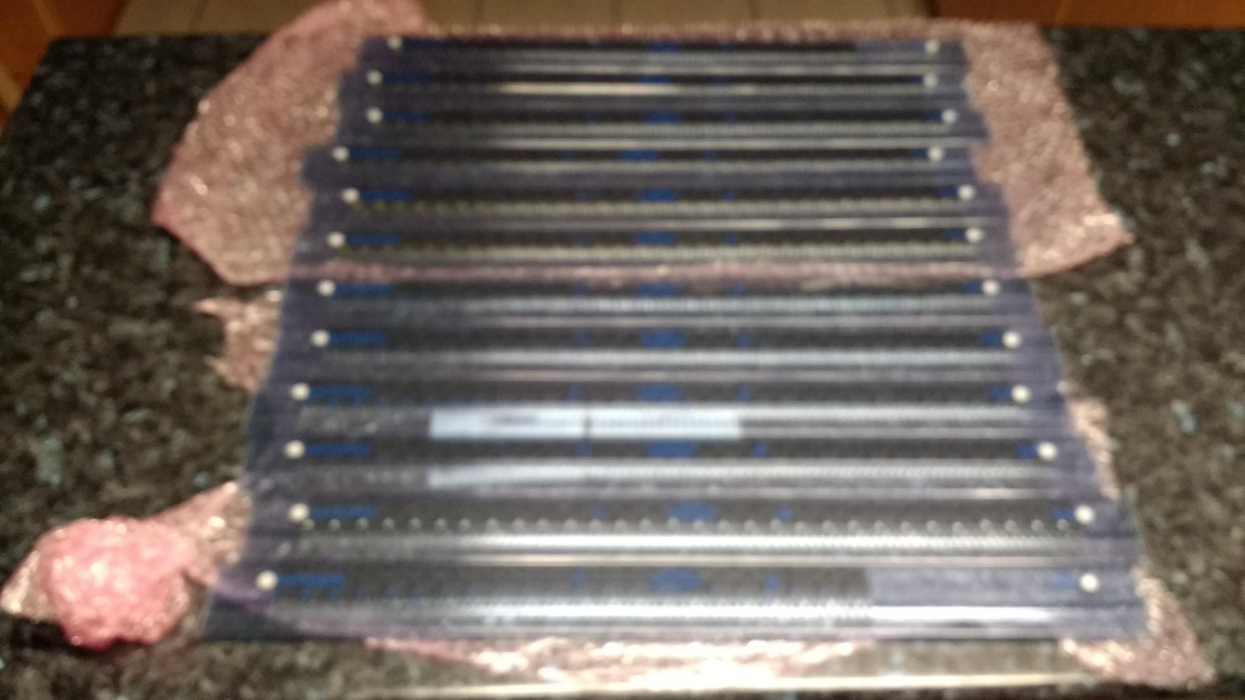

Fets received today , pic not so clear but it gives An idea .
