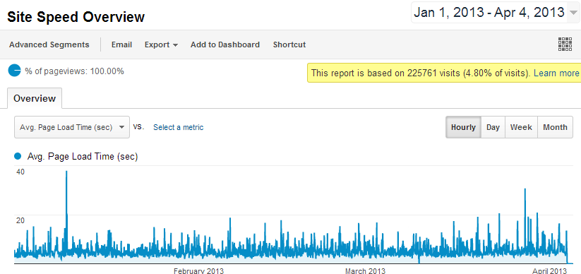

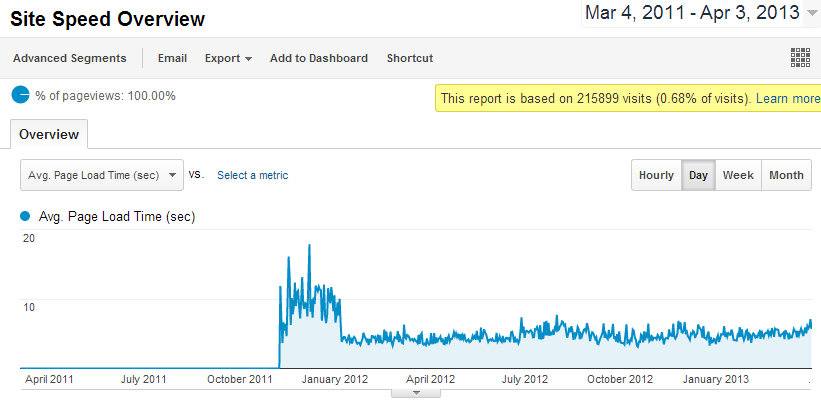

Google Site Speed has reported no major changes in the page speed characteristics of the site recently.
I will see what can be done to get things improved - right now we have a very high Page Speed - 96 / 100, we use Amazon's CDN for all static content, and I don't see too much room for improvement on the current hardware / software combo. I'll do some housekeeping and reboot the machine (it's been up for a year) and see if it blows any cobwebs out of the system.

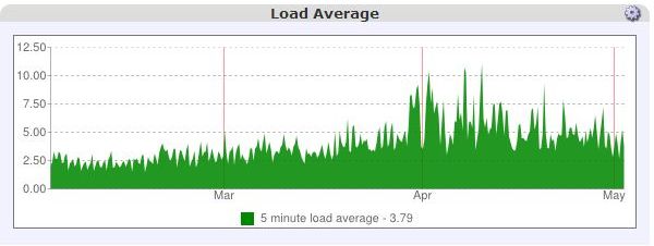

The server is definitely (confirmed) experiencing intermittent slow downs, caused by the CPU usage spiking. One minute it's fine, 5 minutes later it's overwhelmed. It appears to be database related. Over the next week I'll be doing various things to try and find the culprit. Sorry for the inconvenience.
We have been making methodical changes to the server to address the occasional performance issues experienced over the last month. So far progress has been good, server load is now back to levels pre-April, we are continuing to make improvements over time. Thanks for your patience.
(Please note this is a dual quad core server, so server load should always be under 8 to avoid process traffic jams)
