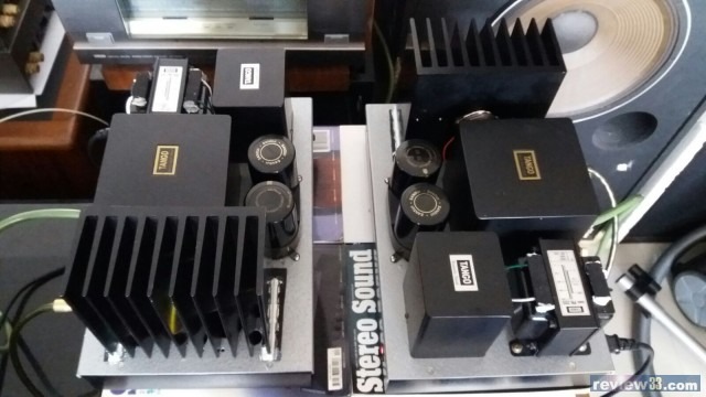

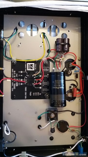

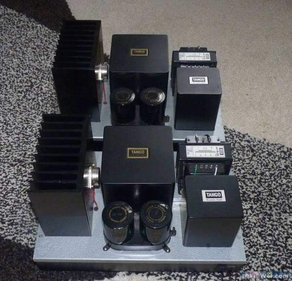

A friend of mine bought a nice diy set of 2sk180 SE amps a few years ago from Japan using Tango FG-50s output transformers (no circuit provided). He said they sounded like his 2A3/300Bs, and better than his Yamaha B-1 in the highs. 😀😁
