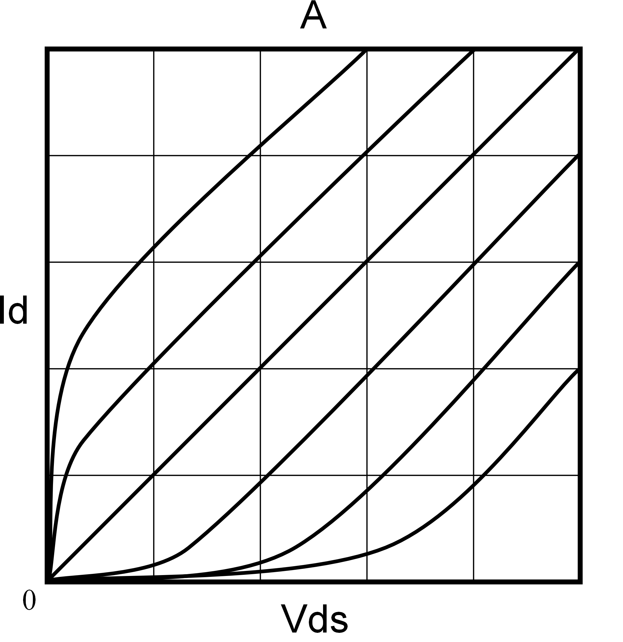

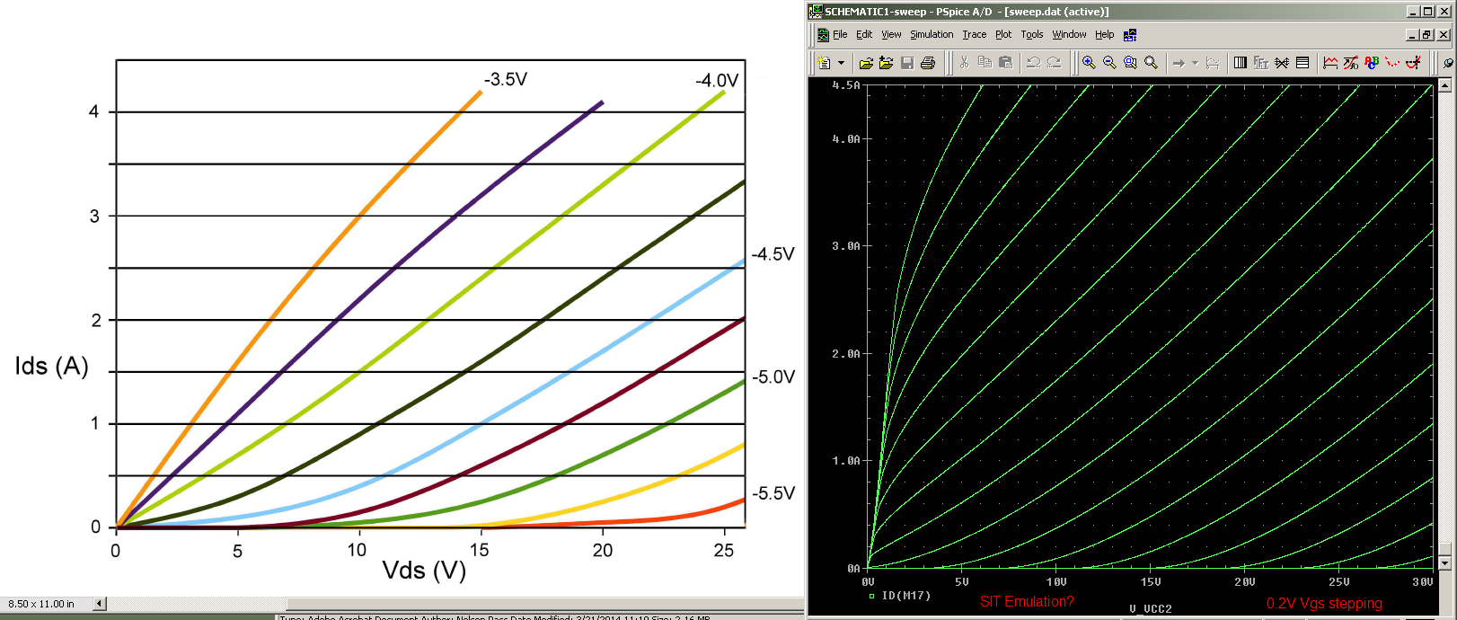

This is getting fairly close I think, and I'm using common parts. ;)
Did someone say "unobtanium"?
Note, these are simulation results, and have not been tested on an actual device. Actual device testing/curve tracing will be performed.
Credits to Michael Rothacher and Nelson Pass for the SIT curves.
