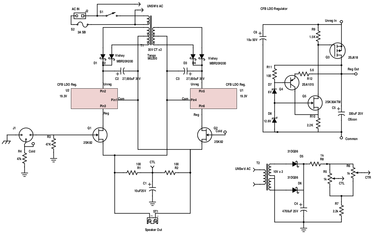

SIT 2SK82 Circlotron Power Buffer
nice project gantez🙂 i like circlotrons too !

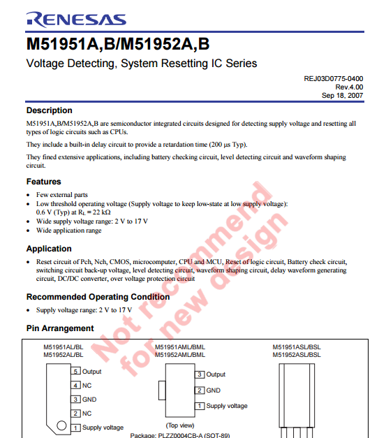

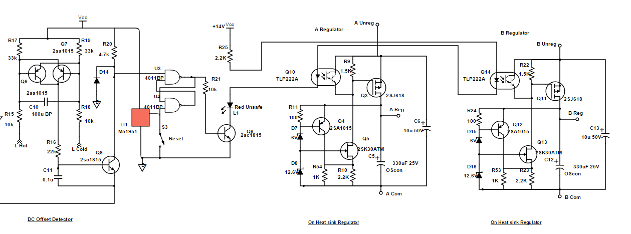

I was looking at your interesting DC protect circuit - what is that block in red M51951 ?
Thank you. Kasey197.
This amp is my first circlotron amp. The sound quality is more than expected. 😀
This is a reset IC. see attached for detail.
